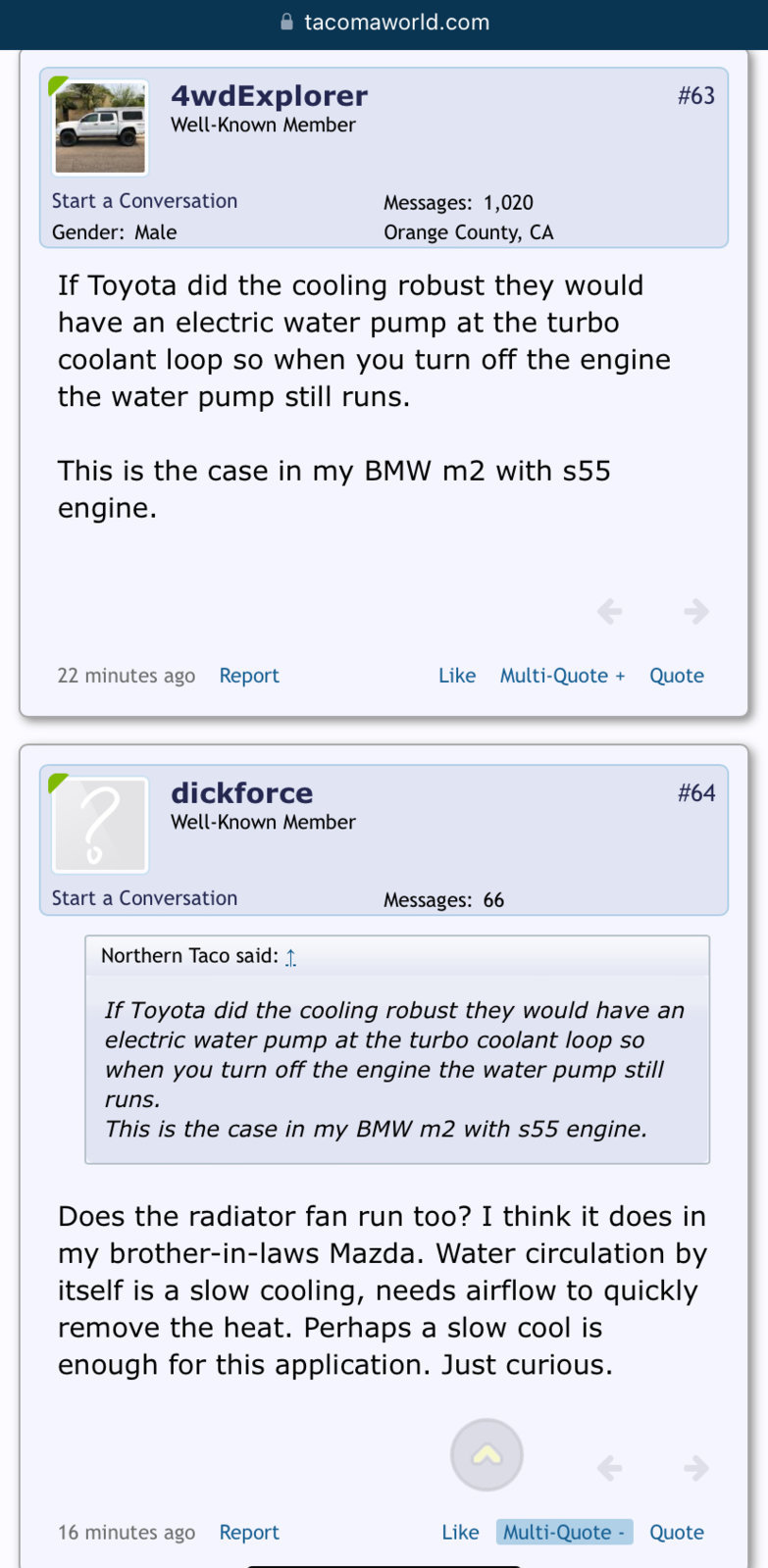

    If Toyota did the cooling robust they would have an electric water pump at the turbo coolant loop so when you turn off the engine the water pump still runs.
    This is the case in my BMW m2 with s55 engine.

    Does the radiator fan run too? I think it does in my brother-in-laws Mazda. Water circulation by itself is a slow cooling, needs airflow to quickly remove the heat. Perhaps a slow cool is enough for this application. Just curious.

    Yes the radiator fan runs as well when the engine turns off and more adequate cooling is needed. Engine has both a mechanical belt driven water pump and an electric pump for the turbo.
    Also has a water to air charge air cooler which is better than your traditional air to air cooler.
