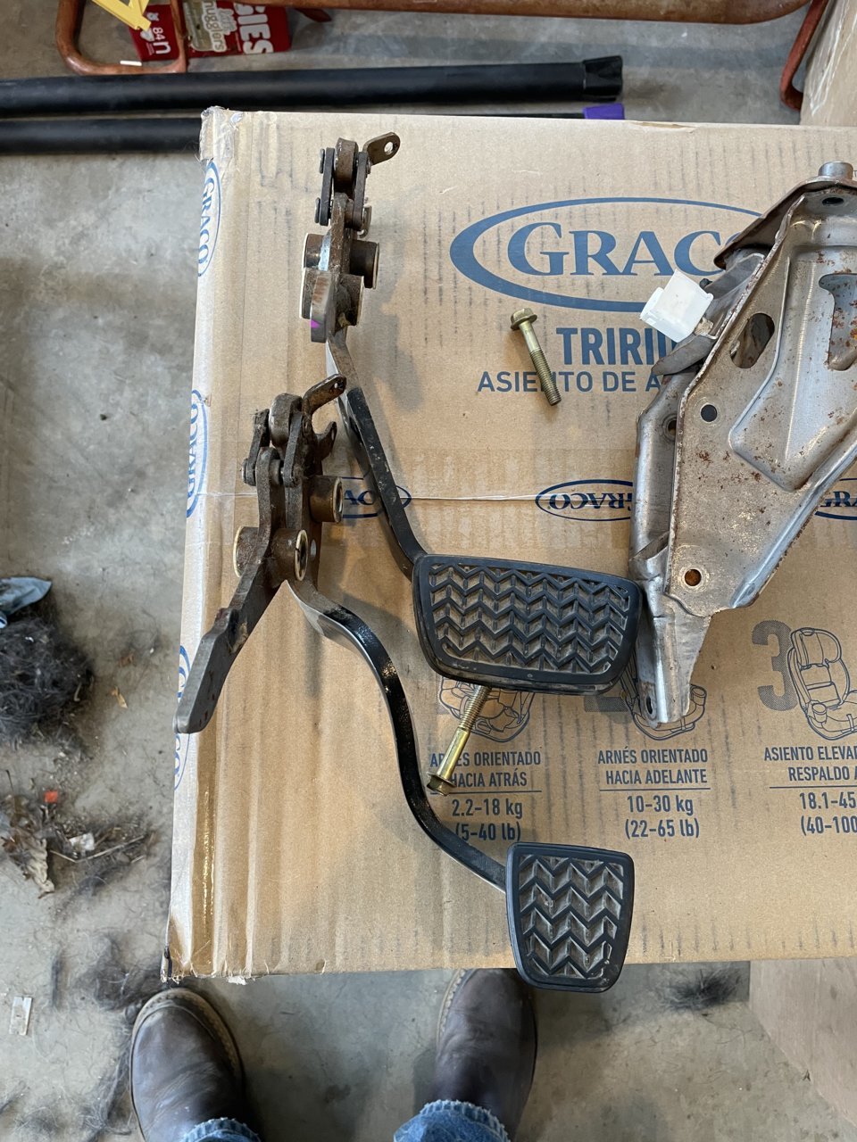

    Brake pedal comparison
    Auto e brake bracket
    Clutch pedal installed (hard to get a good picture with all the wiring in the way)
    daveeasa and jowybyo like this.
