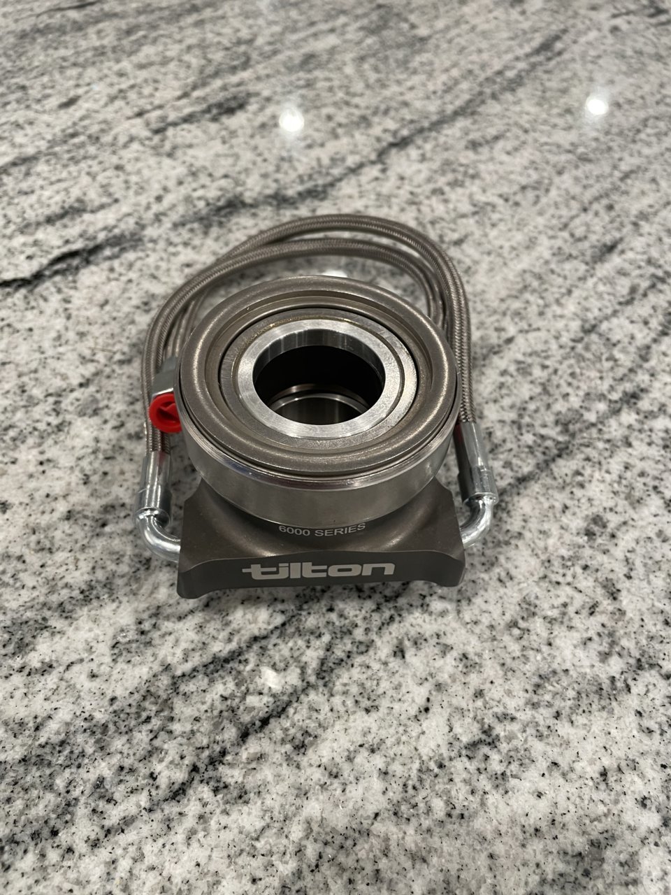

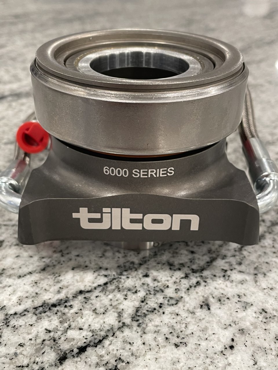

  8. Apr 22, 2023 at 8:17 PM
    #128
    cfcarpenter
    cfcarpenter [OP] Well-Known Member
    May 29, 2018
    #254913
    328
    Clint
    PNW
    2005 DCLB 4wd MT

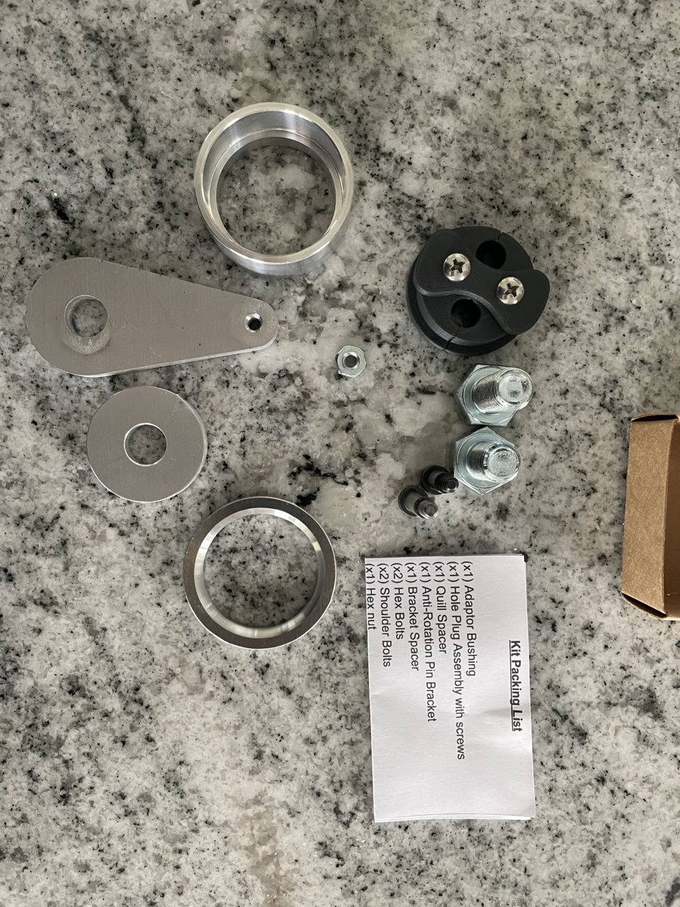

    Got the tilton piston mated to the machined bushing. This was a struggle for me 3rd time was the charm. I got it 1/2 way on after bumping the temp to 225 and freezing the tilton piston for an hour. After that I hit it with the propane torch, it slid all the way but 1/8”. At this point there was no getting it on or back of so I squared it up and gave it a smack with a mallet. Fully seated. Next up was the bearing. I was nervous but it slid right on as it should.

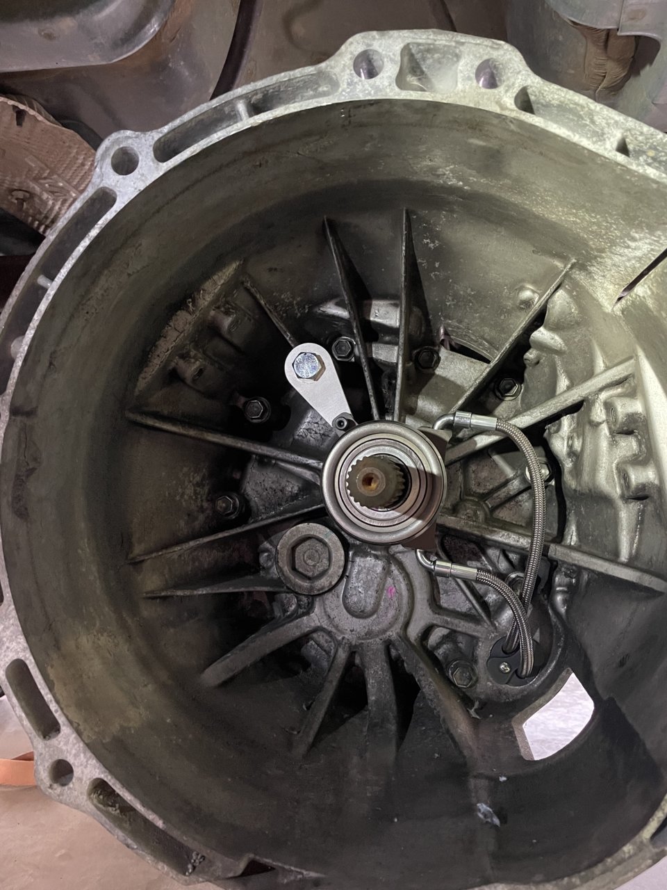

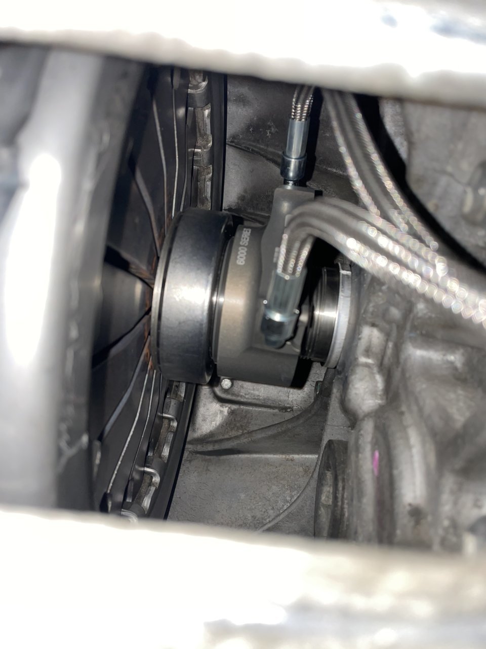

  9. Apr 25, 2023 at 6:35 PM
    #129
    cfcarpenter
    May 29, 2018
    #254913
    328
    Clint
    PNW
    2005 DCLB 4wd MT
    Nailed it on the first try with the spacing. Had to bend the bleeder bracket to make it work. Just need exhaust donuts and a stud. Than I can tackle the fj pedal.

    What does this Tilton thing do?
  11. Apr 26, 2023 at 5:24 AM
    #131
    cfcarpenter
    May 29, 2018
    #254913
    328
    Clint
    PNW
    2005 DCLB 4wd MT
    The stock throw out bearing is always touching the pressure plate fingers. Which causes the chirp/squeal issue. Going this route allows you to adjust the bearing back 1/8” from the pressure plate and keeps the bearing from contacting and making noise.
