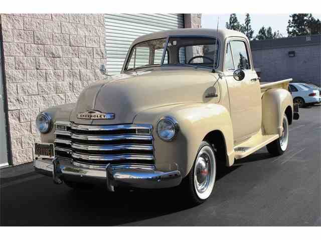

    This one meets your criteria and looks better than any Tacoma...
