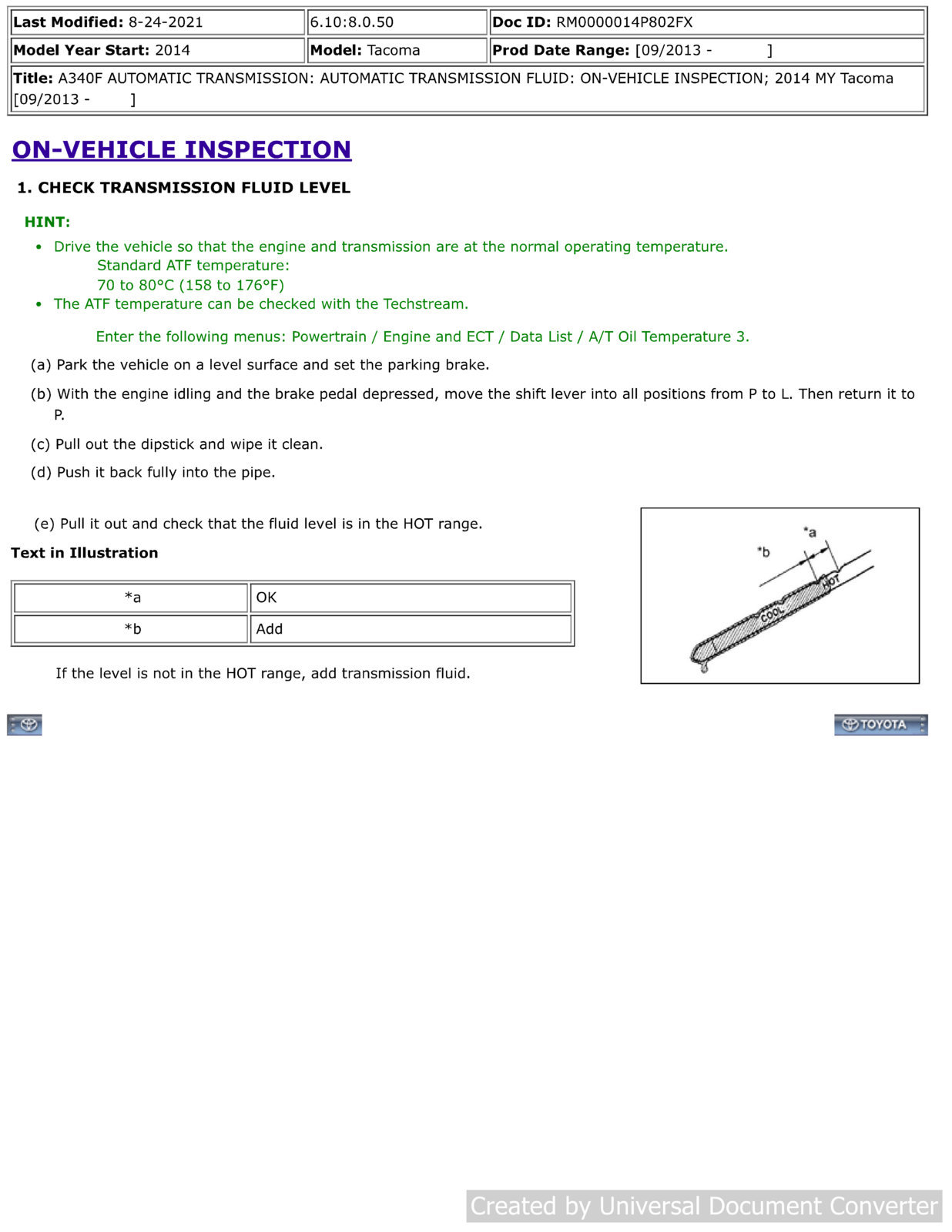

    Have you checked your transmission fluid?
