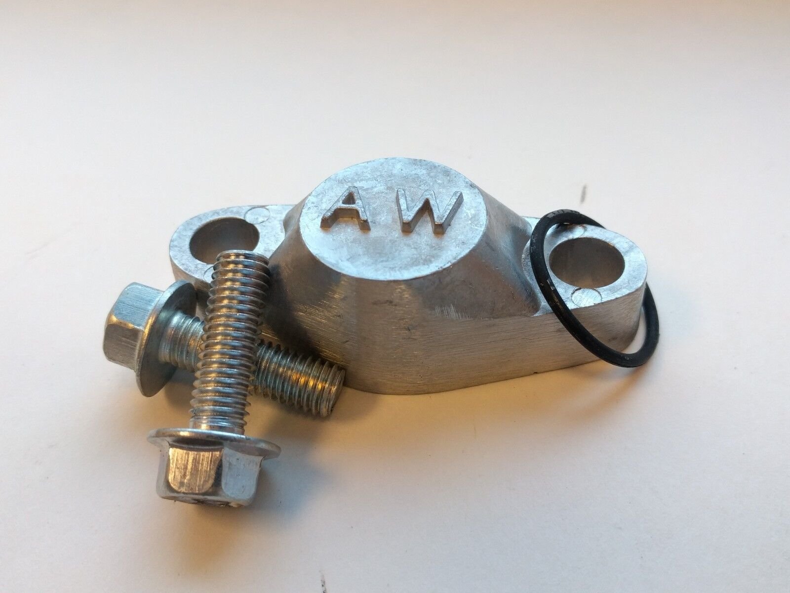

    That large over drive solenoid...ages and clogs over time.....
    if you disengage it when its real old.....you run the risk of it not kicking back in....
    thereby losing your over drive.....forever...or at least until its replaced....
    Old fluid and old rotting hoses speed all this up...
    This is my backup plan that I bought......just in case....
    https://www.ebay.com/itm/255655536375
