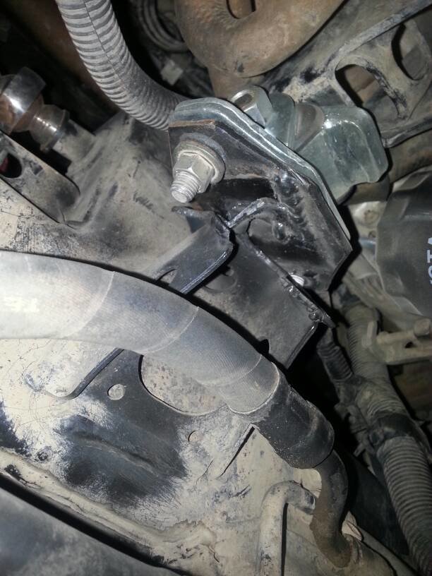

    Here is what a bad motor mount looks like. 9a00fc2bed969744925635b576bb10a2_4748923f4da78460adadd1db768b4eb954ed4495.jpg
    Also the ears may have broken off so it will look like it's not seated properly

    Here are the shots, doesn't look like the mounts are bad.
    Hard to get under there to see what is rattling, by the time I get back to my garage it stops. Doesn't do it every time.

    Mounts look OK visually but you have to pry at them to tell if they are starting to fail . Maybe take it to a shop where they can put it up on a hoist and look, this way you can have someone sitting in the truck moving the transmission through the gears as you try and reproduce the rattle
