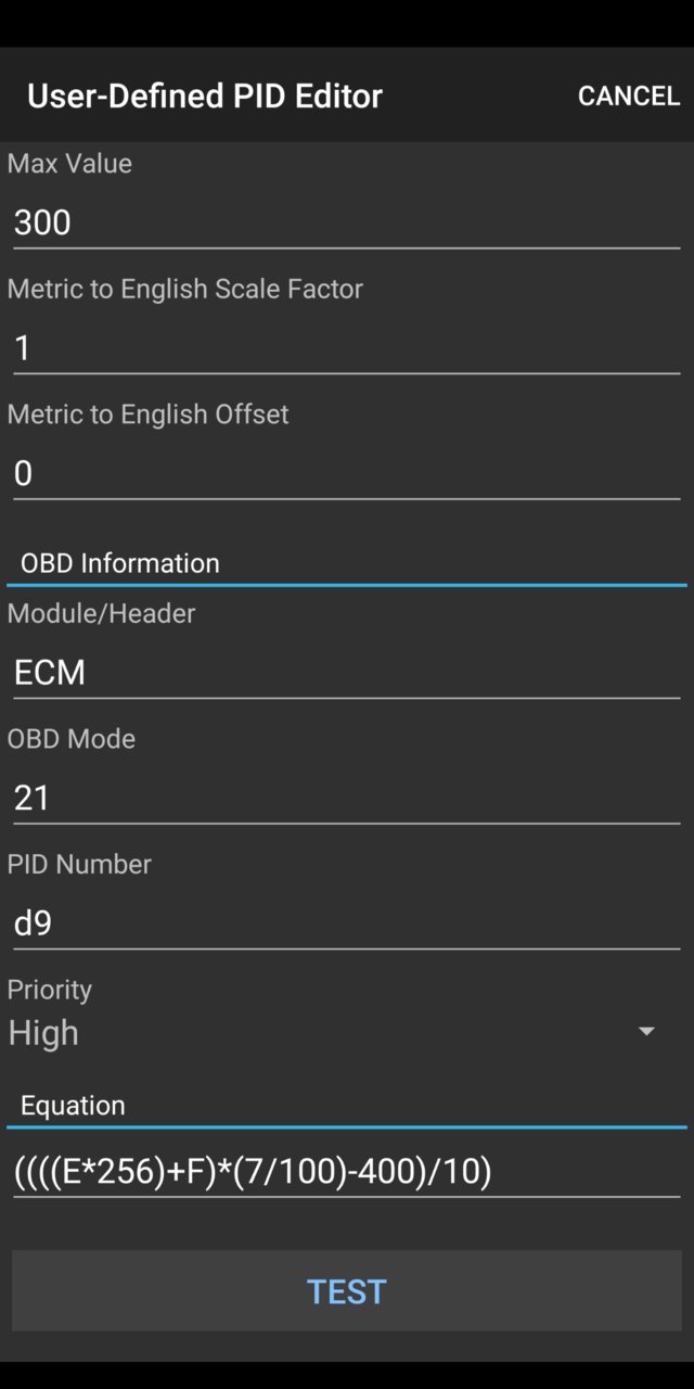

    User defined PID. There are 2, one for the transmission and the other for the torque converter. Same formula, different letters.
    The screenshot is of my tranny temp. Change E,F to G,H for the other.
    If that doesn't work, change the letters to A,B,C,D respectively.
