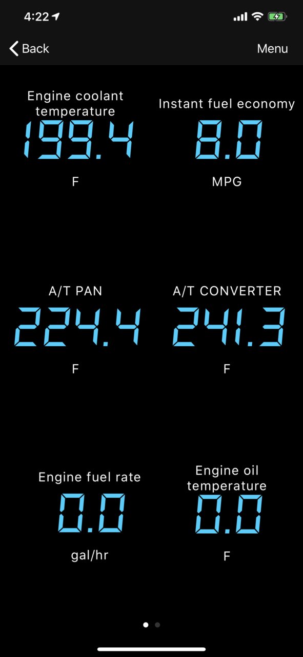

    I don't really have to try hard to hit these numbers in the summer. I've since upgraded my trans cooler so it'll be interesting to see what affect it has.

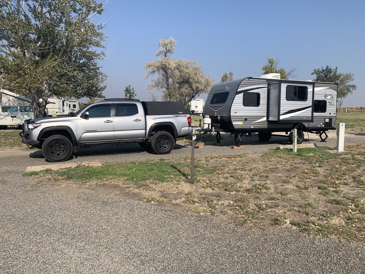

    I towed the same trailer in the picture i posted above with the 4.0l 2007 4runner, and with the 3.5l tacoma. I do agree that even the Toyota 4.0L engine spun less rpms and seemed to pull with more power to me. the Taco does have more power, but you gotta get up to 3.5k+ rpm to feel it. Gears really help these 3rd gens, Truck pulls like a champ now with 5.29's

    Pull the same 4800lb Hideout with the 2005 and the 2017;
    4.0 might have gotten it going at first but as far as pulling on hills and going down the highway the 3.5 does it better, cooler, and gets better mpg.
    (old pic,3rd Gen now has 265/70R17 E RTs)
