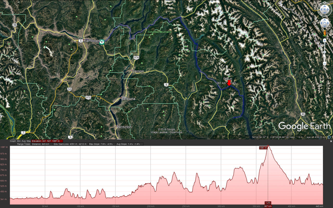

    We've towed all over BC, this is a regular kind of trip;
    Not exactly flat.. I tow in S4, with ECT on, and can stay at 90kmh easily. Coolant and Transmission Temps stay around 90C (194F) steady. When I climb it goes into 3rd and temps slowly rise, they have always peaked at 110C (230F) and stayed there until the top of the hills. Gas mileage is pretty lousy when the trailer is on 9-11mpg is not unusual.. But its hard to beat the view when you get there;

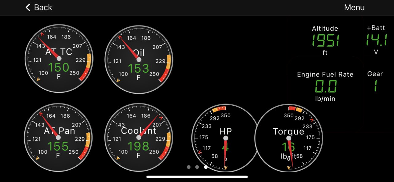

    DEA937ED-F3D7-45A8-9B49-C7C66045D9C6.jpg This is what happens when it is 18 F outside. 15 mile commute at 65 mph . Don’t need to pin the t stat open. Did the screen shot at the stop light after getting off the freeway. Barely warm.

    I agree for that drive you don't need to pin it open. the reason i'm pinning mine open is for long drives up to the sierra's towing or unloaded. I would see torque converter temps up in the 220 range even unloaded at times when shifting down to third. Pinned open i never see pan temp get over 170!
