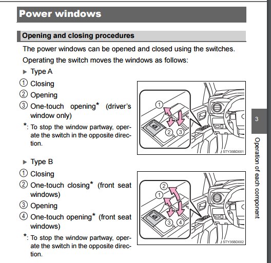

    I've got an SR5 so I only have the auto-down drivers windows, "Type A" according to the manual. It appears that "type B" windows have both auto-down AND auto-up on both front windows. I looked around and see that there are mods for the 2nd gen to do the automatic windows, but didn't see anything for the 3rd gens. Is this just a switch change? or is it a switch change plus a techstream change? I saw someone in another thread had posted all of the possible techstream settings and auto up/down was one of them.

    i've seen that, but if your truck didn't come with auto up/down windows, is it still a feature that can be set? i just have auto-down on the drivers side. I understand that it may be a special switch that clicks twice, but in practice it doesn't actually matter if you press it all the way down to the second click. i can make my drivers side window auto down just by going to the first click and holding it there for a second or two.
