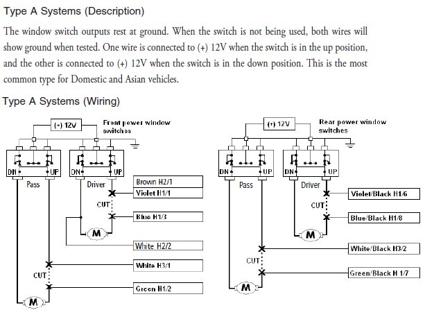

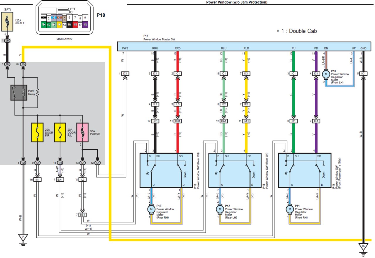

    eurowner and shakerhood like this.

    Just reading material.
    The system on the SR has a 20 amp per window motor (30A for the Driver's)
    The DEI 535T only one 20 amp fuse.
    shakerhood likes this.
