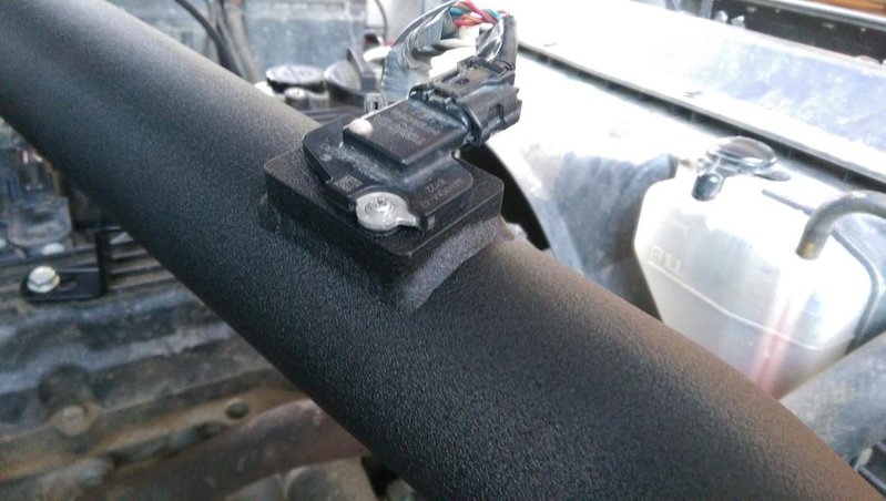

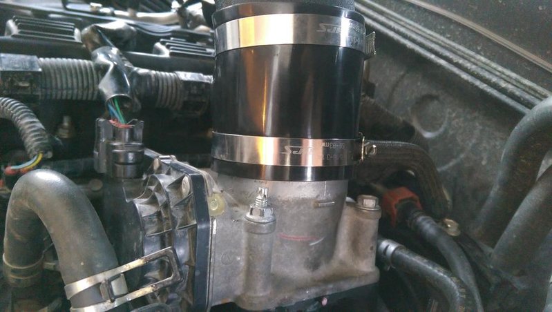

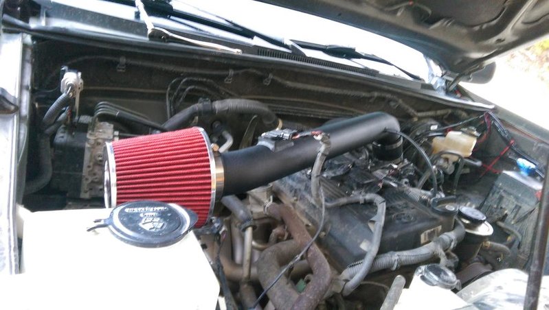

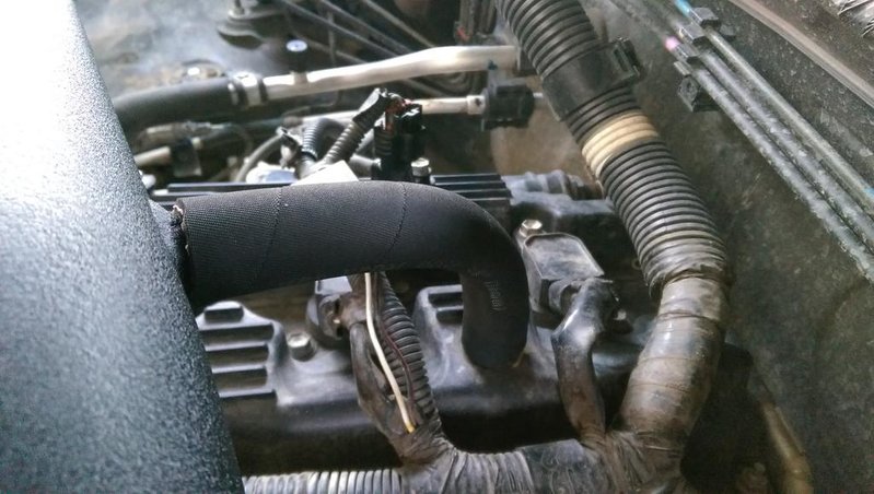

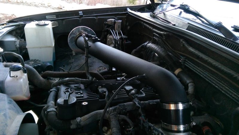

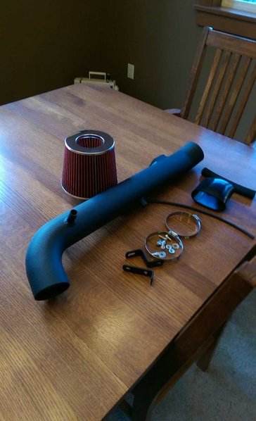

    I found this air intake on eBay for $89.99 and said well lets try it. Its a warm air intake it's a given. I know stock air intake is Damn good I did the secondary delete and also the black thing in the fender delete with an Afe drop In. I also have LCE headers on my 2tr. This intake I was expecting to mod a way for the MAF sensor and basically everything else. But it was a direct bolt on! Took about 20min to install and taking it for a quick spin it was good. Damn loud but it seems pretty good. I will see how gas mileage is this week but for how cheap it is compared to other brands similar to this it's I'm very impressed with it.

    Good luck. But now you are sucking in all that Hot Air from under the hood... :eek:

    Any mpg gains will be due to the engine using less fuel to account for the hotter air you will see under the hood... this also directly correlates to LOSS in performance.

    So drove about 200 miles with this intake. Dang its loud for sure! only when you in high RPMS. for performance and loss of power or gain. I have to say it's very close. With my header/exhaust combinations I would have to say I could of gained a few ponies but nothing to Brag about. It gets a good amount of air coming through the grill and headlight area. My only concern is when crawling all the head might effect it. I guess time will tell.
