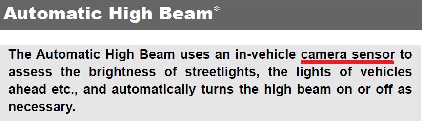

    This sensor in the passenger's side dash is NOT for the high beam feature. The camera behind the cab mirror is what detects oncoming traffic to switch to low beams.

    if the dimmer bright sensor is on the rear view cab mirror, the owners manual is wrong-possible I suppose.

    Where does it say it is on your Taco's manual?

    I don’t have the book in front of me but I believe it’s on the same page as the instructions to use the auto dimming feature.
