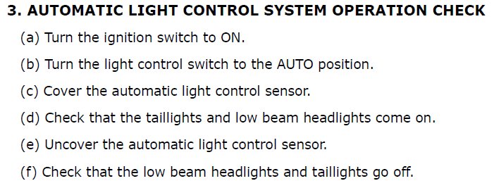

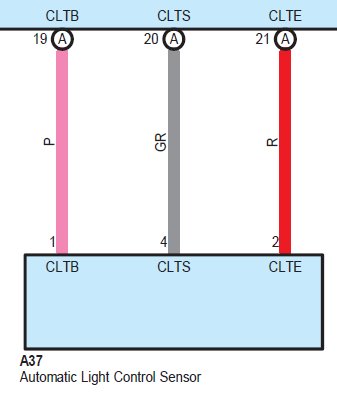

    There is a label on the drawing stating it's the Automatic Light Control Sensor...

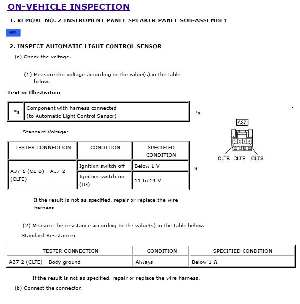

    The other "picture" states to verify voltage between the PINK and the RED. (19 & 21) on connector M6 on the Main Body ECU.
    My suggestion is schedule a Stealership appoinment...
    P.S. There's no fuse to change and fix for this feature.

    Did you check to see if the tail lights come on when you are in auto mode and cover the sensor? If no tail lights then most likely sensor problem. If tail lights on and no headlights then wire harness issue on the leg going headlights.

    Your guesstimate is flawed by just a little. The sensor senses. The Main Body ECU does the rest.

    Yeah, no tail lights. I ordered a diagnostic scanner from Amazon that will come tomorrow. I’ll see if it’s throwing any codes. Sounds like I’ll be ponying up for a new sensor, though.
