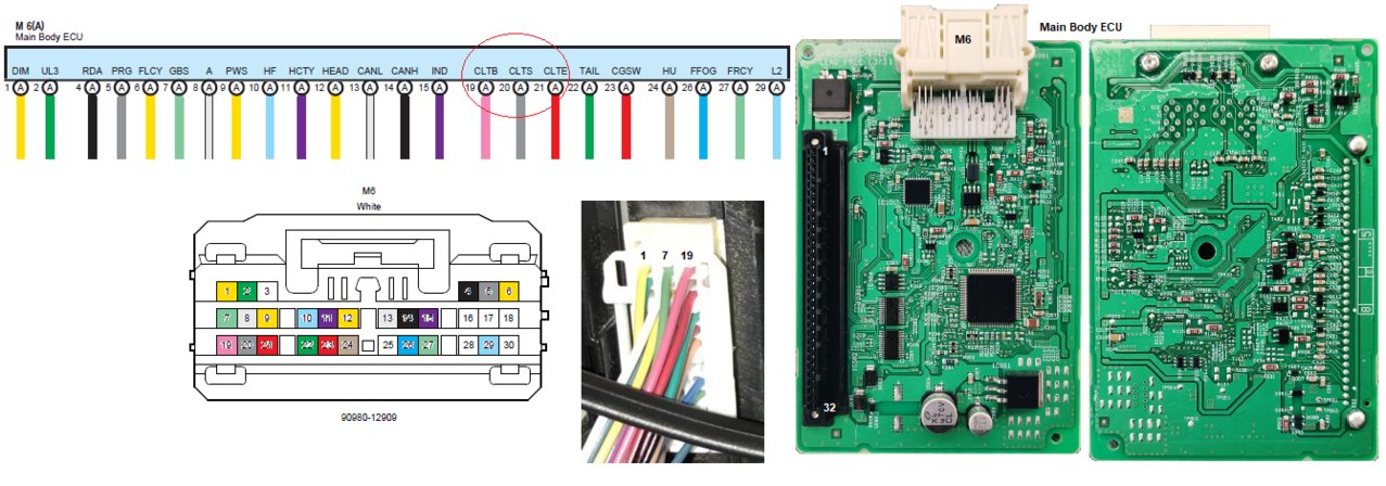

    Just for shits n giggles, with the vehicle OFF, remove the 7.5 amp fuse the reads ECU IG No.2 and replace with a known good one.

    I'll give it a try. Don't have any 7.5 amp fuses on hand so will have to do later. I did pull it out, though, just to see if it was blown. It's not, but who knows.

    Just gave it a try. No dice.

    I suspect the Main Body ECU is slowly failing...

    Your guess is as good as mine. Code reader showed up and it's not throwing any codes so who knows.

    $1,300 +/- ?
    [A] 8_A is the auto feature (ground)
    [HEAD] 12_A is to light stalk select of HEADLIGHTS
    [HU] 24_A is to light stalk at High Beams n Flash
    [CLTB] 19_A is power to sensor
    [CLTS] 20_A is sensor output
    [CLTE] 21_A is sensor ground

    One thing I did notice is that there is just an open ended plug. Not sure if it's always been there (maybe for some other option?) or if it somehow worked itself out, which seems unlikely. Doesn't seem to reach to anything. This is under the dash basically up against the firewall.

    That is the towing break connector, it's loose back there until you add a towing brake module pigtail.
