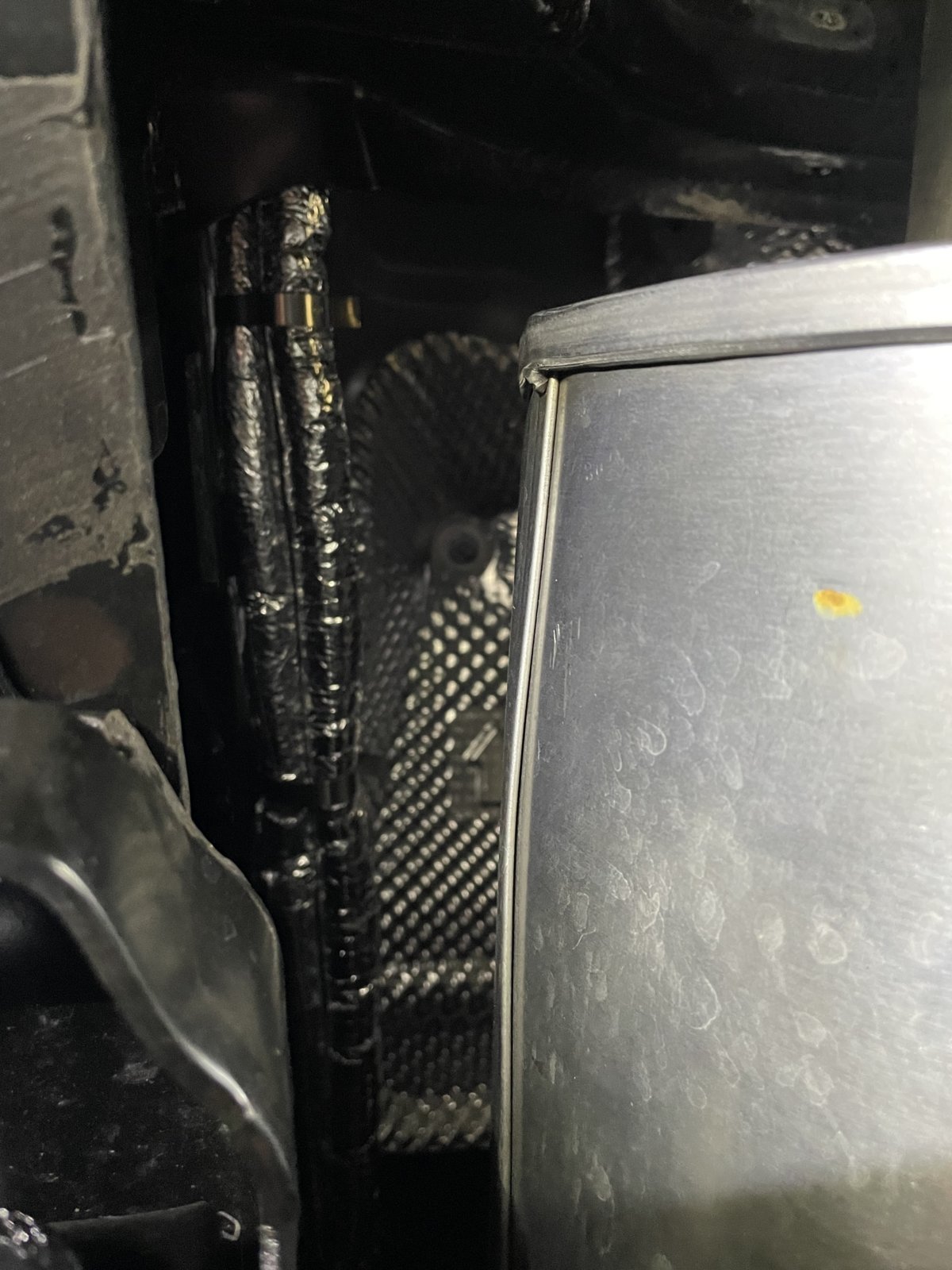

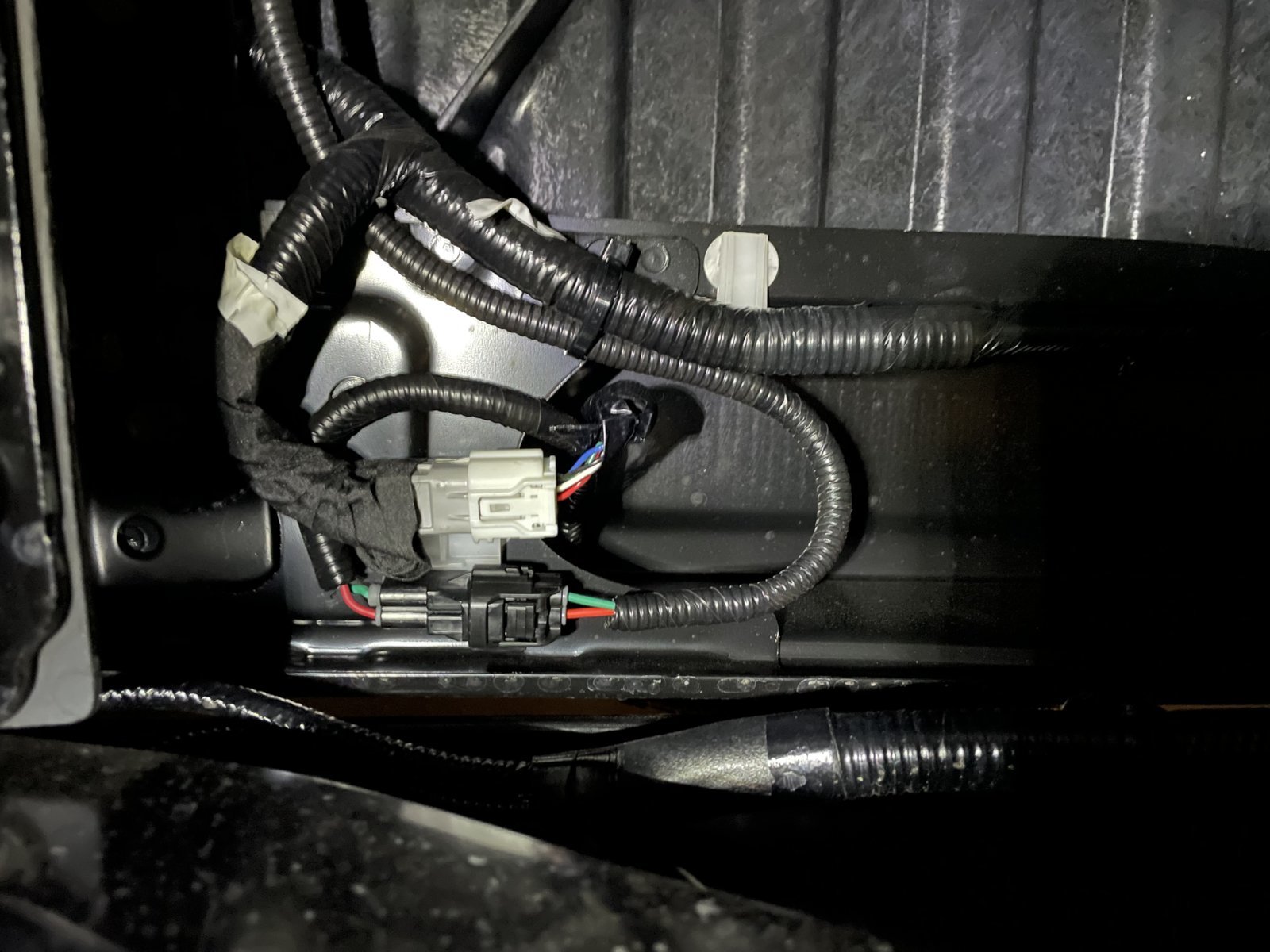

    Took some photos of the wire run while under my truck tonight, maybe they can help someone.1st pic is the grommet where the wire harness exits the cab. Then the second shows the other side of the frame rail where you tun the wire.

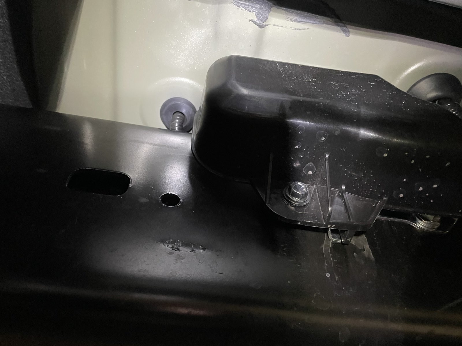

    Third pic, at the front of the muffler you can put one arm on the outside of the frame rail and the other on the inside, then for the next few wire ties just kind of hug the muffler and it’s real easy to secure the wire

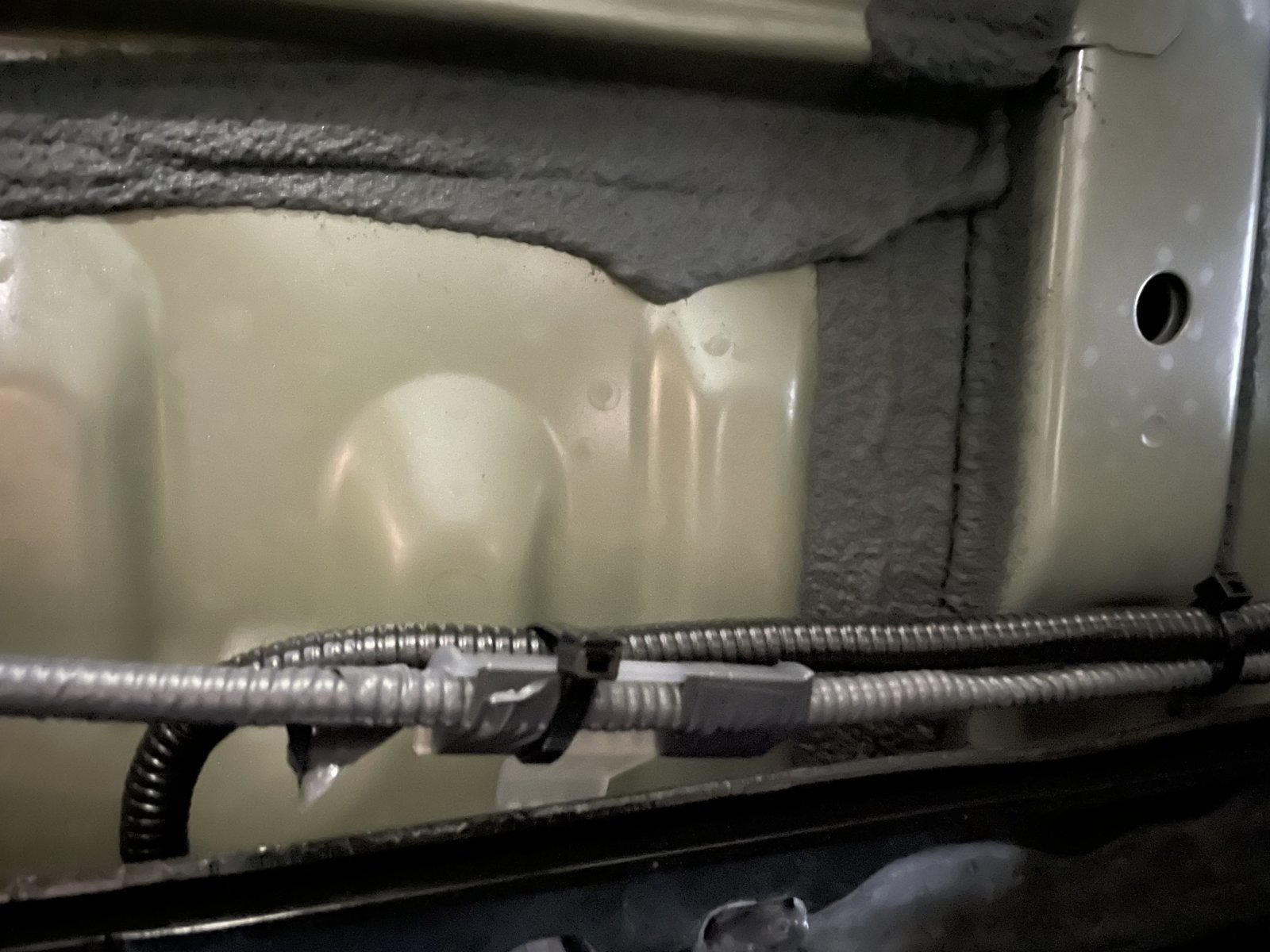

    Lastly, something non of the videos or the instructions show. At the rear of the bed there is a clip that the harness will attach to. The white plus was there from the factory, black plug is the harness to the tailgate. For the clip inside the tail gate that calls for rust prevention, just use a wire tie around the brace it is supposed to attach to.
