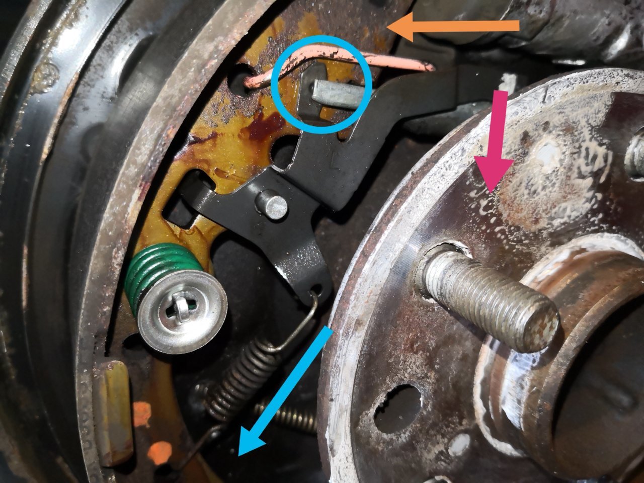

    Thanks for the link, but I still have trouble to understand.
    I have a photo attached.
    Orange arrow shows the direction of how the cylinder pushes the shoe.
    The adjuster moves WITH the shoe cause it is fully mounted on it. Only the spring pulls downwards, s. blue arrow. But it can't really pull because it is locked s. blue circle.
    How can the adjuster push downwards on the starwheel (pink arrow)?
    The only way would be, if their occurs a gap within the blue circle point. But in this case the adjuster would turn the starwheel pushing the rod end against itself. It should spread the rod against the shoe to eliminate the play. So there shouldn't be the notch of the adjuster...
    Ok I think I got it!
    The gap occurs on each cylinder movement because the adjuster is fully mounted to the shoe. And depending on the air gap the lever turns the starwheel downwards.
    At least the stars are not worn down like in the link above...

    Just to finalize this thread, I want to a add the "best method" of how to adjust the parking brake to the perfect level:
    Turn the adjuster wheel to make is loose and mount the drum back again with two wheel nuts. Then just push the brake pedal as often as you hear the adjuster clicking. It start with 3 clicks per push, then later 2 and 1 click. Finally you won't hear any click. This means, that the gap between shoe and drum is minimized to its mechanical calibrated level.
    Make sure that the drum still rotates with small drag.

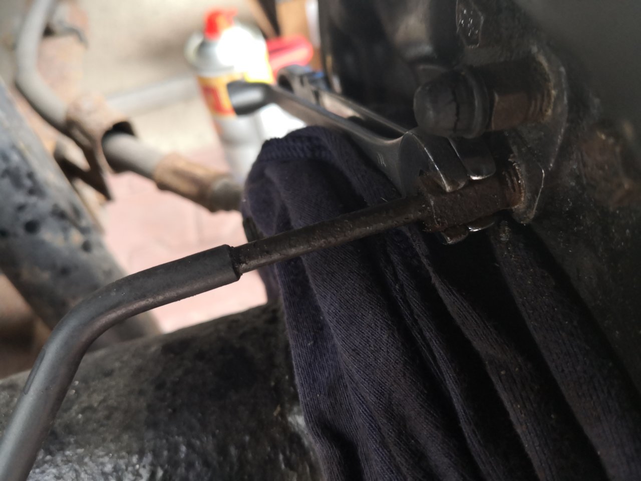

    Another tip when working on brake lines:
    Use two wrenches to maximize grip.
    Helped me to prevent ripping of the surface.
