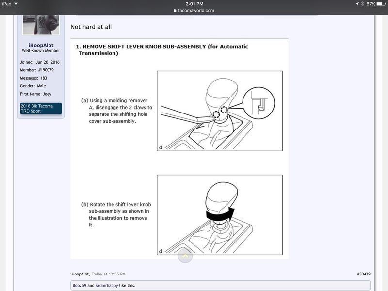

    Had the same looseness.This took care of it.
    canibe and RBfastback like this.

    honestly you don't even need a tool, grab the chrome ring at the top of the boot and just push it down. Pops right off and then spin your knob and lift the boot ring back up and it clips right on.

    Mine was like that when I got it a couple months ago. Took it the the dealership and they just pushed the chrome ring down spin it 2 times and re attached it. I knew I could do it easily myself but let them do it incase ir broke. Now it's tight! Doesn't budge. Guy said he sees a lot of them like that from the factory.
