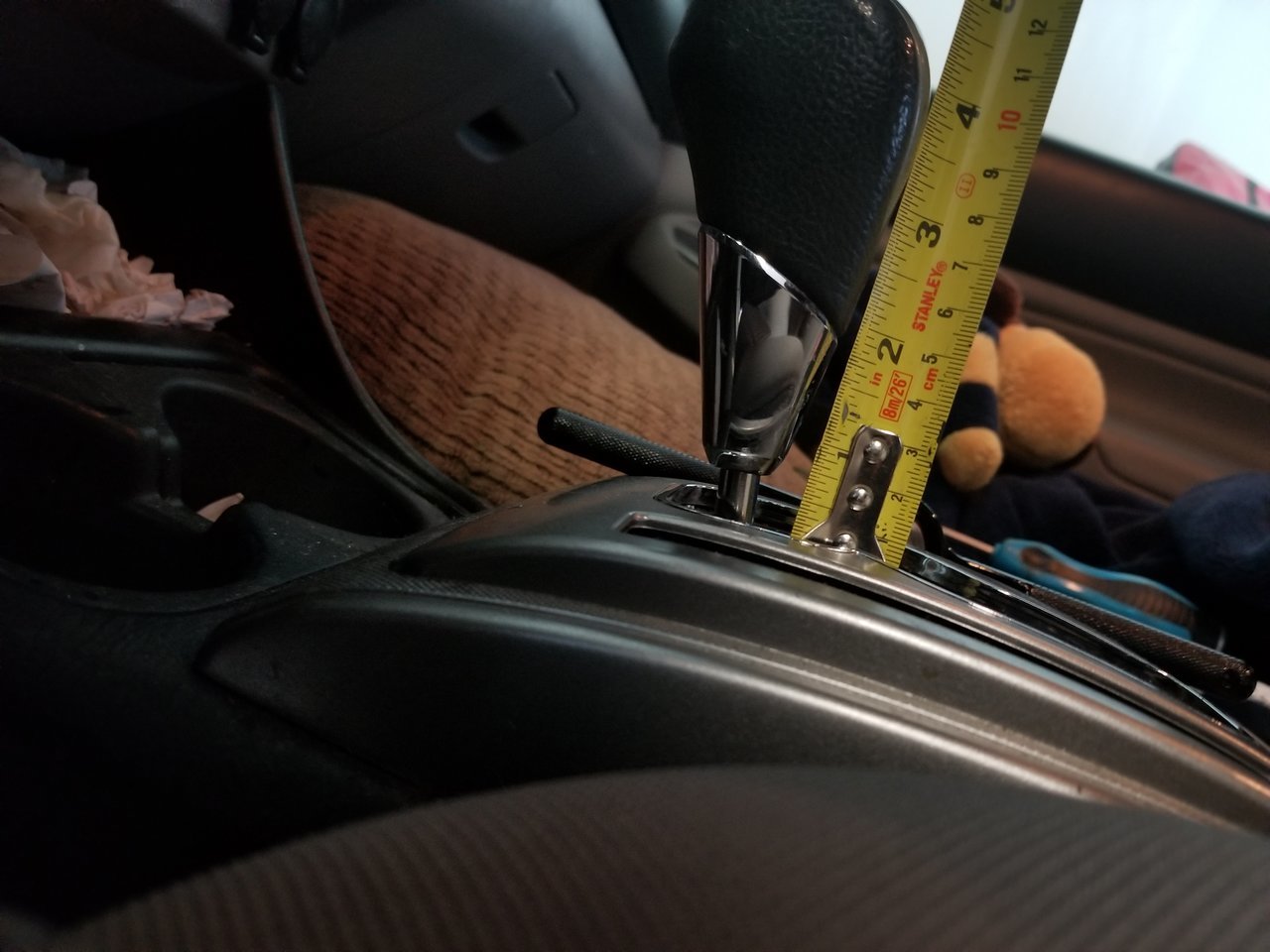

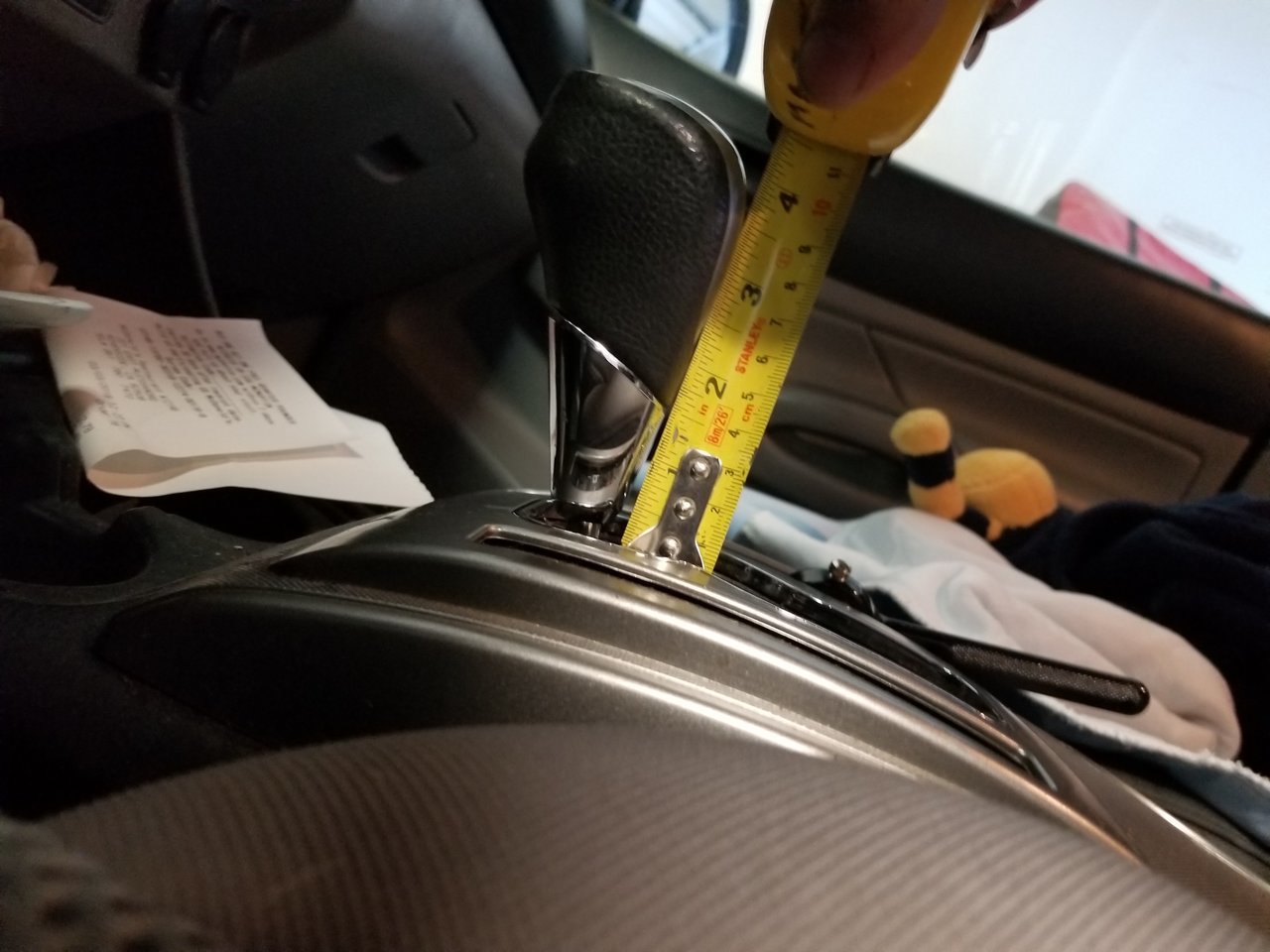

    im sure its been done before.. but i never really liked the extra length of shifter at the bottom of the shift knob... didnt care to much for the chrome color either so i shortened the shifter for a more low pro clean look.. i plan to pick up a 3rd gen shift knob from a member on here, cut the boot clip off and screw it on to complete the look im going for..

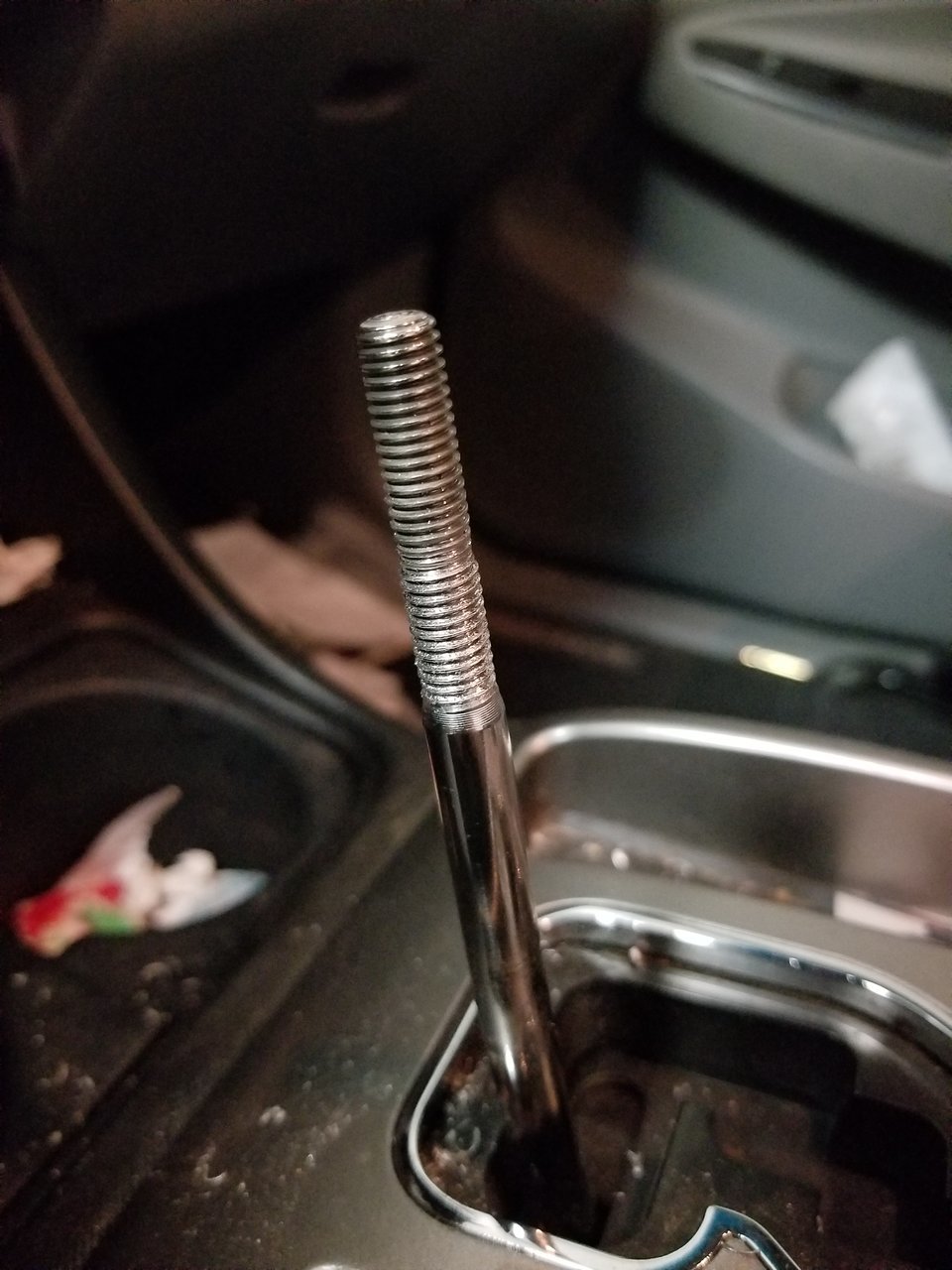

    threaded the extra space on the shifter before it stepped up to a bigger rod

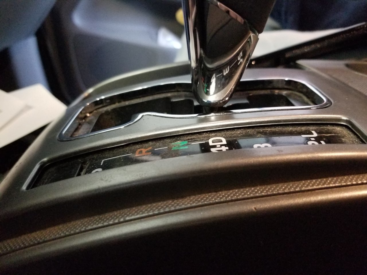

    20180315_234855[2].jpg heres how it sat after the first cut i made and test fit.. i wanted it lower so i made another cut20180318_181639[1].jpg

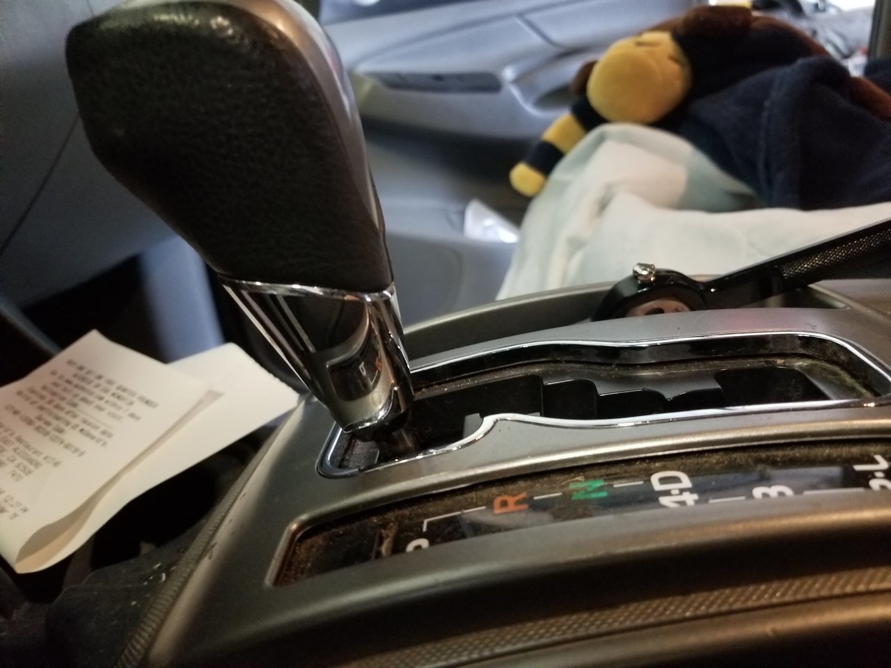

    here it is after the final cut.. all together i prolly cut about 3/4" off the shaft20180318_184328[1].jpg

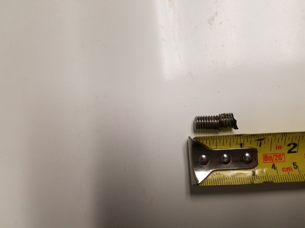

    heres what i cut off
    im really happy on how this came out.. was def sketchy cutting it, i didnt want to mess it up or cut it to short that it hit the column when shifting it.. but it all clears perfectly

    Looks great!! What size die did you use to cut the new threads on the shaft?

    Don't think you have too cut new threads,as the shifter's threads don't start till a ways up into the shift knob.

    thanks! i used a M8 x 1.25 die
    def had to make new threads farther down the shaft for this to work.. cut off almost all of the original threads.. only a little bit of them was left

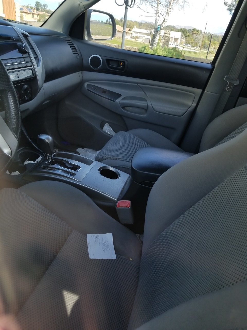

    How’s it look from a farther distance?

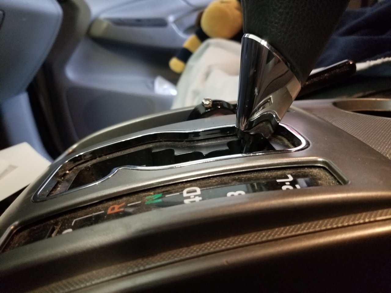

    ill go take a picture real quick

    It looks good!

    Did you just run the die down, or did you thin out the rod first, or something else I'm overlooking?

    naw i just ran the die down... theres a lil section about 5/8" thats under the stock threads thats about the same size b4 it steps up bigger
