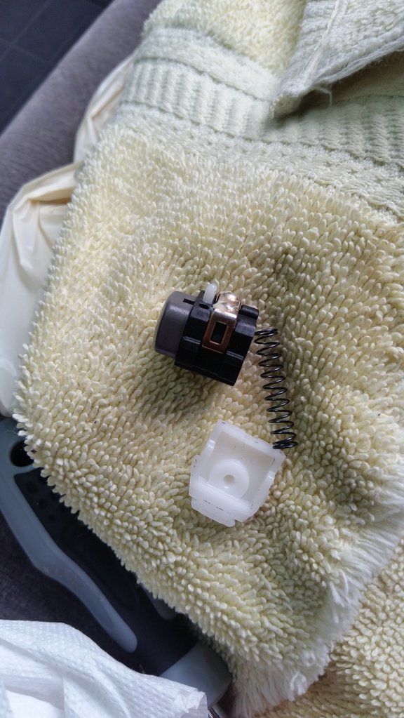

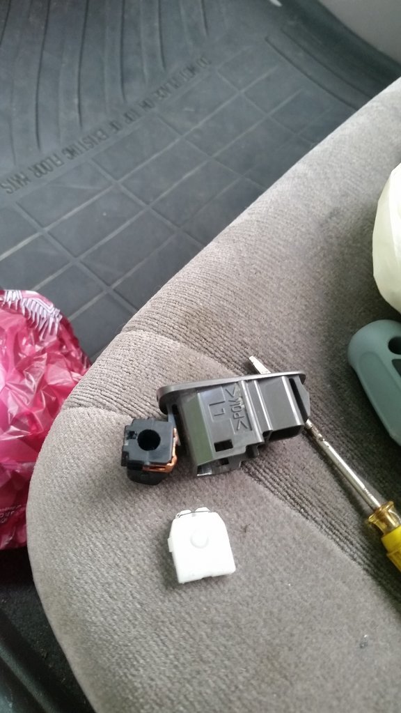

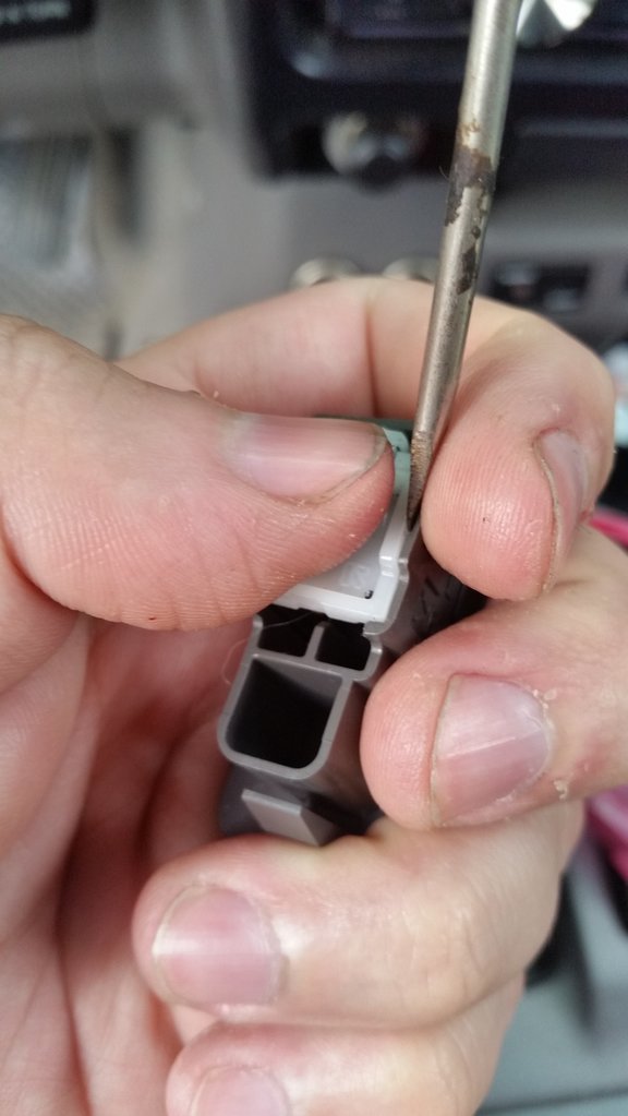

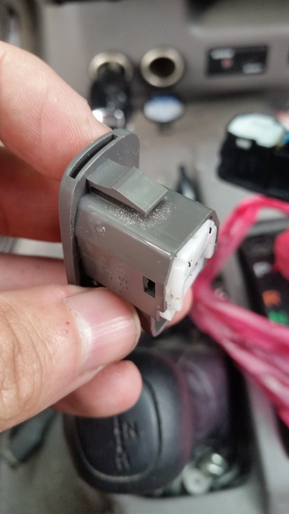

    I'll try to get some pics but one thing Val. Be VERY VERY VERY careful. You do have to take the button apart for the O/D. the wires are connected to the plate inside the button. When you pop the back white piece off the button there is a spring that will fly like free bird if you don't take it off slow.
    Once you have the plate out of the button you can slide the shift knob off and pass the plate through the opening.

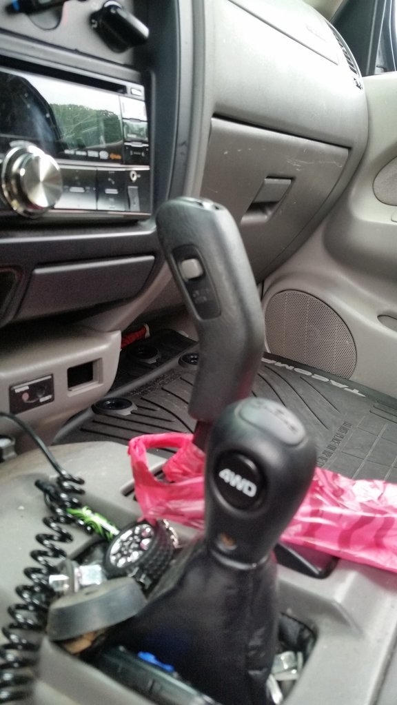

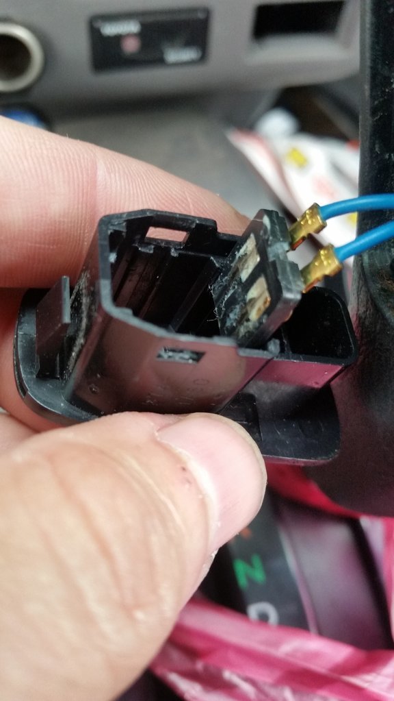

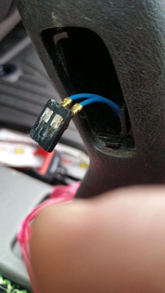

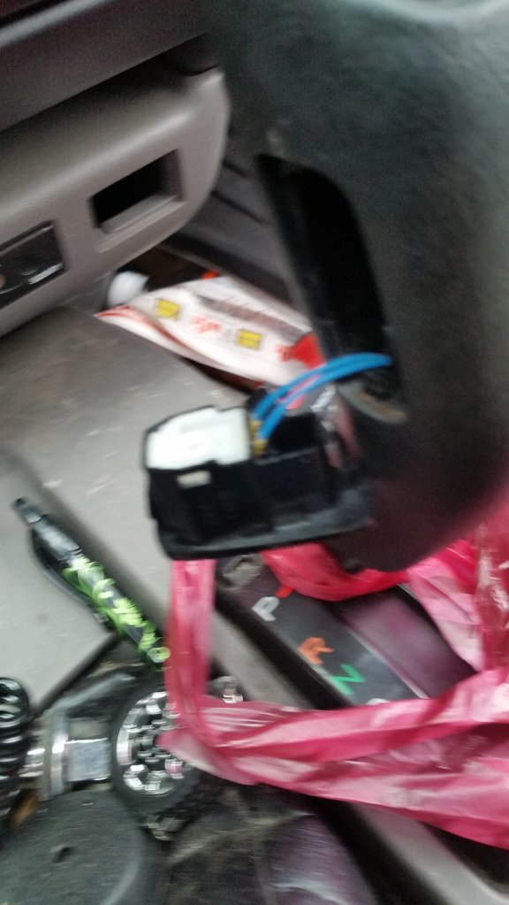

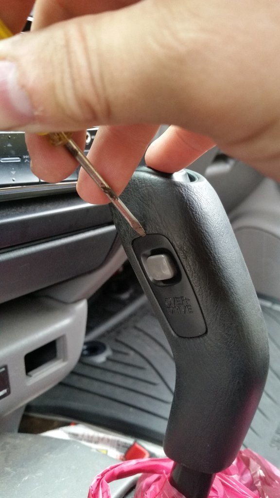

    black shift knob and 4wd button/boot from a 4Runner (98-02)
    pry out the button with a small flat blade or spudger (it's not in tight, just enough to hold it there)
    a bit fuzzy but you can see the back of the actual button
    here's the critical part, pry one side and then hold the white plastic piece to prevent it from flying off when you pry the other side (all with little wire length :( )
    the internals of the button
    the wire plate slot in the back
    my '04 button, a little different than the 4Runner's pictured above.
    I re-used my grey button as the 4Runner's operated on a double-click function (two presses to turn on, and two to turn off)

    put the two-wire plate in first. then put the button in. there's a spring-loaded piece on the bottom of it that prevents the plate from sliding in if you put the button in first.
    then put the spring in the back of the button bevel. then carefully hold the middle of the white piece and push as centered as you can into the back. try to get the two tabs to snap in almost simultaneously.
    it took a couple of tries to get it for me the first time. that little spring looks like a dam progressive spring.

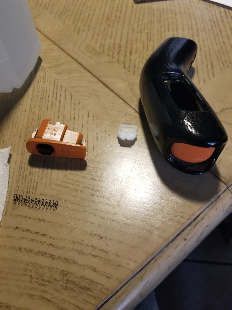

    I lost the spring for the overdrive

  20. Mar 21, 2019 at 3:33 AM
    #20
    ProjectEric2.0
    ProjectEric2.0 Well-Known Member
    Feb 12, 2019
    #282745
    130
    Eric
    2003 toyota tacoma 2wd standard cab 2.4L
    Interior paint, LED lights, speedometer projector, tinted windows
    Found it! Figured out spring goes between black piece and white and not white piece to inside of shifter. Unfortunately the casing had a broken piece on one side where it clicks into place where it holds down spring. Used black tape as a fix for now.
