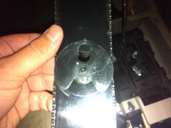

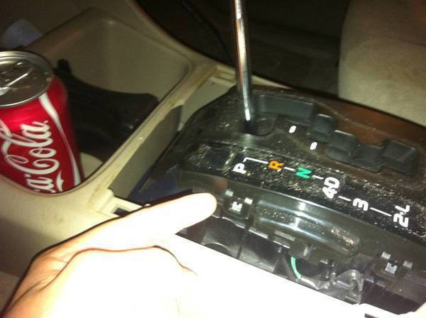

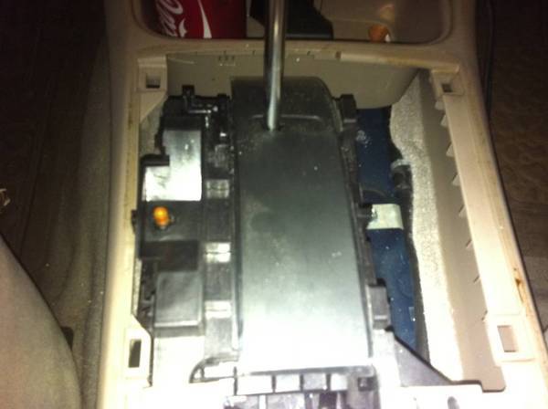

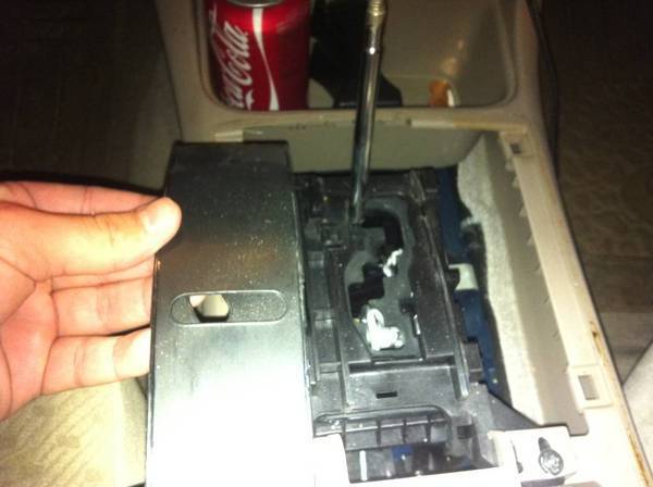

    It is the plastic piece that covers the open space in the shifter gate, it moves with the shifter.
    1. Remove console cover
    2. Remove plastic gate, it has 4 clips, I'm pointing at one
    Take off piece
    This is the part that is getting jammed, mine was clearly bent. I heated the plastic and made it as flat as possible. I think an iron might have worked a littler better, but no issues since fixing it
