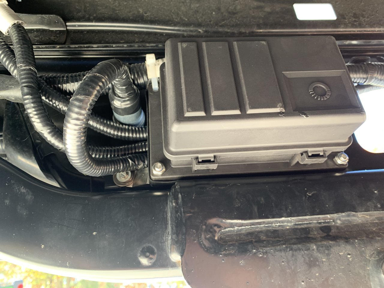

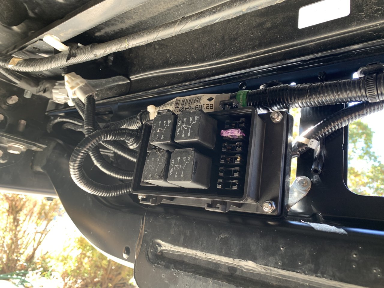

    This is a great forum. I have picked up some very good ideas here. Just now setting up a TW account so I can reply to this conversation.
    I have spent some time now looking for a solution for a rear view camera for our 22 foot travel trailer. My biggest problem with most kits is where to put the monitor?
    I came across this conversation which lead me to put together the components to switch cameras automatically.
    I am using 4 relays in waterproof box with fuse to switch camera inputs to OEM monitor. By use of a jumper wire on the trailer side of the add on camera plug. When the camera cable is plugged up it will:
    Send 12volts to trailer camera.
    Isolates the 6 volts to the OEM camera.
    Connects the ground wires to trailer.
    Switch camera inputs to truck.
    Relay box installed, I was afraid it was too big, but it fit like a glove.

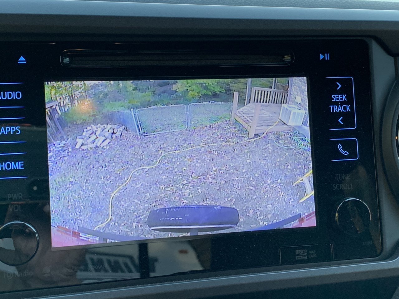

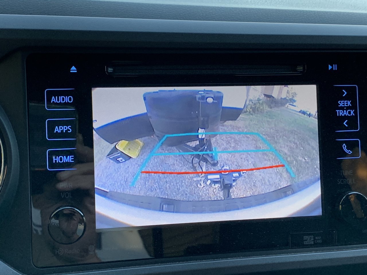

    View from OEM tailgate camera, backing up to RV. BTW the OEM camera is very useful for backing up to trailer.
    View from trailer camera after connecting add on trailer camera plug. The wide angle is better than it appears the bottom of the ladder is about 3 foot behind trailer and about 4 foot to the side.
    Have only tested in driveway so far, but will be going camping next week. I will follow up with some reviews from the road.
    If anyone wants more details on components or wiring diagrams let me know. But please beware about half way through the install I was thinking wireless may not be so bad!
    Thanks to everyone on TW who share there ideas.
