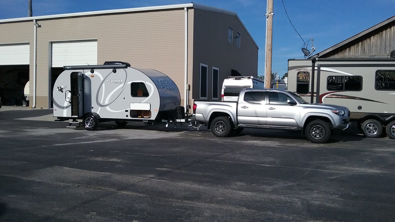

    Last truck I had (not Toyota) had that familiar skidding vehicle skid/sway control button. My new 2018 Tacoma SR5 Double Cab Short Bed specs says it has Trailer Sway Control, but there's no button. I'm guessing this is now automatic instead of manual. Would that be correct? As point of information I'm towing a 2019 R-Pod 179 using a Fastaway e2 round bar WD sway control system and a Tekonsha Primus IQ proportional brake controller.

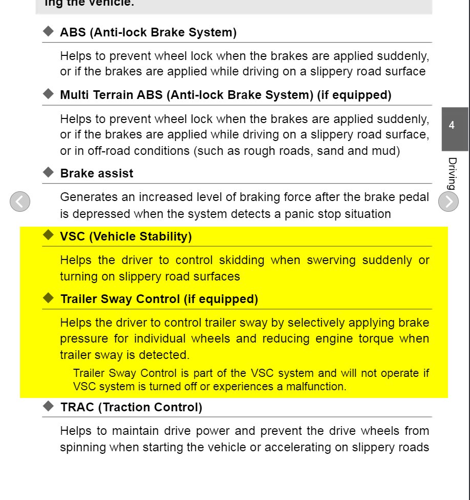

  8. Mar 14, 2023 at 2:20 PM
    Will2022
    Will2022 New Member
    Mar 14, 2023
    #420141
    Will
    2022 blue crush OR
    Trailer sway control. Page 322 of your manual. Toward bottom explains it. I just found it.
  9. Mar 14, 2023 at 2:56 PM
    mic_sierra
    mic_sierra Toshiba HDDVD is the future
    Nov 30, 2021
    #383480
    1,107
    Elsewhere
    '21 DCSB TRD Sport 4x4 Auto
    Page 319 of the 2018 Owners manual has the description of VSC (Vehicle Stability) and Trailer Sway Control if equipped.

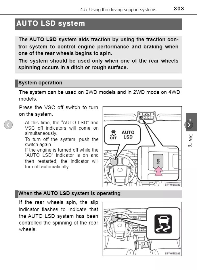

    Section 4-5 of the 2018 manual, page 303 has the information you are looking for (I think). VSC by default is turned on. You can turn it off by pressing the VSC Off button (Car w/ curvy road icon w/ "off" below it).
