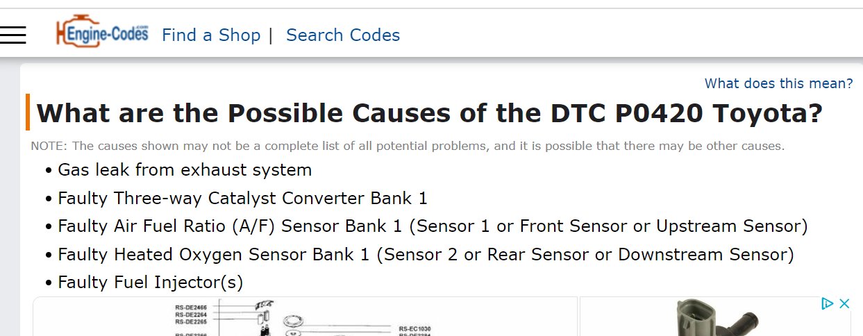

    @ControlCar One of the codes was P0420 and I'm blanking on the other code! o_O

    tht P0420 wouldnt be related to tranny issue

    Correct. BUT I wouldn't touch anything except for an exhaust leak until I knew the state of the transmission. The A\F sensors aren't that expensive, but a catalytic converter is.
    Square away transmission
    check for exhaust leaks
    change front and rear o2 sensors with Denso parts
    replace the cats
