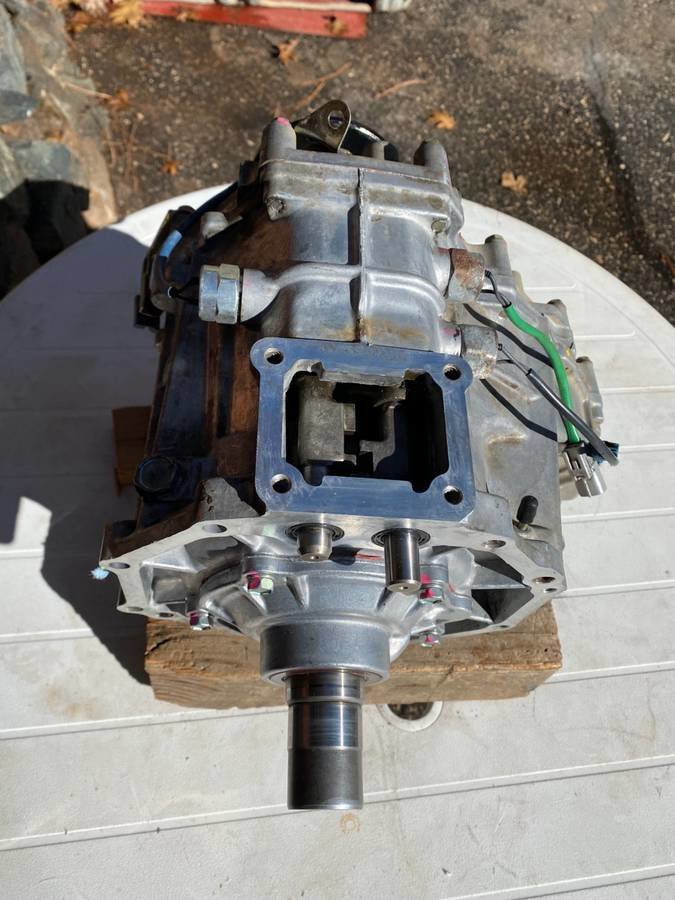

    Thanks @jbrandt. Below is an image of the TC I want to install. Guessing by the top, I'm pretty sure this is the j-shifter version (it supposably fits 1996-98).

    @foothill96tacoma , yeah, I don't want to make is sound like I'd be able to give you a definitive answer, since it's been many moons since I've taken a transmission/t-case off (was on my 86 turbo 4Runner for an auto --> manual swap).
    I know that for the folks doing the Prerunner-4wd swaps, the consensus is to get the J-shifter and manual hubs as that greatly simplifies the wiring because everything is manual. If you already have the push button t-case, I think that would complicate things in the sense that you'd need a new shifter to match the j-shifter form the "new" tc. If you currently have the j-shifter, that's probably a best case scenario.

    Following up... as it turns out, the TC I wanted to install (see above) would not work, as it had the push button setup that my 1996 rig does not have. I wish that these transfer cases had numbers as readily identifiable as the transmissions do.
