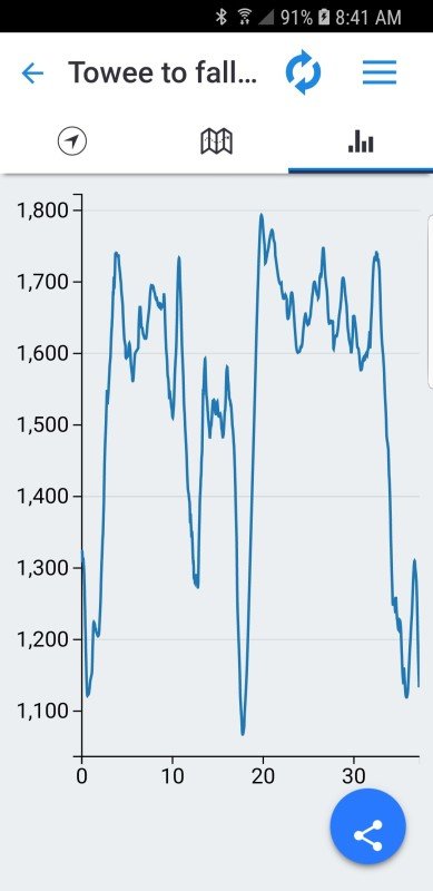

    Yesterdays mountain drive. No problems with sixth.
    Hopefully it's learning. :)
