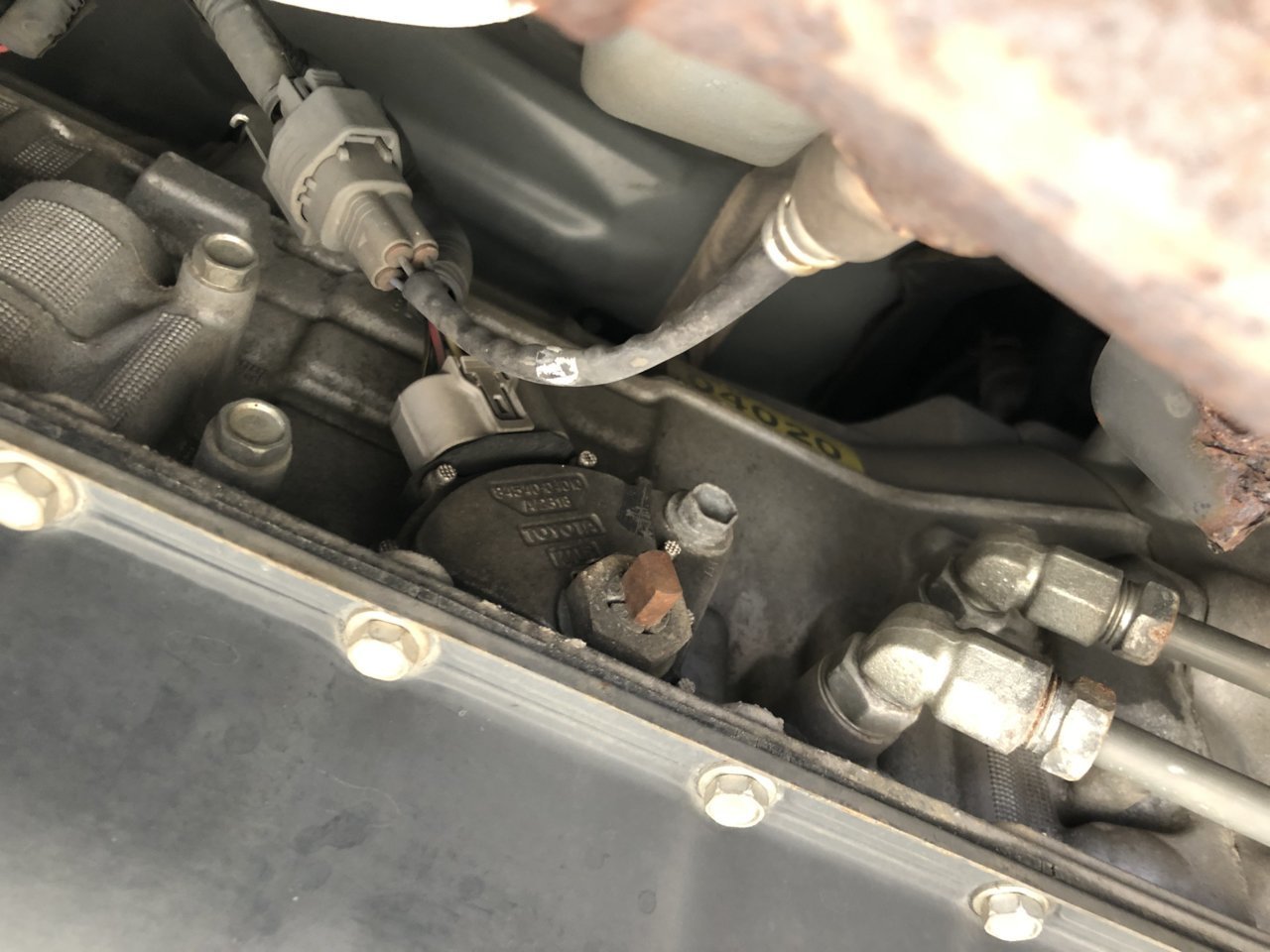

    gearcruncher

    Nov 1, 2012
    #90305

    Great white North 51.0333° N, 93.8333° W

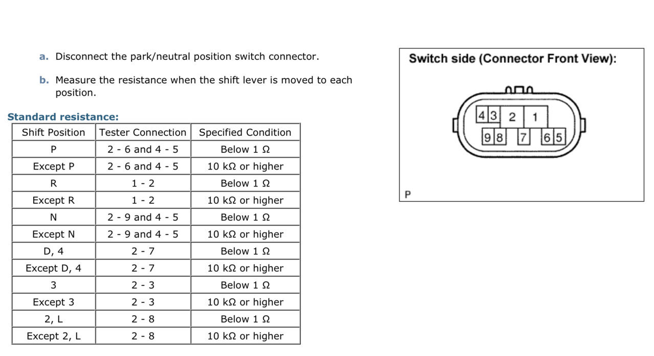

    TRD Sport Rally -5 speed automatic Limited ,Factory heated leather seats ,chrome package,Super white with front windows tinted to 35 % Dick Cepek DC-2 wheels Summer tires - Good year silent armor P265/65R17 Winter tires - Good year P265/65R17 Ultra Ice studded Illuminated 4x4 switch TRD 3rd brake light cover ($20) TRD seat belt shoulder protectors (5). ($50) TRD ...B pillar emblems ($20) TRD rear slider sticker with devil horns ( $6) TRD summer floor matts ($60) TRD steering wheel emblem ($20) TRD floor pedals .($95) TRD shorty antenna ($14) TRD front Windshield emblems ($17) TRD head pillows .($60) TRD head rest protectors TRD door scuff protection $20 TRD floor matt emblems ($40) TRD tow plug emblem . ($40) TRD cigarette lighter with LED.($35) TRD tissue dispenser ($12) TRD front bezel emblems ($9) TRD door emblems ($6) TRD lanyards($9) TRD lisence plates with TRD bolts($50) TRD fender emblems TRD center caps Part Number:PT904-35070-CC ($80) TRD cd
    Post number 23 tells you what to do .
    The computer in your truck doesn't know what gear your in .
    When this happens , the computer in your truck triggers code p0705 .
    That's all the wires from the computer that go down to the range sensor that is bolted to the side of the transmission.
    Follow the resistance testing procedures in post 23 to verify the range sensor is faulty or you have a broken wire from the range sensor going up to the computer in your truck

  20. Jun 22, 2023 at 9:04 PM
    #40
    ElSpud
    ElSpud Well-Known Member
    Sep 26, 2022
    #406738
    80
    2005 PreRunner, 2017 TRD Sport
    05 PreRunner 178k 17 TRD Sport 66k
    same thing happened to my 2005, same error code...
    There's a connector (about 7 pins, idk) on the passenger side of the transmission, pull it apart, squirt in some contact cleaner, then fasten and pull it apart 3 - 4 times. Repeat.
