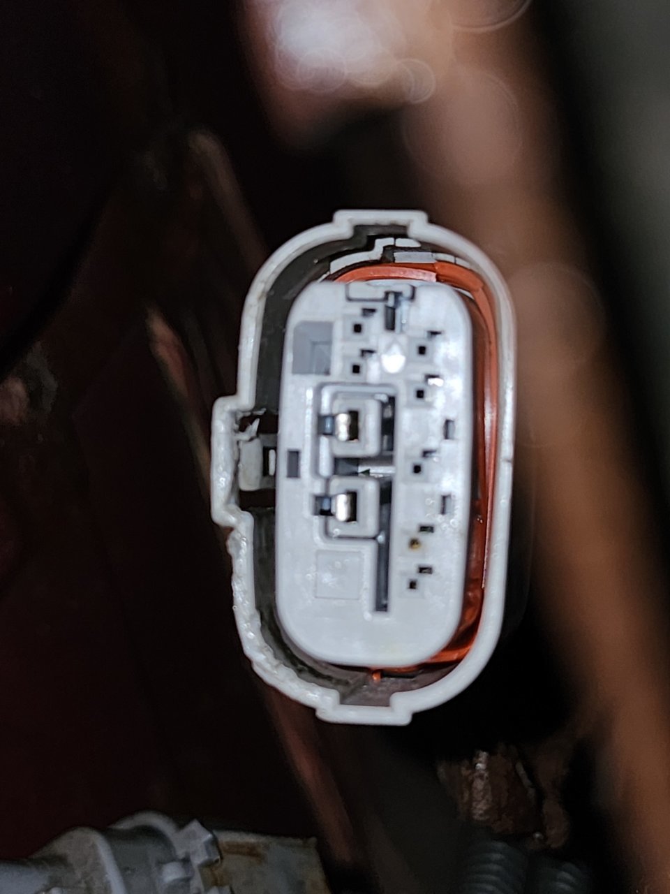

    Unplug it and inspect the pins. That’s easy.
    You may see the problem right there.

    How do I unplug it?

    Press here and pull up.

    Yea you may have to wiggle and mess with it to get it unplugged, those connectors under the truck tend to get packed with dirt and can be a pain to get unplugged.
    Yea that latch can break quite easily so be careful with it.

    Having a lot of trouble getting it off. It is very corroded with dirt I barely get any wiggle. Definitely going to take some getting to used to working with minimal arm length. :)

    Does not look like any corrosion or anything on the pins.

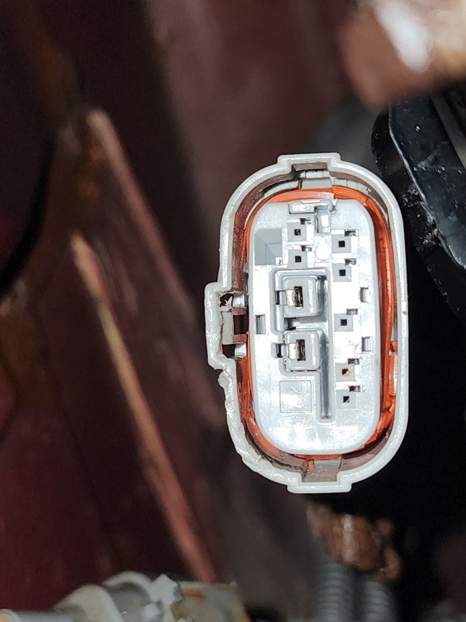

    The connector seems different than the one in the diagram from post #23. I am also having trouble getting the ohm meter pins into the small holes. They fit fine on the two big ones I think there labeled #1 and #2.

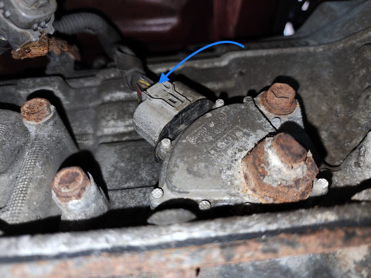

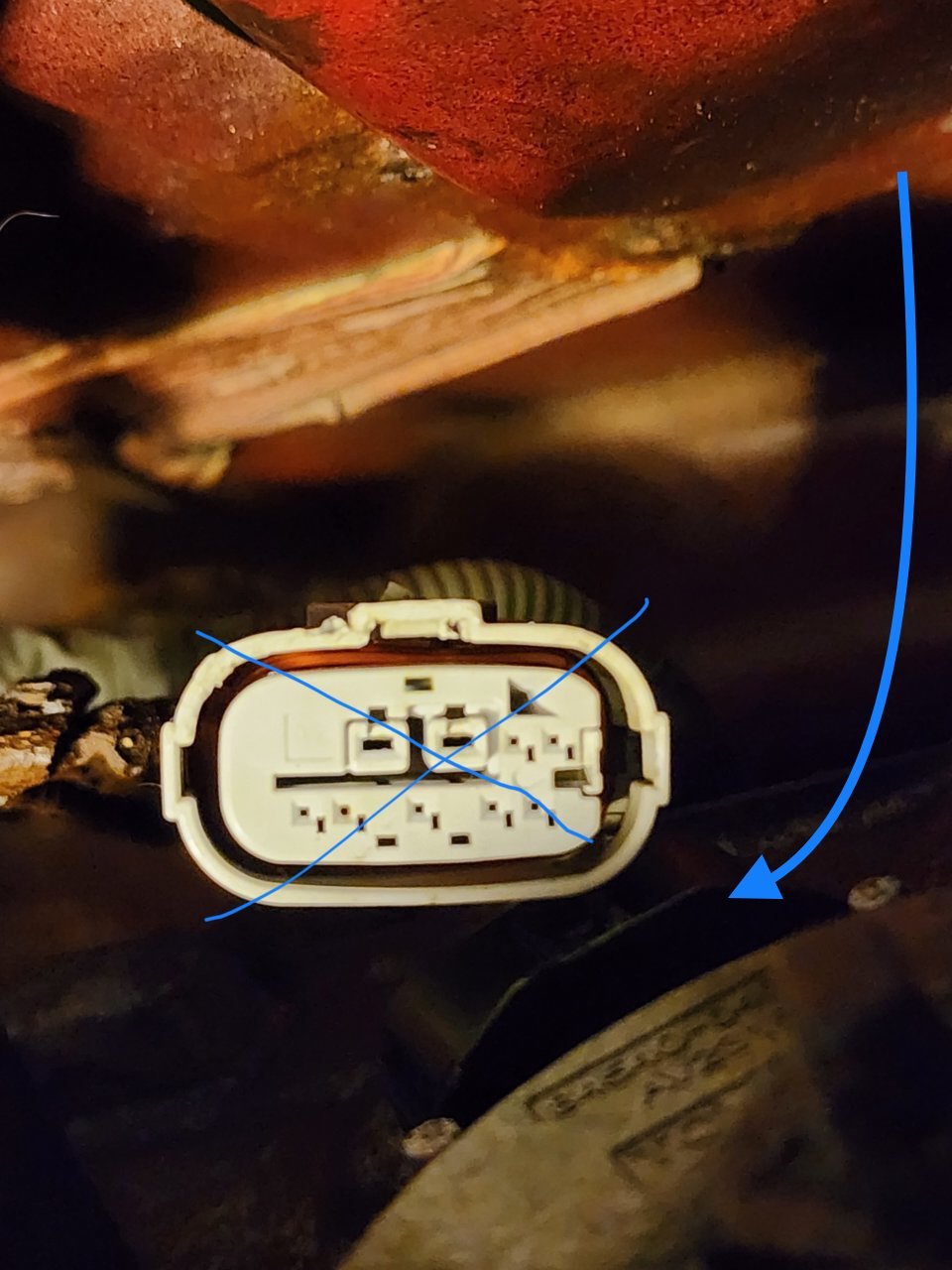

    You don’t test that plug.
    You test the one bolted to the truck.

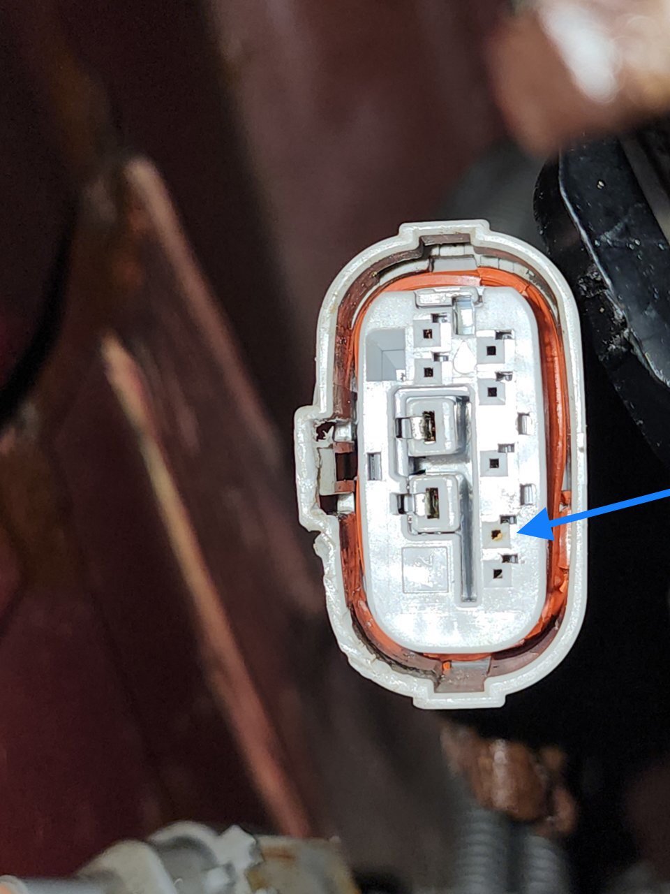

    At least you’re trying. Most guys wouldn’t even look.
    BTW, I see signs of brown crusties already.
    I’m not saying that’s your problem, but it’s good you got to it early.
    Plus, your weather pack seal is shot. We can worry about the seal later.
    Brown staining - Possible issue.

    Again. You are not test the plug with the “X”.
