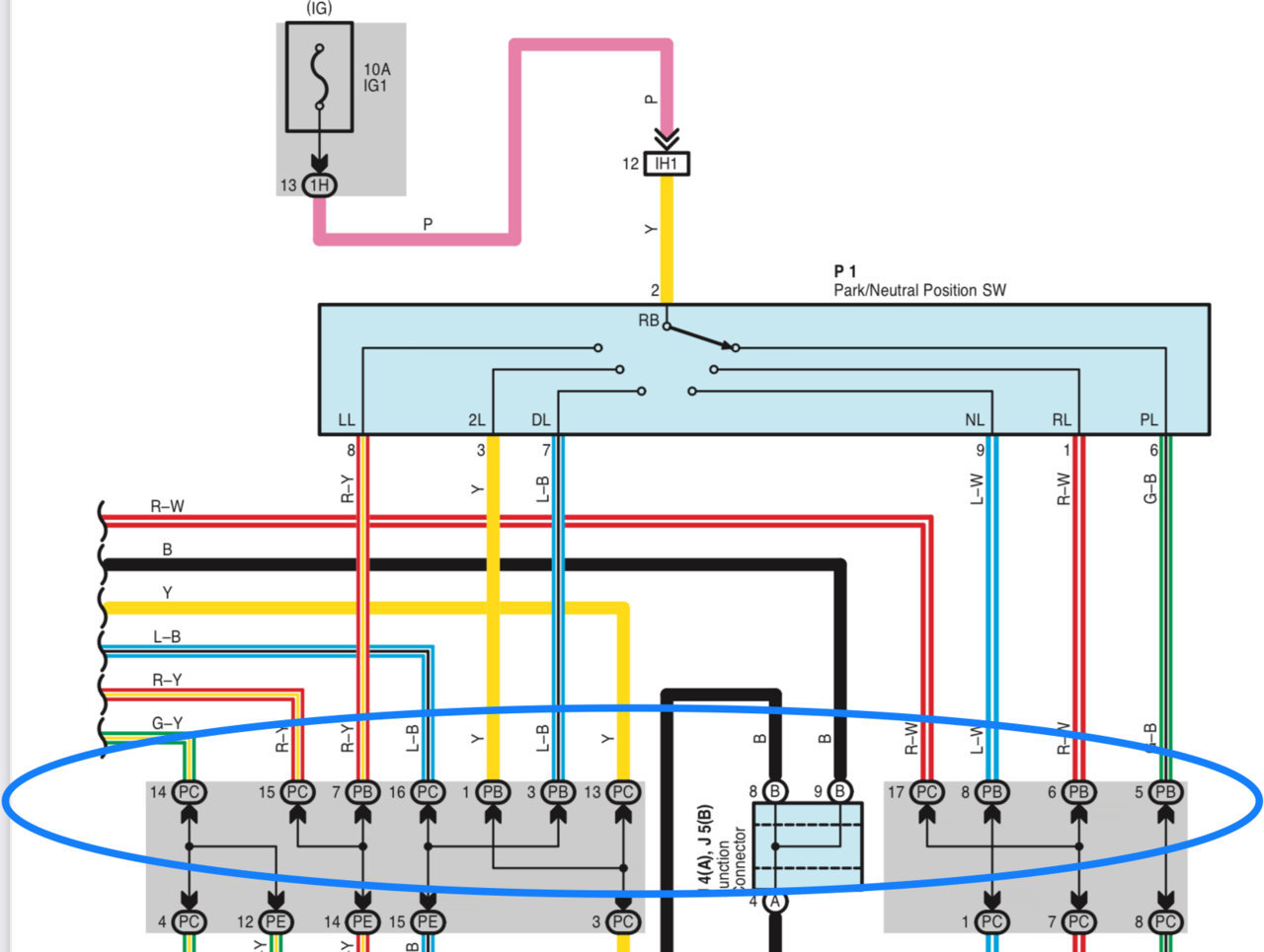

    Colors may be different as that post was for a 2012 and yours is an 06.
    I can look up the right colors later.
    Use a paperclip, needle or backprobe to check the pins, don't shove your meter leads in the connector.

    I posted the colors earlier.
    They are for the 2005-2008 trucks. OP has an 06’.
    We should be good.

    Here they are again.
    I circled them.

    I don't understand how to read the diagram

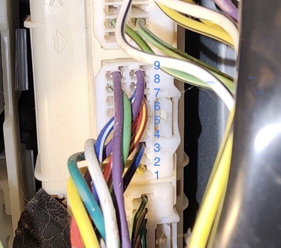

    BTW, I looked at you connector.
    From what I can see, you wire colors do match the diagram I posted.
    I am working on labeling them for you.

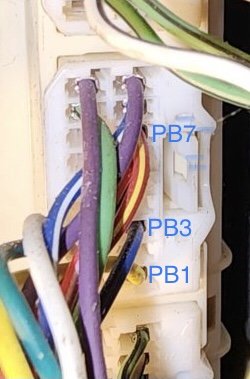

    PB1 - Yellow
    PB3 - Blue/Black
    PB5 - Green/Black
    PB6 - Red/White
    PB7 - Red/Yellow
    PB8 - Blue/White
    The PIN numbers start at the bottom and go up.
    1 is bottom right. 9 is top right.
    I label the pins of the one I can see clearly.

    Never mind my previous post.
    Let’s DO check voltage.
    You should see 12v where it say “Below 1 ohm”.
    And no voltage where it says “10k or higher”
