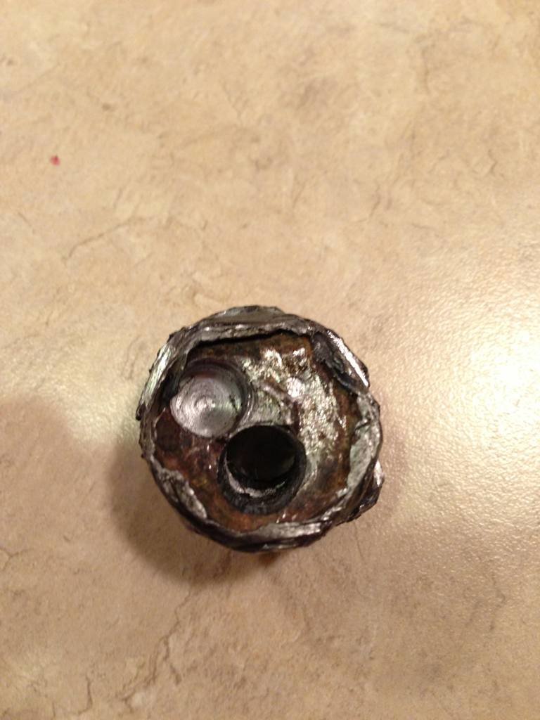

    I feel you. This was the fill plug on my manual. u9uhyqa5_3dc0a201b1174843a85dfca929da91272f26a21e.jpg

    :hungry:
    looks like meatball :)

    My god! How can you fuck up a fill plug that badly?
