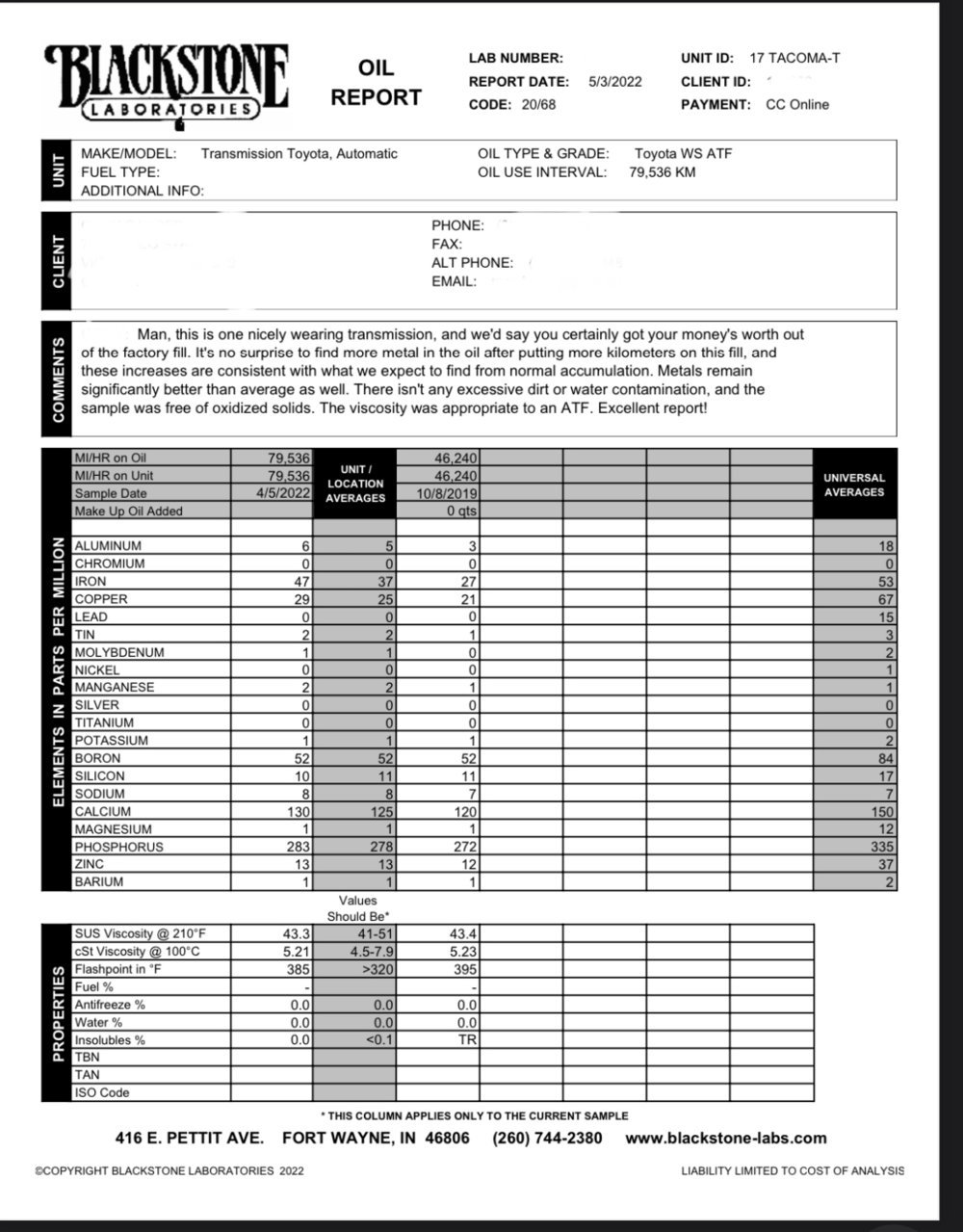

    Here’s my latest result for the curious. Did a drain and fill so sent it a 2nd sample for heck of it. These results are from the factory fill after over 79kms. No news is good news.
