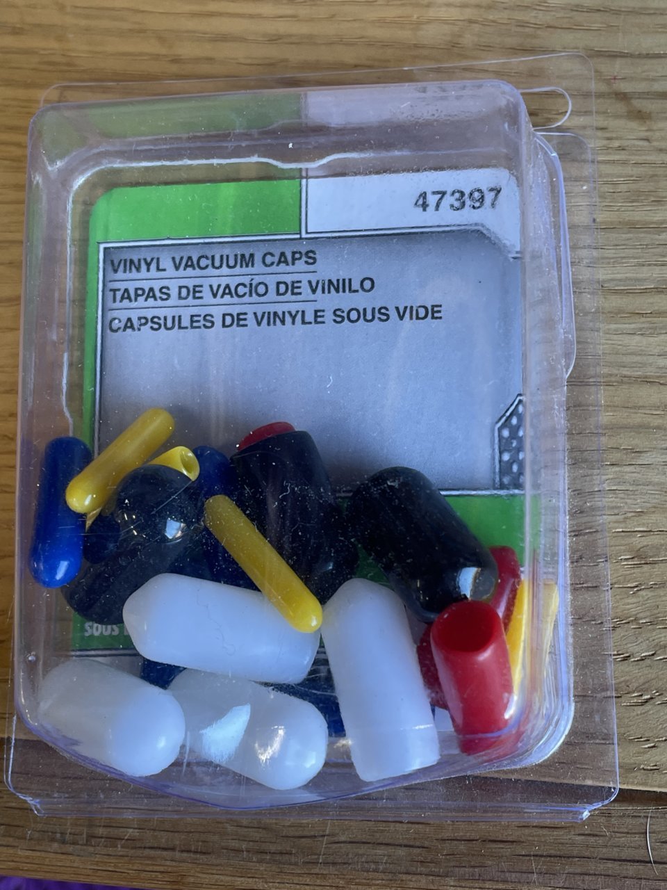

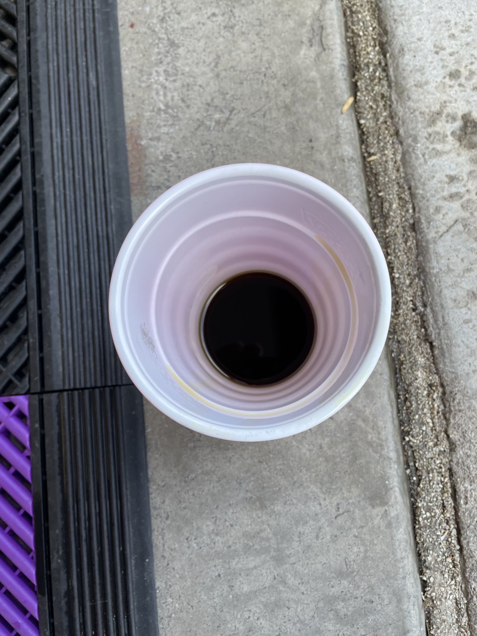

    A bit off topic, but I've been going through and doing all the maintenance front to back on my truck. (coolant, brake fluid, radiator hoses, serpentine belt, air filters, driveline fluids, ect.) This might be applicable to others.
    FWIW, I flushed the power steering fluid last weekend with a little over two quarts of dexron 3 atf. This was the old fluid after 6+ years, but only 18k miles.
    With the front of the truck on jack stands I carefully pulled the bottom return hose off the plastic reservoir and stuffed it into a sports drink bottle; then I plugged the reservoir with a black Dorman vacuum cap. One full turn to the left or right will drain about half of the reservoir, so you'll have to keep topping off with every max turn (completely to the left or right) to avoid introducing air into the system.
    I'm going to look into installing a larger aftermarket power steering cooler (Hayden or Derale) and filter (Magnefine) for the 285's and 2.5 fox coilovers I'm installing soon.
    https://www.amazon.com/Magnefine-Ma...ower+,aps,151&sr=8-1-spons&smid=A33WFIG7XLWS7
