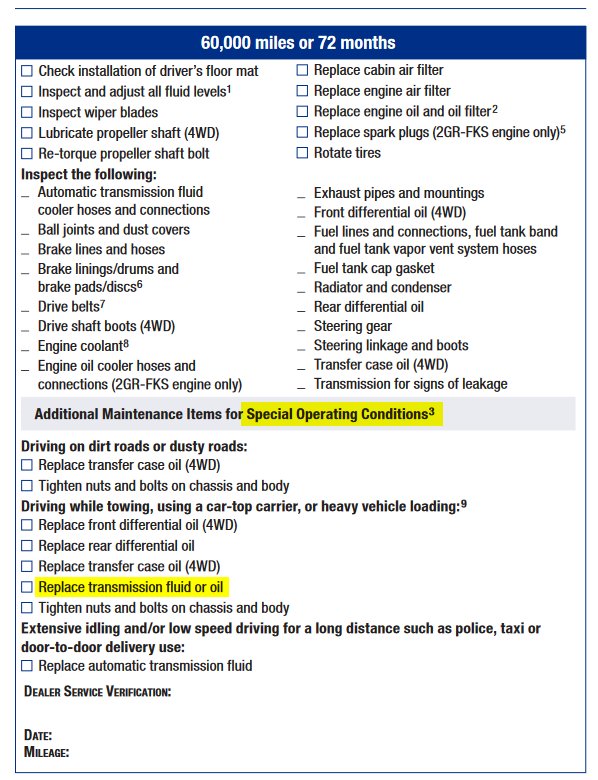

    Owners manual says never - unless you're under heavy duty use (towing or off roading). Sealed transmission unit. I hope that is a trend that goes away though, I haven't heard about Toyota going back but if they are I'll be happy.

    It only ever comes up as replace for "special operating conditions", otherwise it's never replace. And the special operating condition is only when you're loaded/towing.
    So, according to Toyota, in my owners manual, unless you tow, you should never touch your ATF. The Toyota ATF WS also doesn't have a change interval defined, since it's intended to be in a sealed transmission for a lifetime.

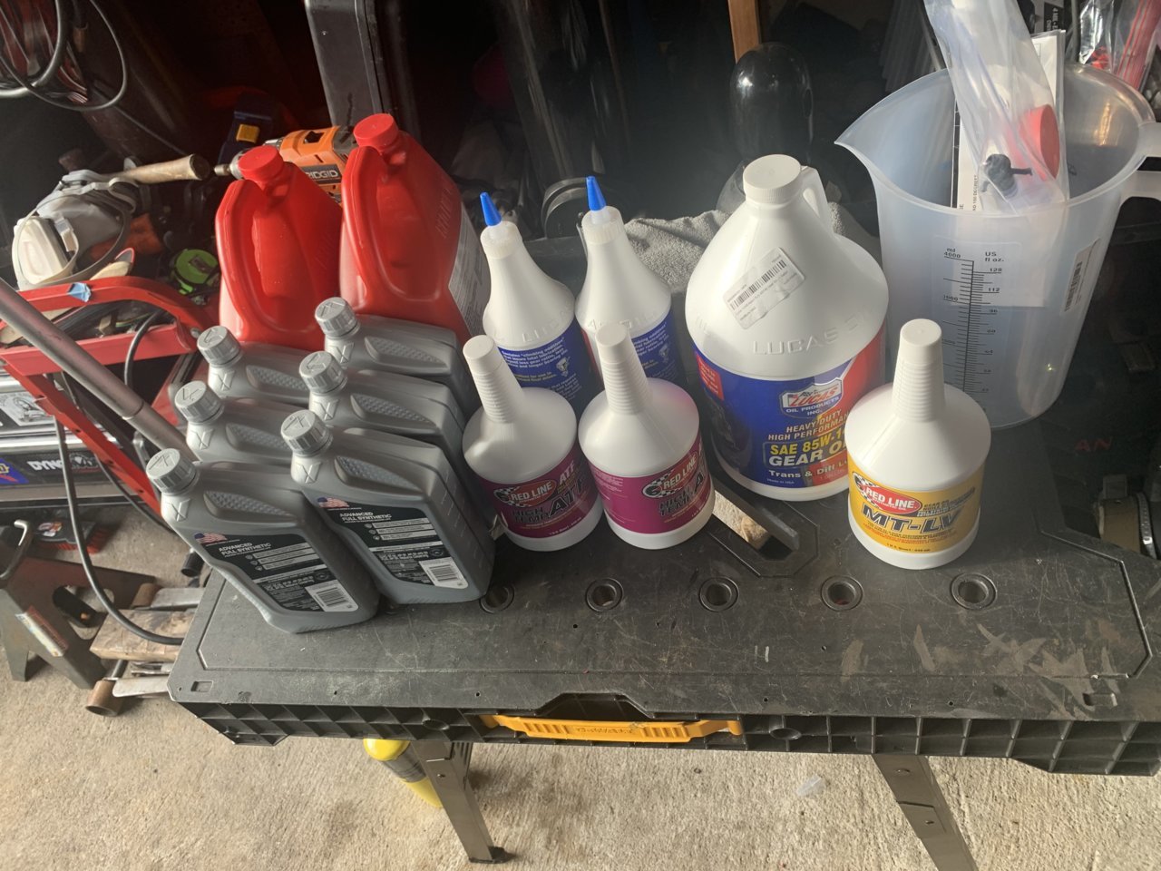

    Side note looks like I got two quarts of the wrong ATF. I got Red Line D6 (2 gallons) and 2 Red Line high temp ATF. Oops. So only doing three drain and fills not four. I debated using the high temp since it’ll be diluted quite a bit at the end. Maybe I still will if I start with it. Haha

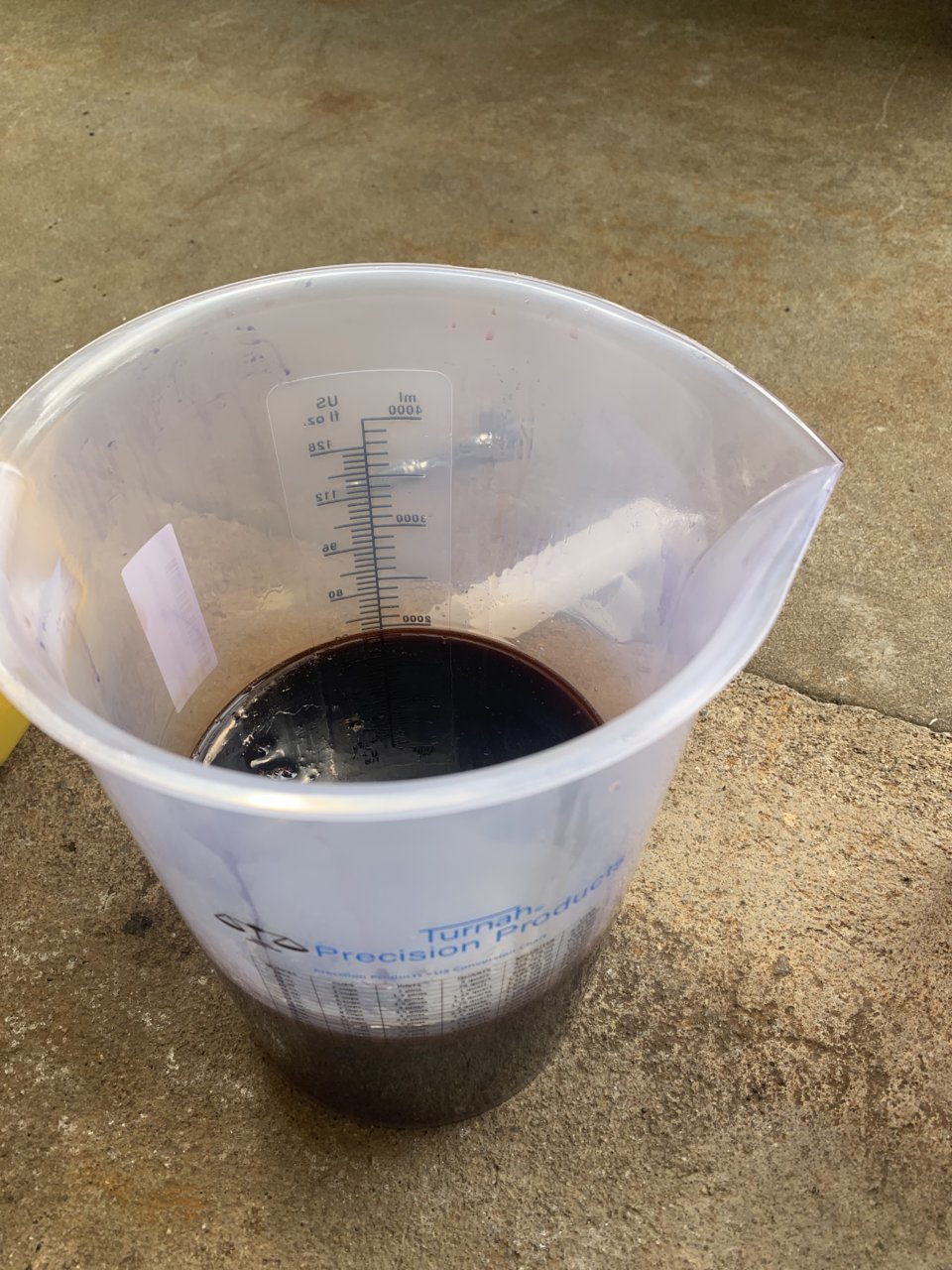

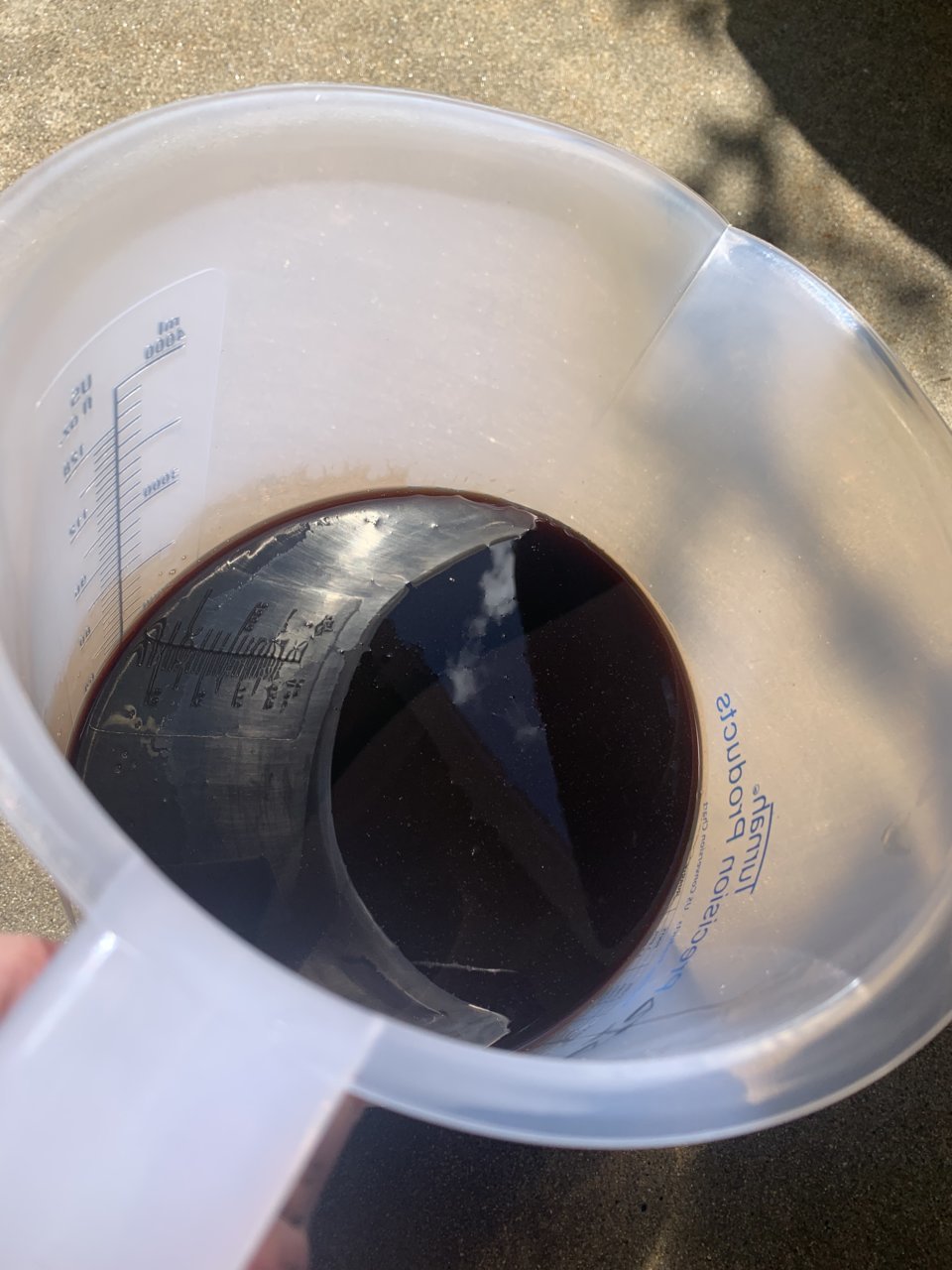

    Done. Easy but holy tedious. Also did engine, t case, and both diffs. Filled a six gallon jug+.
    Fluid was pretty dirty. Saved a bit for a black stone analysis. Obviously never got it bright red but it looked a bit better once done.
    First drain
    Fresh fluid
