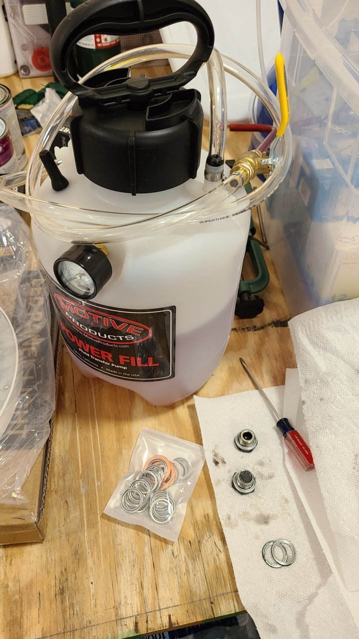

    I ordered the motive power fill last night. Those slippery Pete pumps seemed to work intermittently when I did the diffs and transfercase.

    Yeah, 2 gallon is taller. I figured it would be easier to refill the 1 gallon as needed rather than fight the taller 2 gallon container working under the vehicle. Guess I find out soon enough.

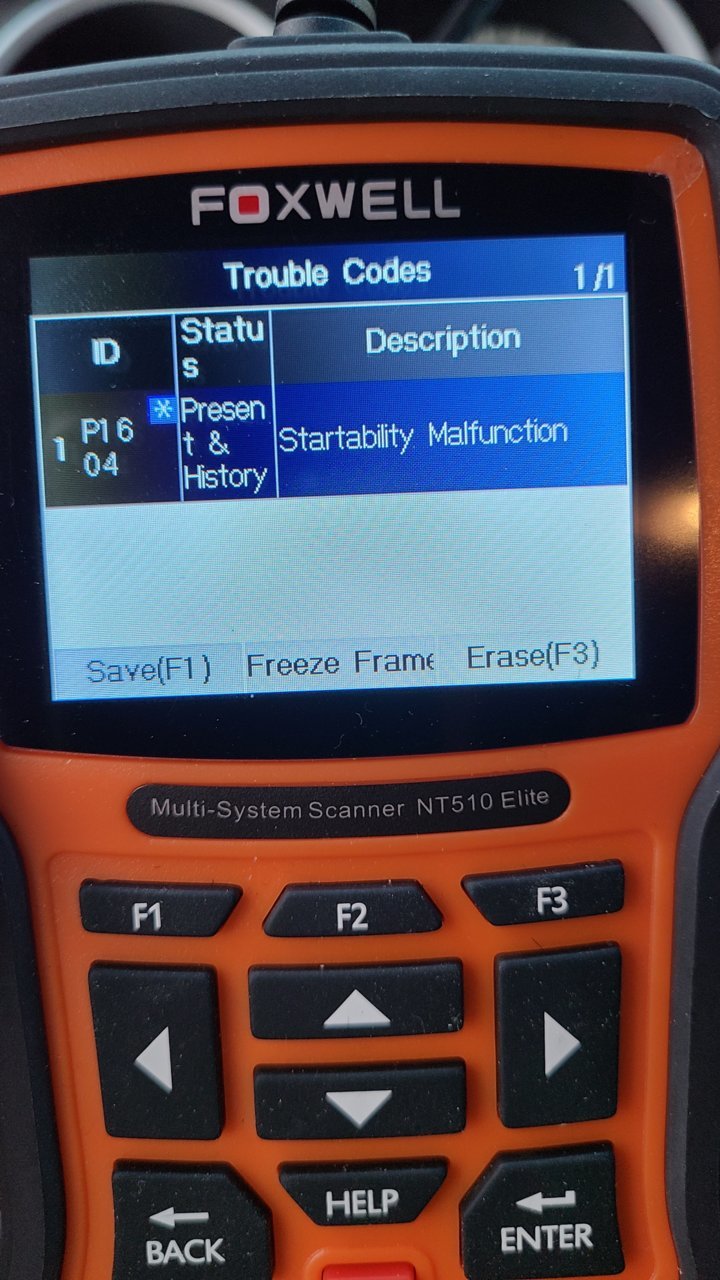

    I got the Foxwell. It has extra capabilities for Toyota and Lexus. I think you can get them for different makes too. Works great.
    MGMDesertTaco[QUOTED] likes this.

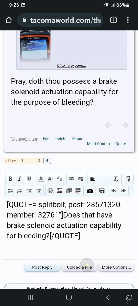

    Does that have brake solenoid actuation capability for bleeding?
  20. Apr 1, 2023 at 7:27 AM
    #80
    splitbolt
    splitbolt Voodoo Witch Doctor
    Mar 7, 2010
    #32761
    7,858
    NW Arkansas
    2016 TRD OFFROAD DCSB MGM
    Really?:rofl:
