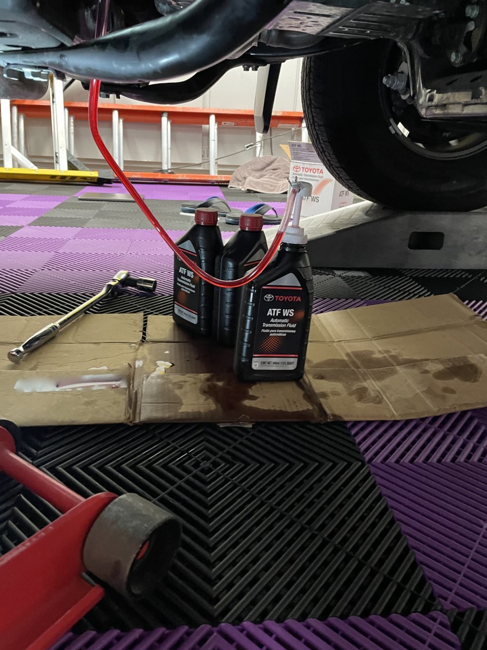

    I sent the motive power fill back. The red metal filler attachment wouldn't stay put in the shut off valve. Hand pump with some longer hose it was. :annoyed:

    Haha. Isn’t it fun! I did mine in the driveway. Stopped paying attention on one pump and the hose flew off and the entire pump went into the puppy pads I had down. Lesson puppy pads don’t absorb trans fluid and it just rolls off onto the driveway. :rofl:

    Puppy pads and cardboard? :rofl:
    Why you guys no drip tray?
    erok81[OP] likes this.

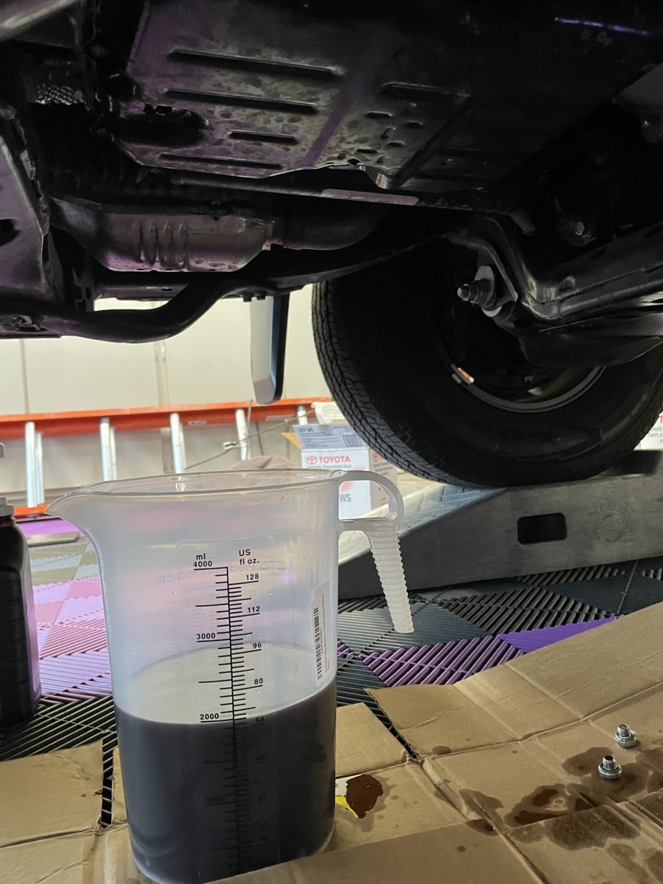

    Just did mine yesterday. found a birds nest on top of the trans that filled a five gallon bucket.
    The D&F took 2.7 quarts of fluid. confirmed with a code reader @ 100*f.

    Puppy pads/cardboard = throw away
    Drip tray = extra clean up time
    I’m lazy.
