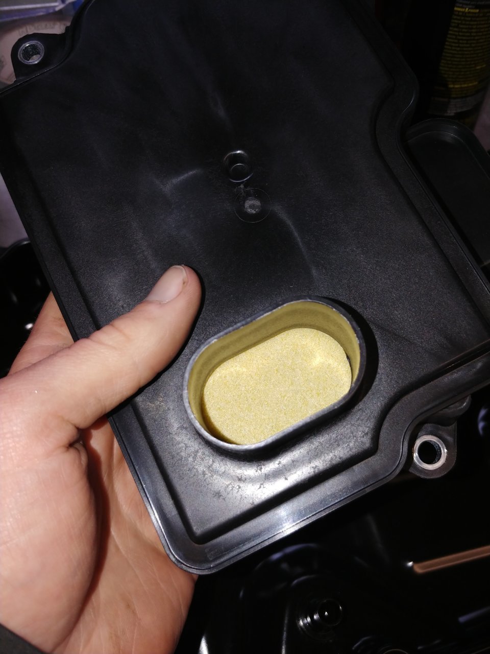

    Working on my buddies 3rd gen this past weekend - it was interesting to see they have more of an actual filter material in the strainer. The 2nd gens is very clearly just a mesh strainer, but this seemed to have some paper/cloth element to it.

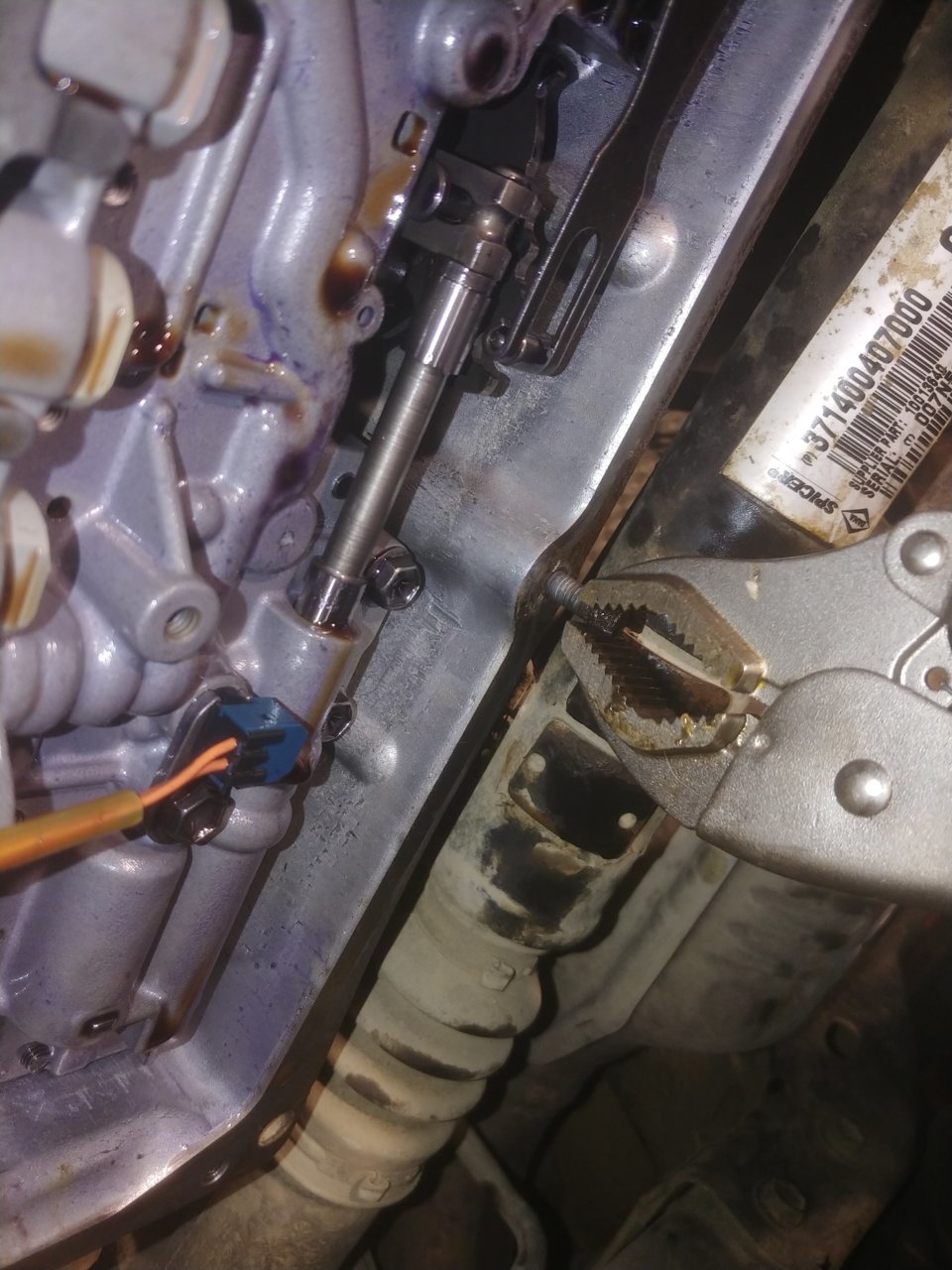

    Also note if you live in the salt belt the tops of the pan bolts are exposed from above. Take your time and use lots of PB or else
    *pic is of the new Beck Arnley aftermarket filter he bought.

    those vice grips on the bolt threads are making the mechanic in me cringe.
