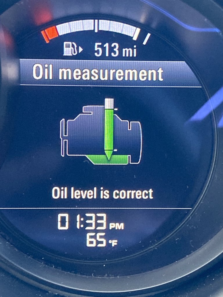

    the oil level is easier to check on our macan than the Tacoma with the impossible to read oil level on the dipstick…
