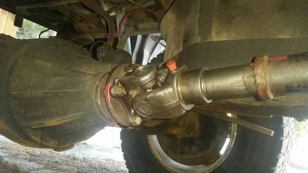

    [​IMG]look like this. the red cap on the photo is the grease fitting

    Oh lol yeah I saw that when I did the u joints. I thought you meant ON the diff.

    6”rough country lift, 35” bfg mud terrain, step bars, home made solid 5" bull bar frame mounted top and bottom with gussets ( used an excavator to completely suspend the truck in the air held only by the bull bar), 180k, no rust, no leaks, no cel's, no issues. 4wd conversion with front and rear e-lockers.
    Old thread but adding if youve never greased that slip joint before, they take an abnormally large amount of grease to have them not make noise or move.. im talking when i tested mine i was able to make that joint move a little by hand. About 30 pumps of grease later it finally stiffened up and been good since.. but it aint like the half a pump you put in the cv joints before you pop a seal.. this youre filling up the whole section of the shaft.. kinda..

    This is actually bad advice. Filling the entire void in the slip joint is going to cause problems- it will feel like a jolt or axle wrap. Essentially the joint will be hyrdolocked in place and not be able to move. The real solution is to disconnect the drive shaft (make GOOD marks across the slip joint and shaft) and separate the two pieces, then apply an adequate coat of grease to the splines. If you have filled up the joint in the past, then take a long screw driver and remove as much of the grease as you can.
