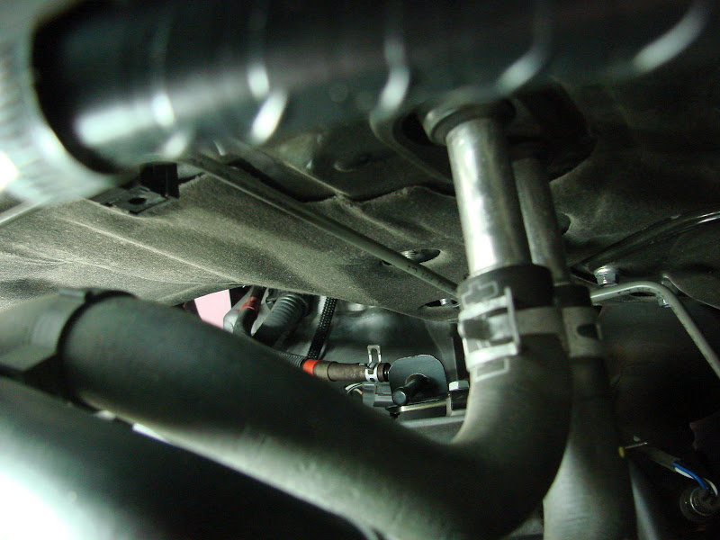

    I have tried to find this before. I studied some documentation from Toyota but I never concluded that I found it.
    I think the only reason to extend it upwards is if you're going to submarine your truck and you don't want water to get in there. :notsure:
    Is this it? In the picture the hose with the red band on it?
    Looking down from the top of the engine bay firewall is at top
    This pic was a MF to take. :D

    Well hopefully the pic I posted will help the OP.

    The photo is good and what I found also. So then, is this just a metal tube with a cap on the end and a hole drilled into the tubes side? It appears and feels like that, but I have not removed it yet to relocate or put a filter on it.
