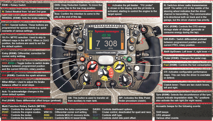

    Paddle shifting, funny how you can now be a world class race car driver while playing a video game. Literally.
