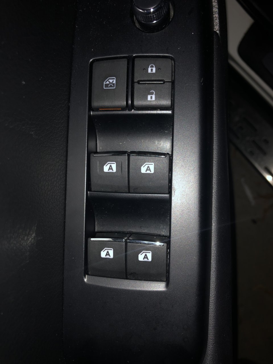

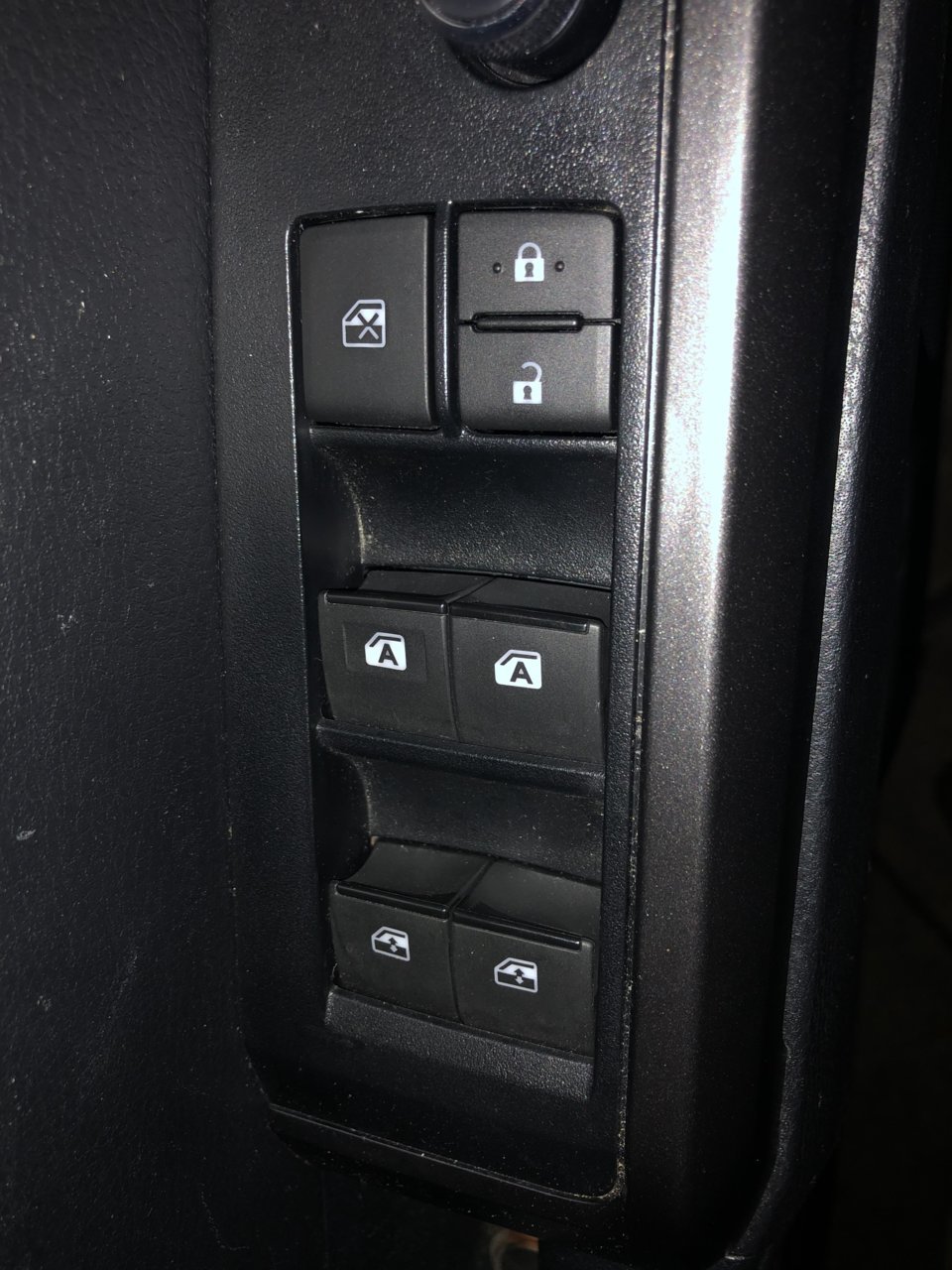

    2018 DC SB OR AT (Sold)
    Highlander
    Tacoma
    Appears swappable to me
