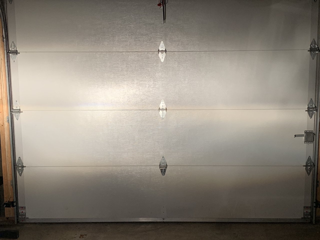

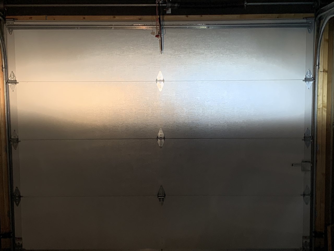

  16. Nov 15, 2019 at 4:55 PM
    #36
    crashnburn80
    crashnburn80 Vehicle Design Engineer
    Jun 6, 2015
    #156893
    14,752
    Kirkland, WA
    2003 DCSB TRD OR
    When activating the high beam, the low beam remains unchanged on the dual light 3rd Gen.. The high beam puts a focused hot spot just above the cut off to extend the forward distance projection while also having less focused wide area light for general awareness illumination. Examples below.
    High beam plus low beam (driver only)
    Note the 2 hot spots vertically stacked very close together.
    High beam only (driver and passenger)
    Stock vs Hikari LED
    grubburg likes this.
