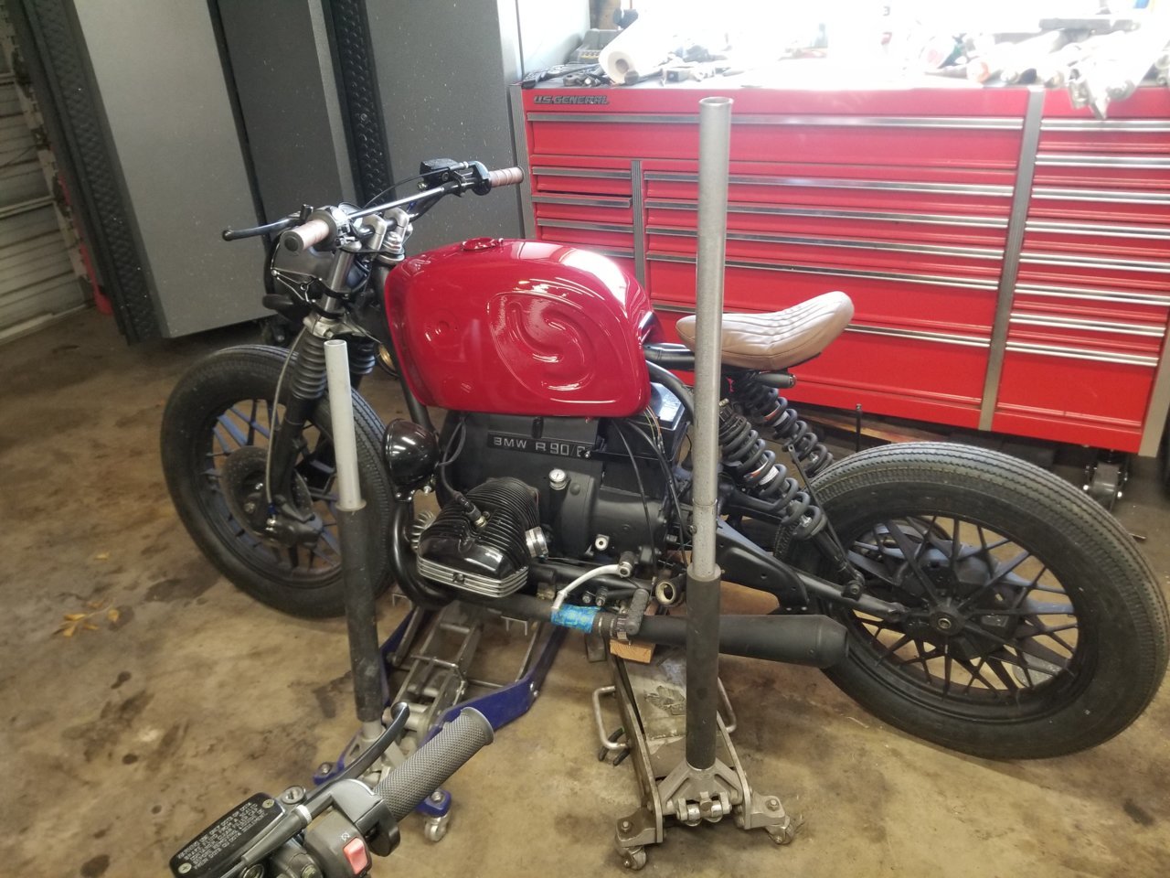

    Here's a teaser of the tank I just shot. Need to color sand / polish etc. Tomorrow20210202_141914.jpg

    cool. I may give it a whirl eventually. I just did my flatbed and frame with some Rustoleum farm implement paint and I think it was just too thick for my spray gun, but it did make it onto the frame, so I'm calling that a win. I'll have to fine tune it better if I want to paint something that is actually smooth :laughing:

    You should send that bike to me for closer, uh, inspection. :spy::D

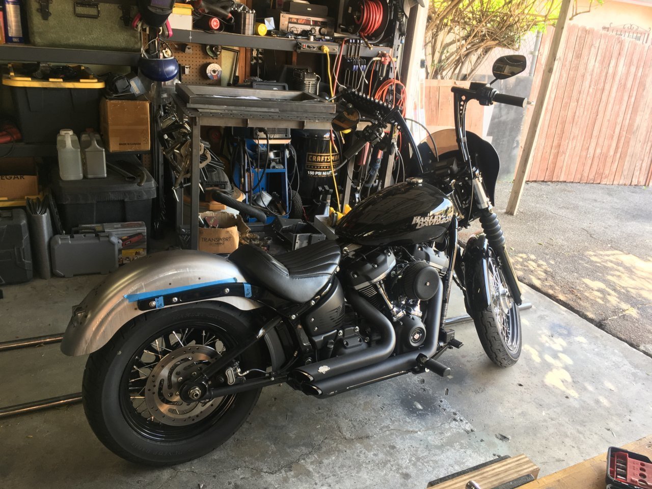

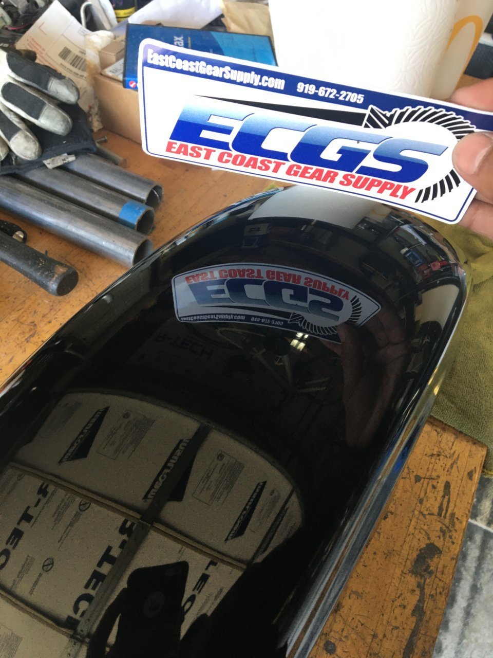

    Here’s my most recent paint job. Added a FXR fender to my Softail. Body working and plug welding holes then smoothing everything out to get the black to match up as seamlessly as possible.
    Used a repop fender with all the extra factory holes and wrinkles left over from stamping

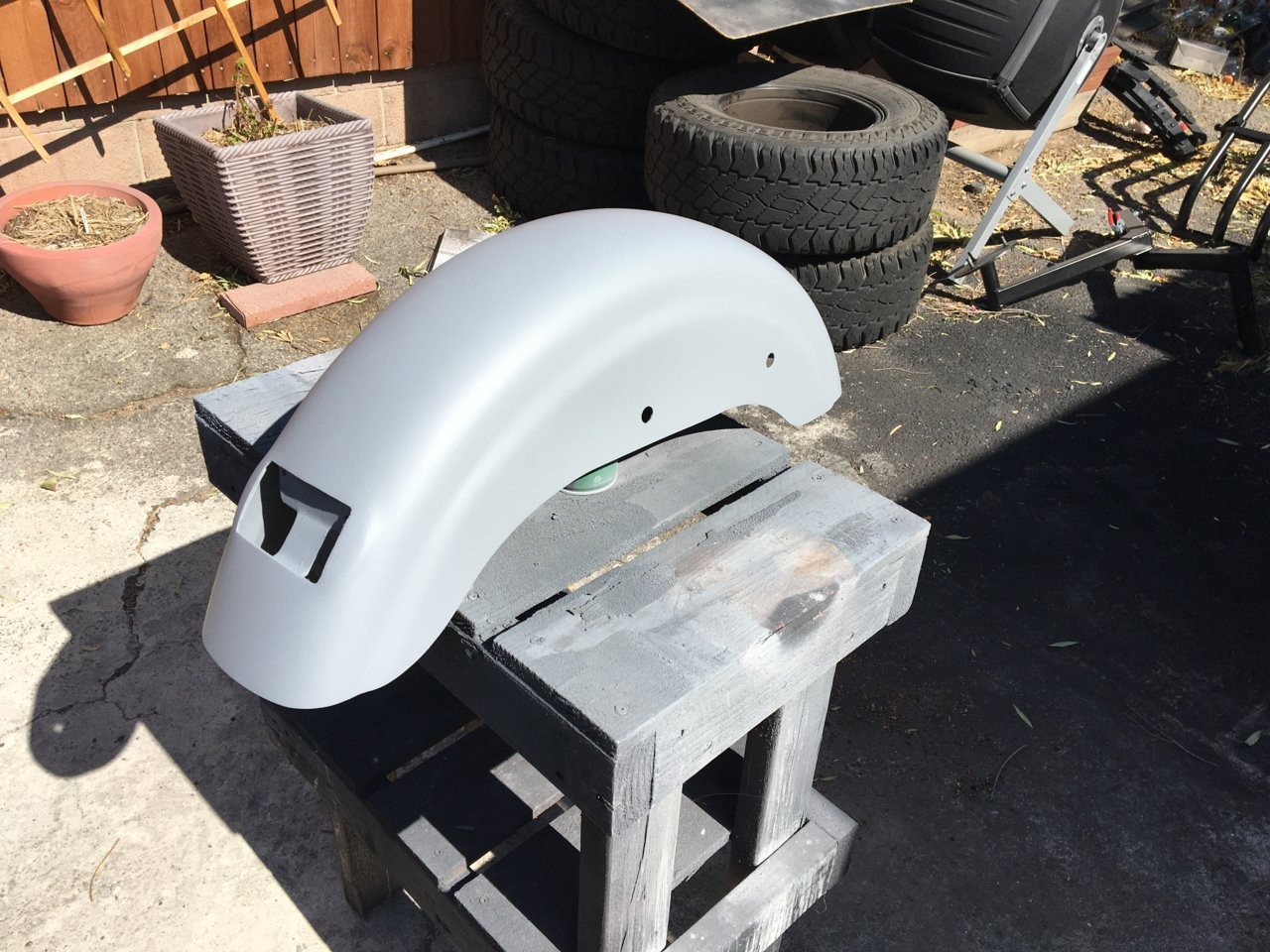

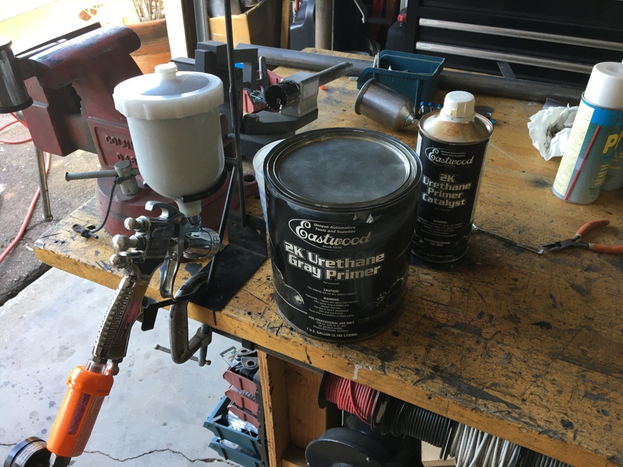

    My primer setup
    Metalwork, primer, filler, sealer

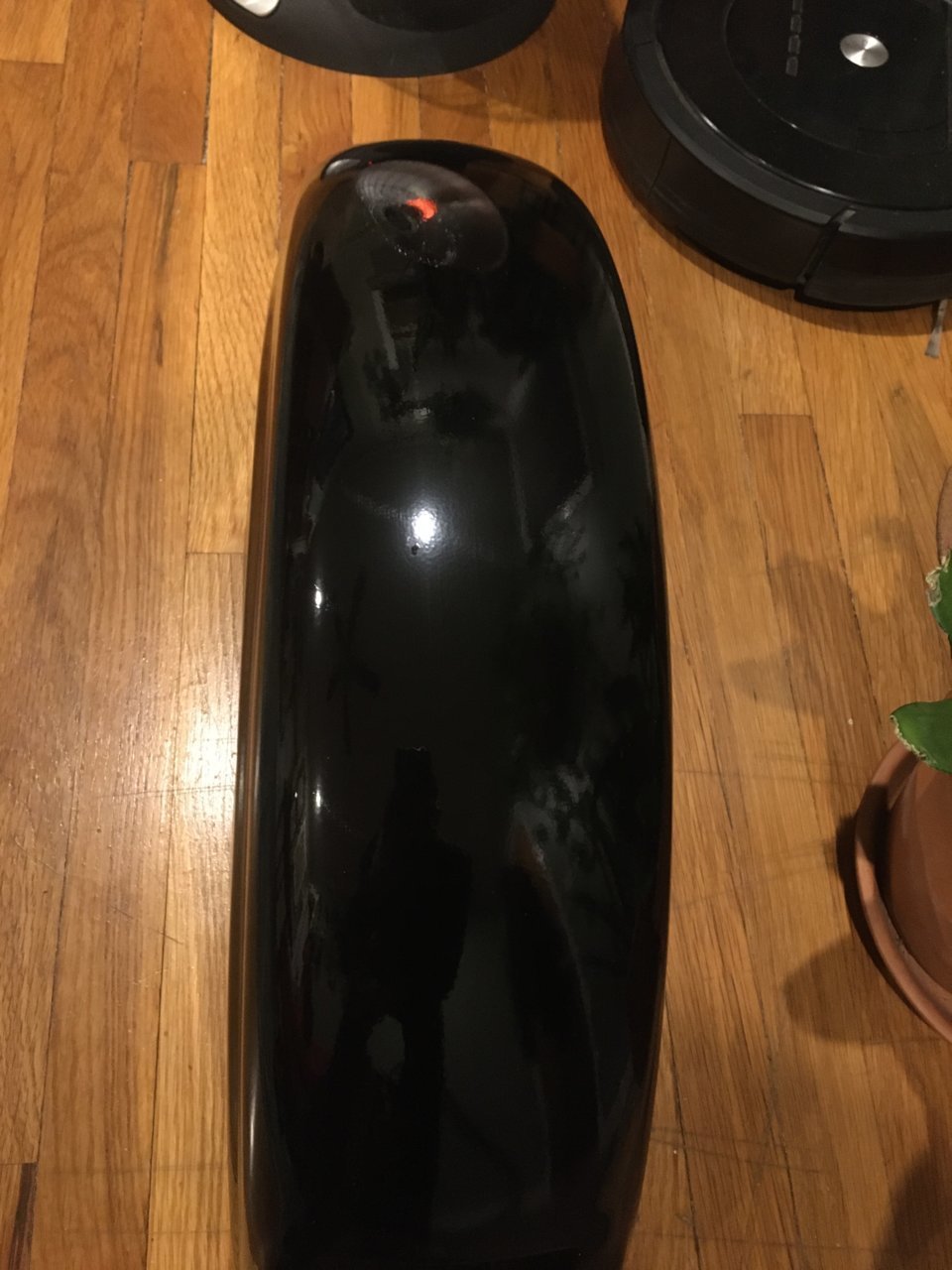

    6 coats of black and some slight orange peel
    Color sanded and polished out used my ECGS sticker for the reflection test 8289478E-0C20-4578-9AA8-1183E7D2C5DC.jpg

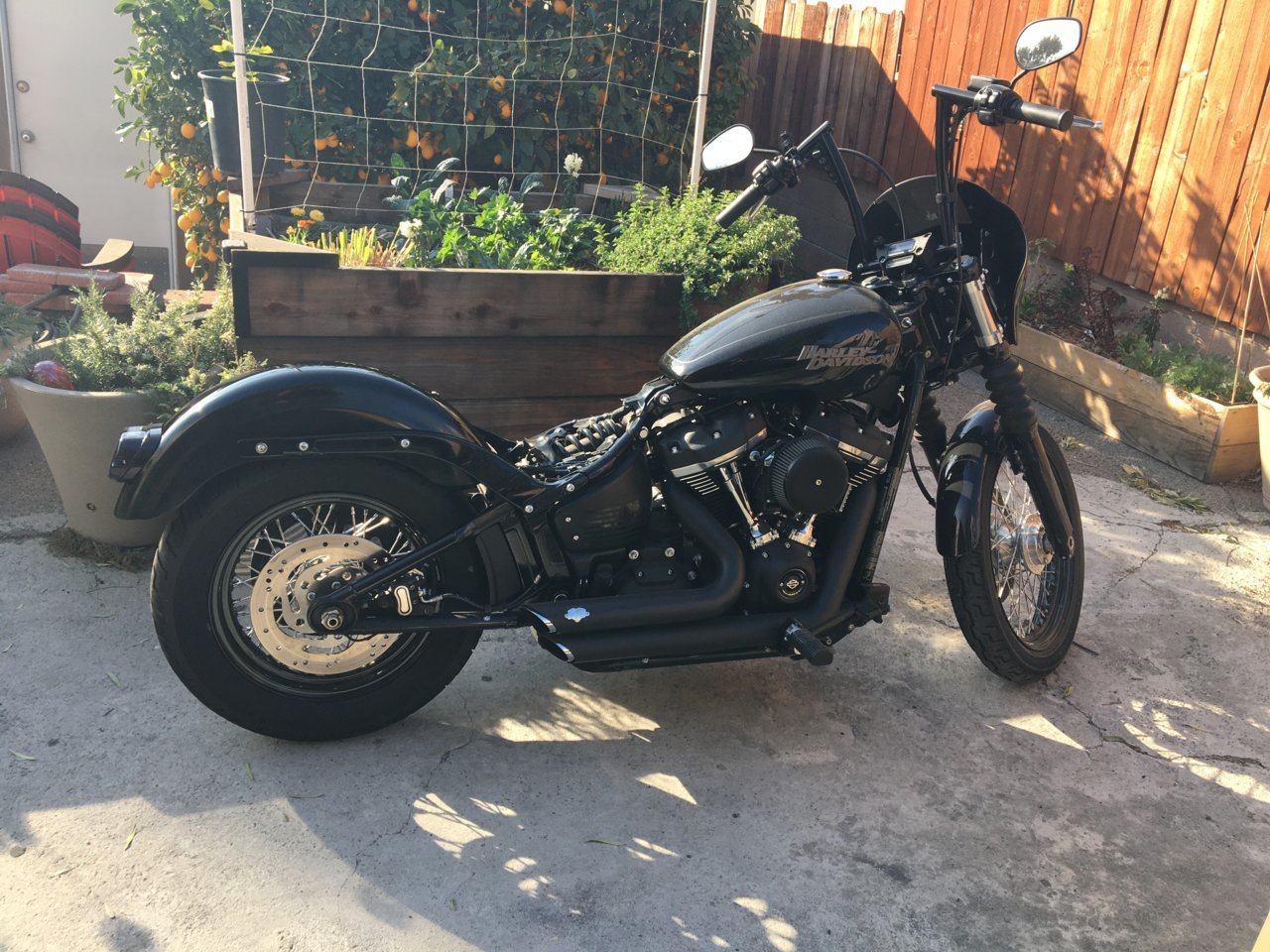

    All mounted up
    All that work for something that looks factory.

    I have bought some aftermarket sheet metal parts for motorcycles, that stuff is not fun to try and get smooth, and black will definitely show every imperfection. Thats always something that surprises me is that the brighter colors hide more imperfections than dark. That fender came out looking perfect, that last polish must have been sooo satisfying.

    Knowing that black will show every imperfection, I spent a day sanding at each step. From the filler primer, to primer, to sealer and finally paint. I didn’t track the hours but people would be amazed at the time it took for a single fender.
    It was supposed to be a quick job and I had originally planned on mounting the fender without color sanding/polishing it. Once it was done I just couldn’t leave it alone and knew it would bug me so I went back after it for another day. I’m glad I did because people still can’t tell I did anything at all.
