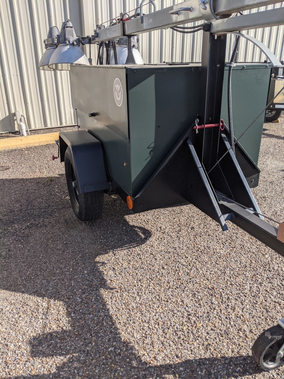

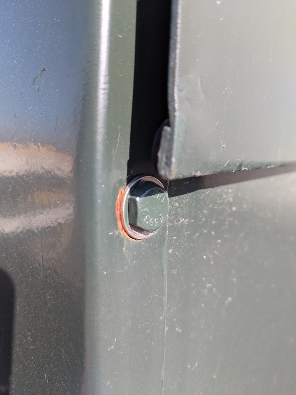

    I painted this light tower 2 years ago with rust-oleum. I didn't have enough of one color to do the whole thing, so I mixed blue, yellow and black.
    This is the ratio I use:
    5 parts rust-oleum
    2 parts acetone
    1/3 part hardener
    This is all the rust I have found so far
    All the black parts are painted with POR15 and POR15 top coat, applied with a foam brush or roller.

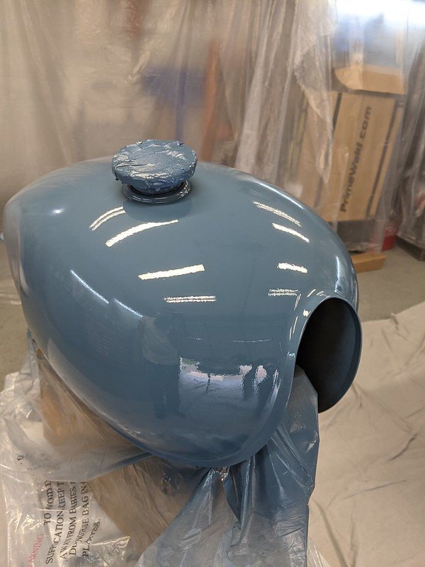

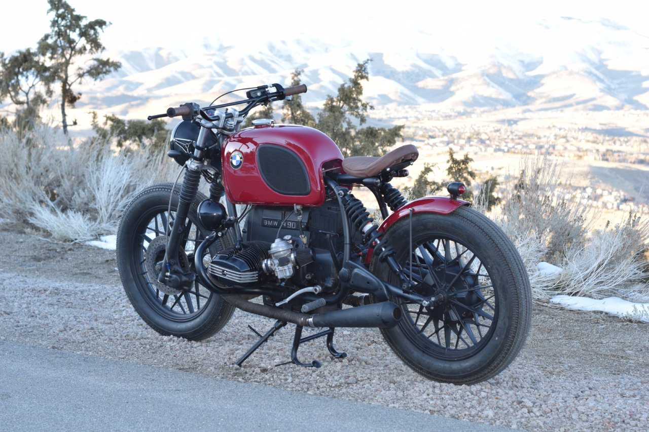

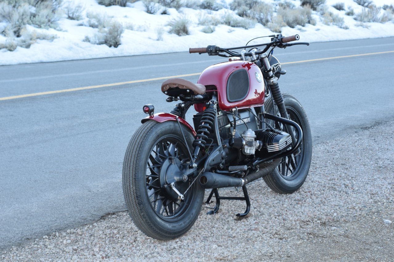

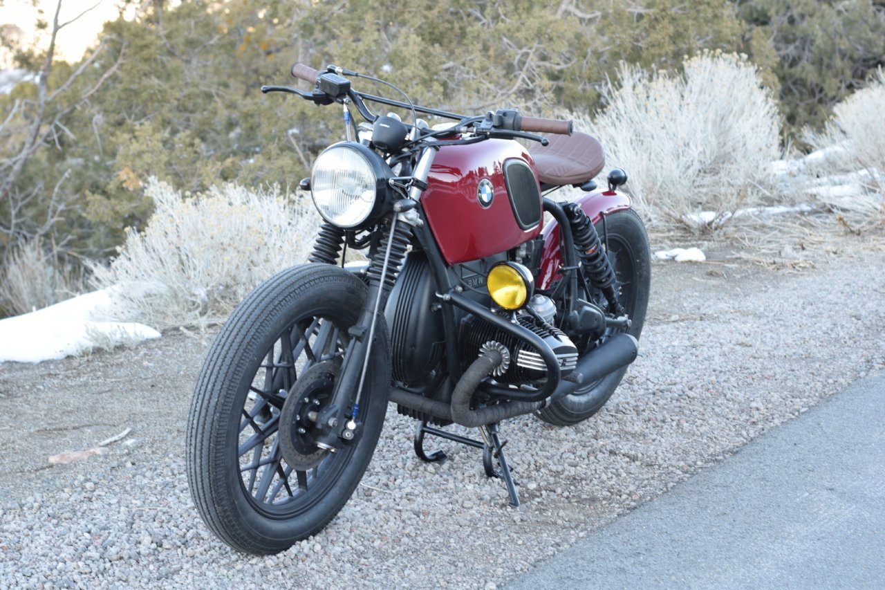

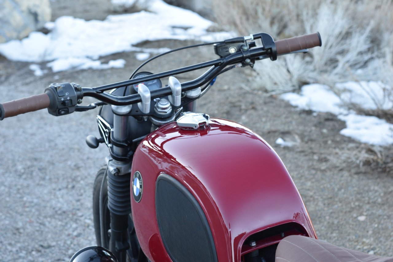

    Here is the finished tank I was working on. Turned out great, still have to do final polish, you can probably see some cutting compound here and there as I havent done the final detai.
    shakerhood, uurx, EdgemanVA and 2 others like this.

    Wow she is sharp. I love the look of a cafe racer style bike but at 6’4” 275lbs I just don’t fit well or I guess I don’t look right on it. Good looking work.
    excorcist[QUOTED][OP] likes this.

    That’s a great looking bike. I’m in the middle of building out my XS750 as well.

    haha, yeah I can see where you are coming from, as you may know once you start dialing in a bike for a guy your size you have to sacrifice some aesthetics it seems.
    :hattip: Thank you, I appreciate that. It has been quite a bit of work, but I am very happy with how it turned out. Id really love to see the XS when its done, never owned one of those but always have liked them.

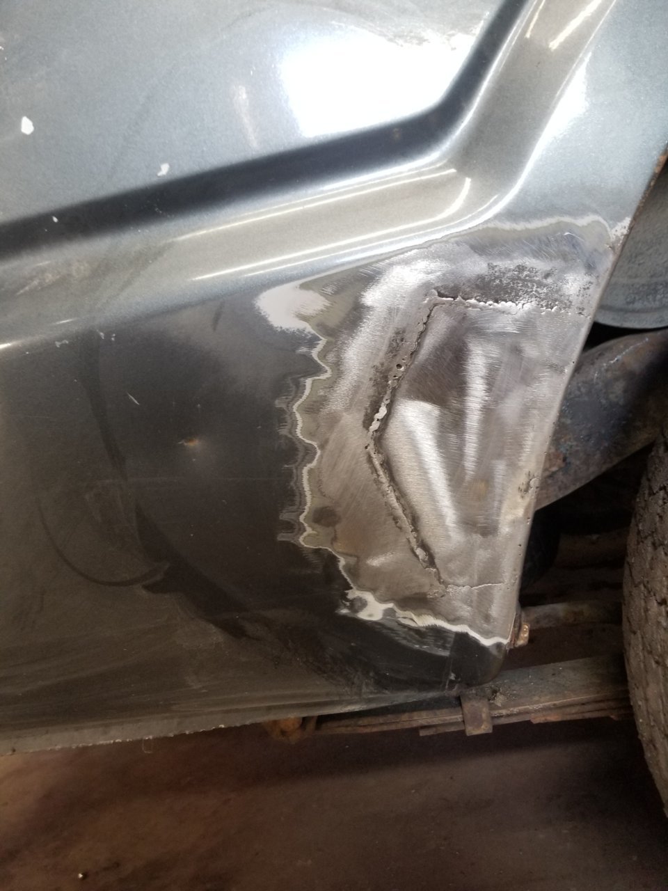

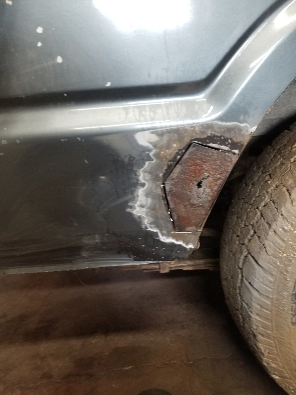

    Getting some rust fixed on the fj62 I'm repainting
    shakerhood, Daves300 and GHOST SHIP like this.

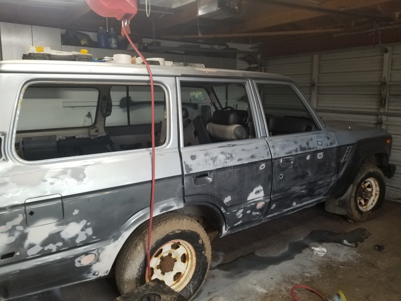

    Getting work done on the fj62... hopefully will be posting completed pics within a couple weeks20210405_184756.jpg

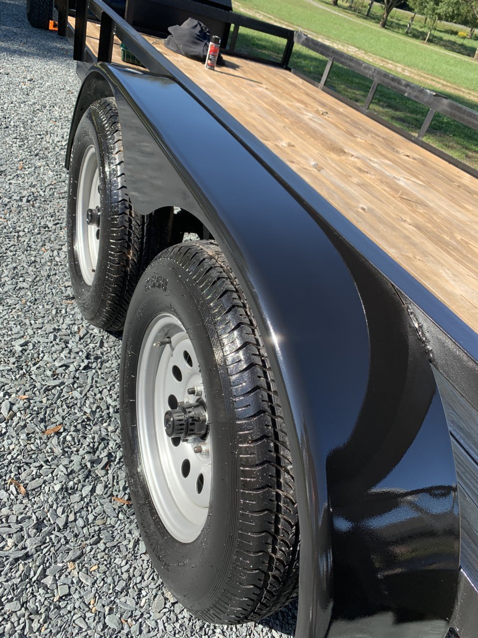

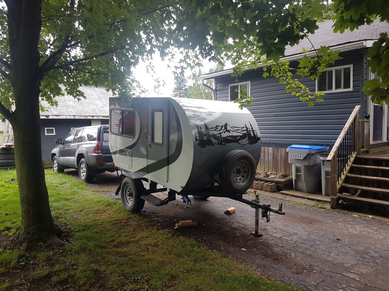

    I painted my trailer. Fenders were done with a can. Rest with a brush.

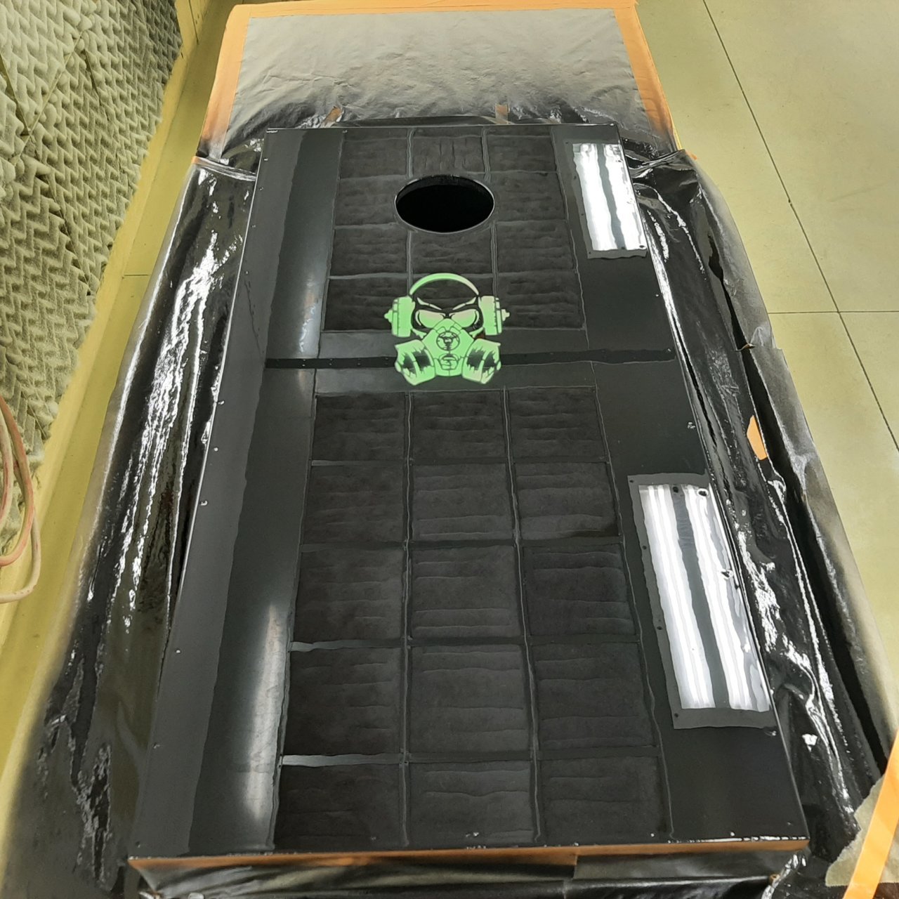

    Ive been a prepper/painter since I was out of High School,and I love sharing my (old school) knowledge.
    A few things I can impart to everyone dabbling,trying out, or becoming a novice Bodyman /Painter.
    1. Prep is 90% of your bodywork/paint (especially paint)
    2. Be detailed oriented,humbled,and willing to learn.
    3. Always shoot for 100%, if its not right,stop, do it over.
    Here are couple of corn hole boards I painted for the kids at work
    excorcist[OP] likes this.

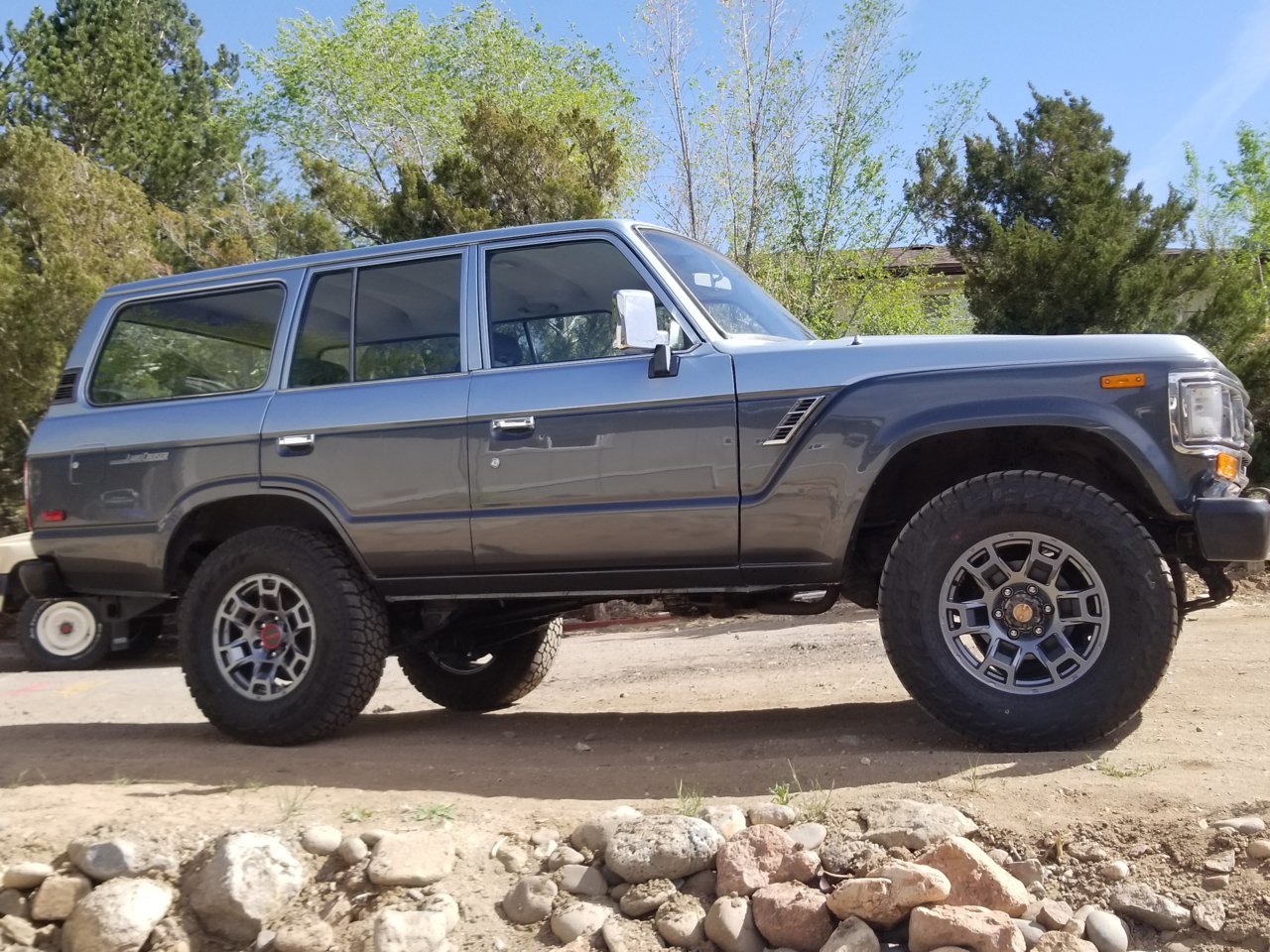

    Im done with this land cruiser, It turned out amazing. First whole care I have painted. Will have some good pics posted up soon. I have been daily driving it the past few weeks.

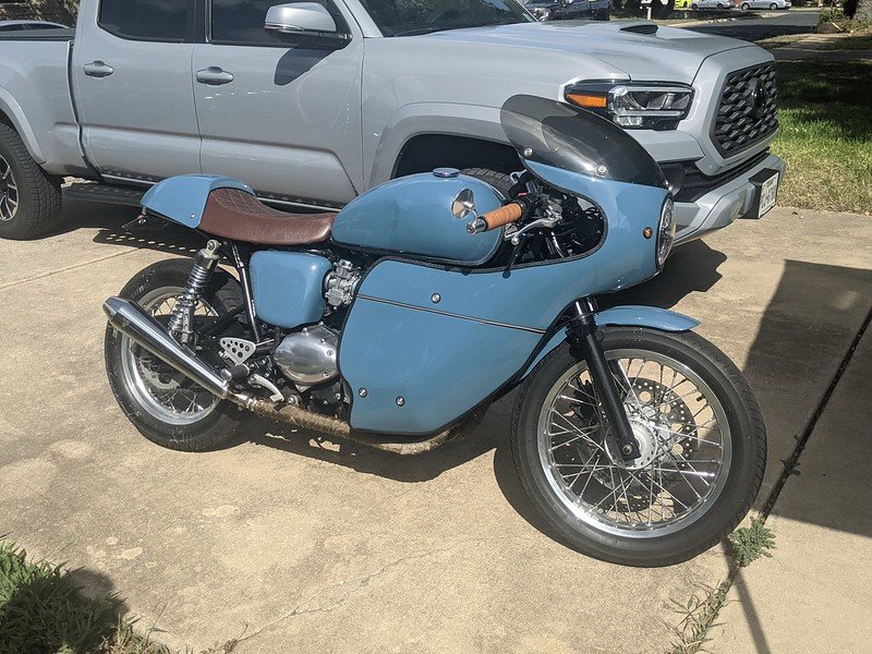

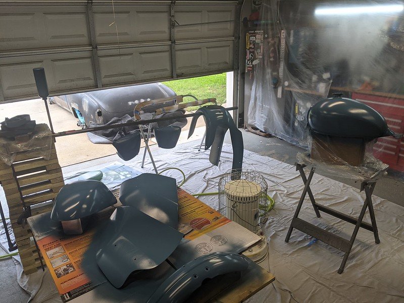

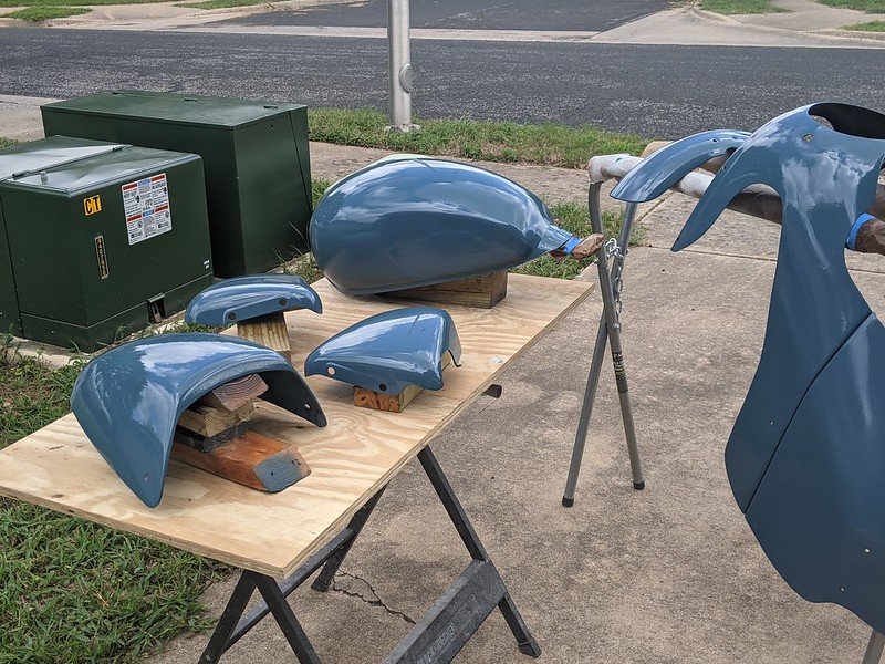

    As I mentioned before, I was about to put full fairings on my brothers bike and paint it. Here's how it turned out. All done in the garage in my makeshift booth using Tamco OEM color matched paint and their high impact clear. I honestly believe anyone can get good results with a little patience and some good preparation.
    Makeshift paint booth w/ kerosene heater to help curing. This was before the clear. LED lights don't photograph well. This looks darker than it is.
    Better lighting after the base coat.
    A little air/sun drying
    After a cut and buff and put back together.
    excorcist[OP] and JustAddMud like this.

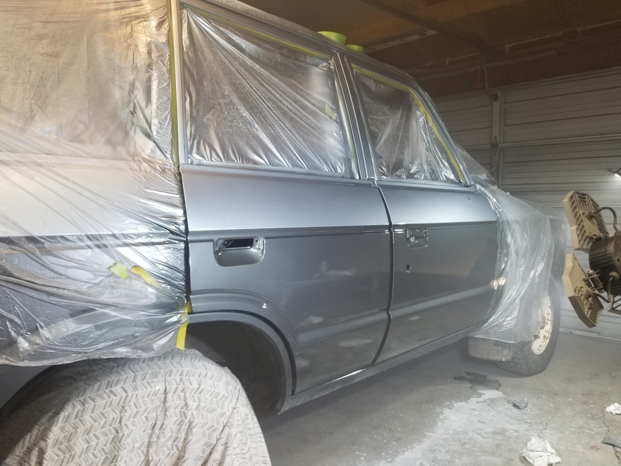

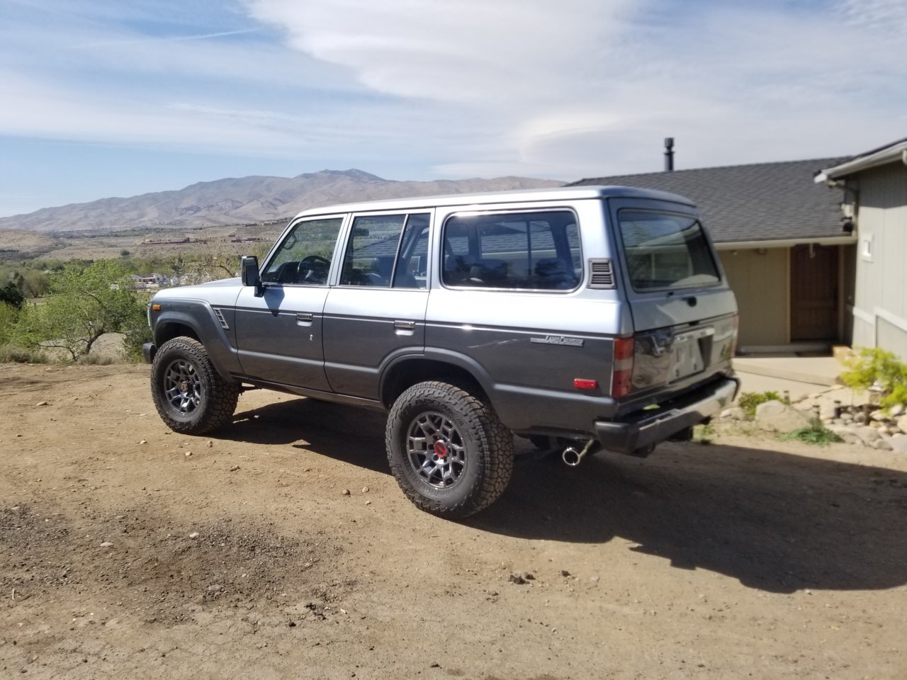

    Going to bump this thread realizing I never posted pictures of the land cruiser I painted. This probably took me ~ 3 weeks all in with disassembly rust repair, bodywork and finishing then reassembly... crazy how shooting the paint itself was like 1% of the time spent overall. It came out great though.
