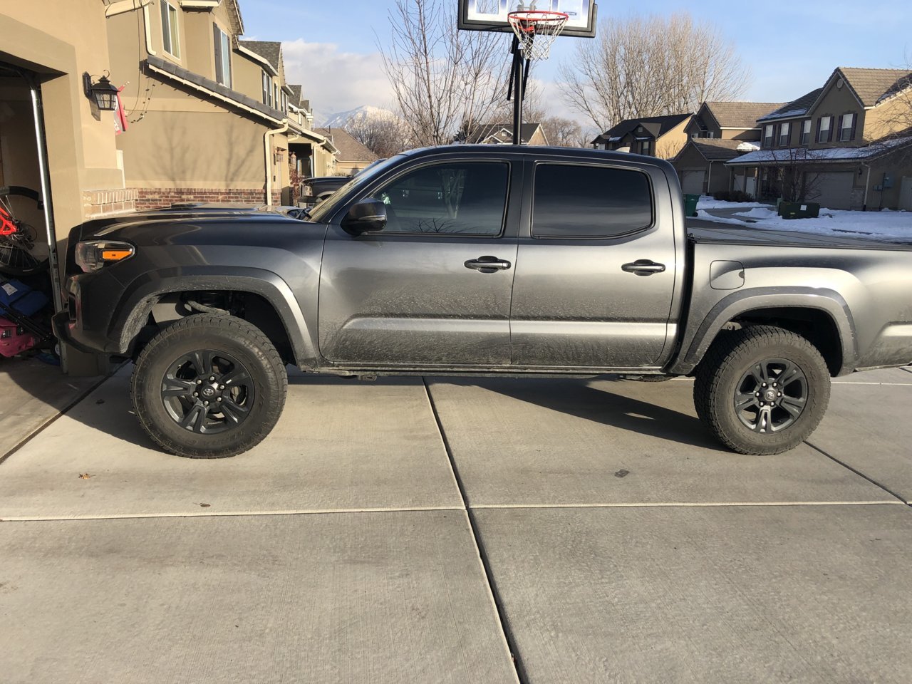

    Now that I've looked, it looks like I only went up one size... 265/70/17
    No lift.

  10. Jan 28, 2019 at 4:04 PM
    #30
    greg8765
    greg8765 Well-Known Member
    Sep 19, 2016
    #197683
    1,452
    Greg
    Utah
    2023 Tacoma TRD Off-Road
    Tuff Country Lift, Smart Cap, Tint, Pop & Lock, Door Sill Decals, Rooftop Tent
    rsimi72 likes this.

  13. Jan 28, 2019 at 6:07 PM
    #33
    greg8765
    Sep 19, 2016
    #197683
    1,452
    Greg
    Utah
    not bad. i think i'll go up one more size when i need to replace these.
