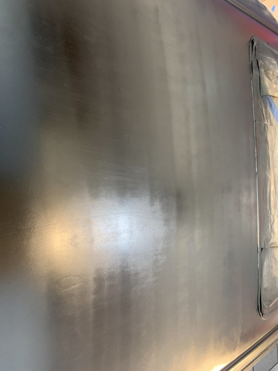

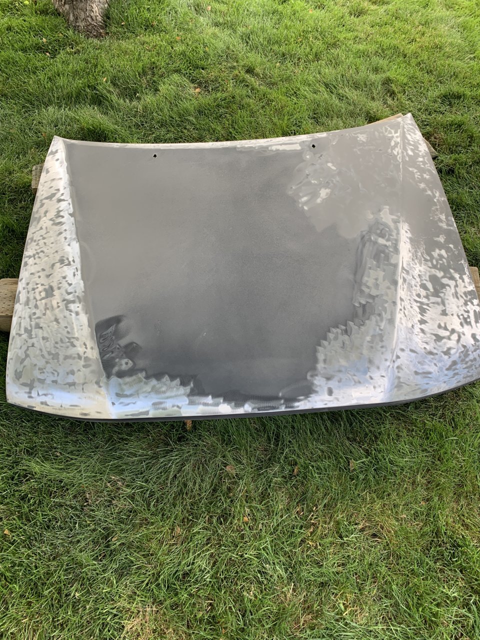

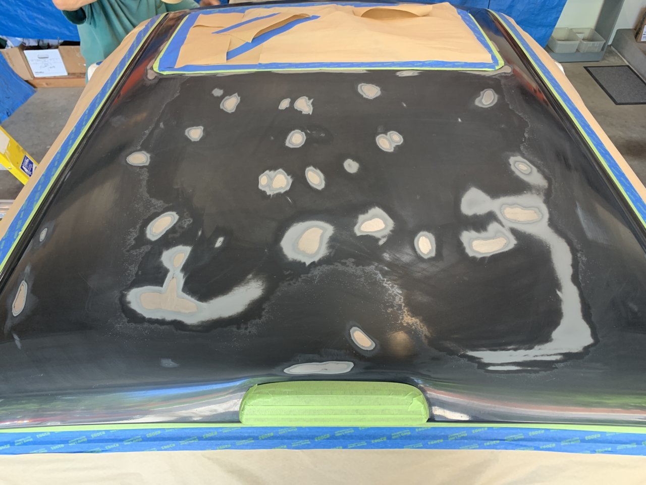

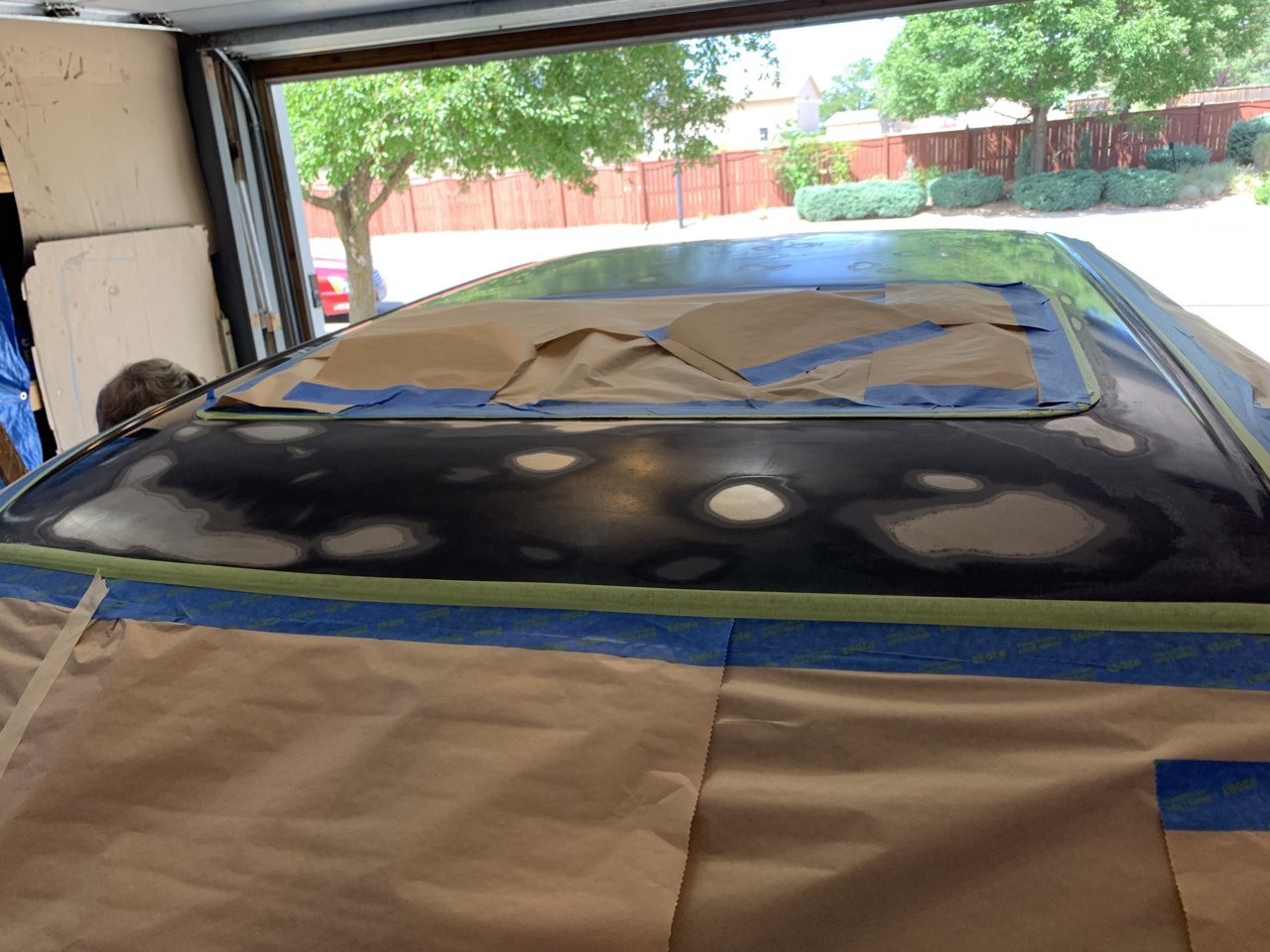

    Sanding:
    Sanded out the rust and scratches with 180-320 grit sand paper like they said, although my roof seemed to just turn into a continuous section of light rust so I stopped on the front. Parts where there was still paint, but clear coat was gone I feathered with 600 grit sandpaper until there was no seam. Paint was then scuffed with a grey scrub pad.
    Hood I used a grinder and a paint removing wheel and then sanded with 220 grit sand paper to try to smooth out the rough marks. (It didn't really work that great)
    Primer:

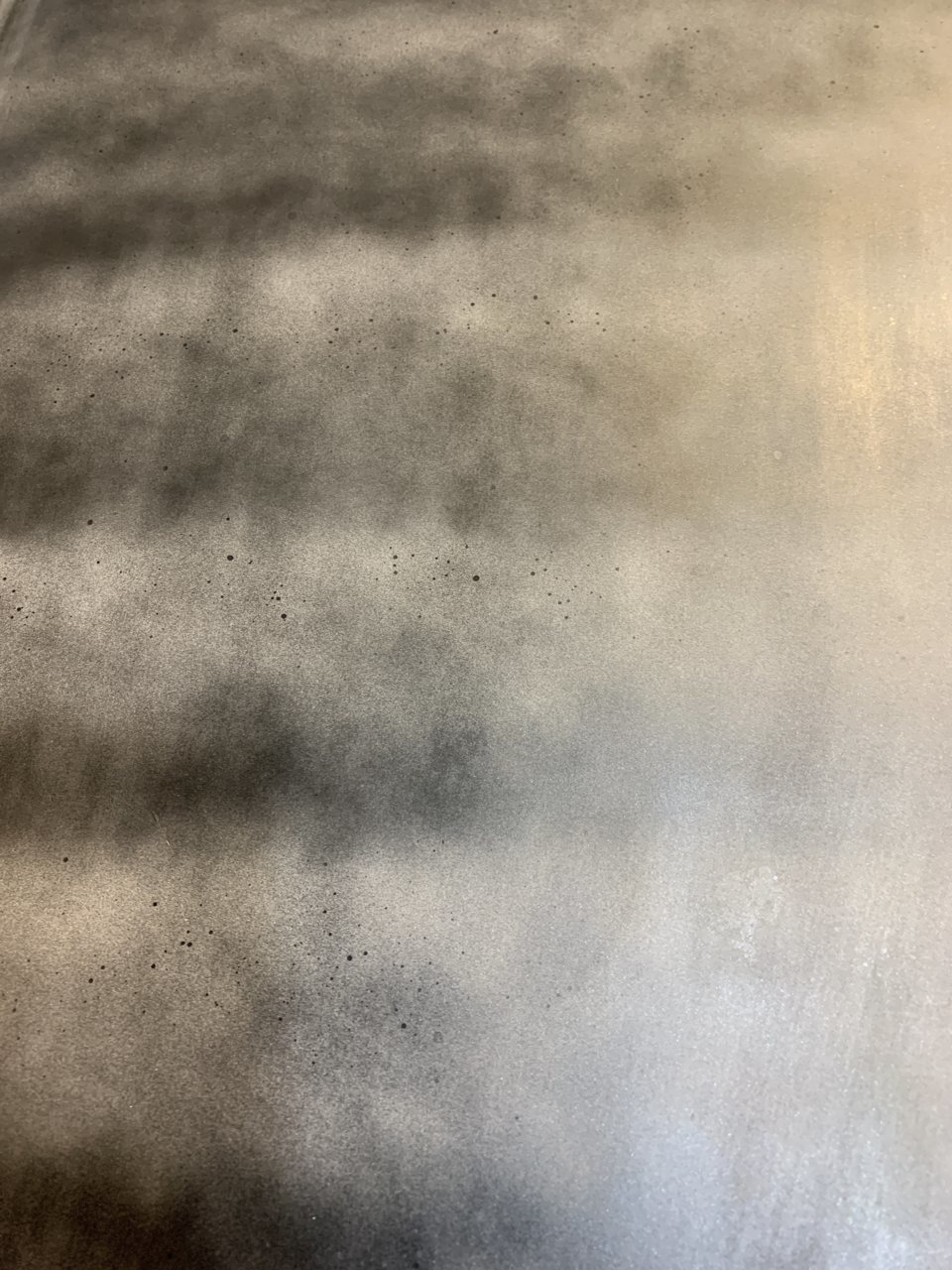

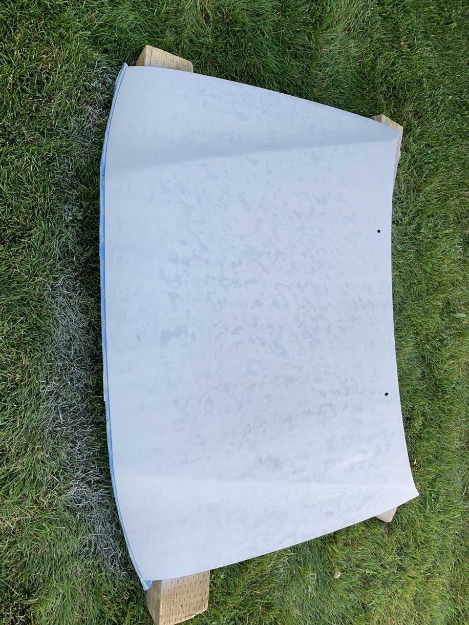

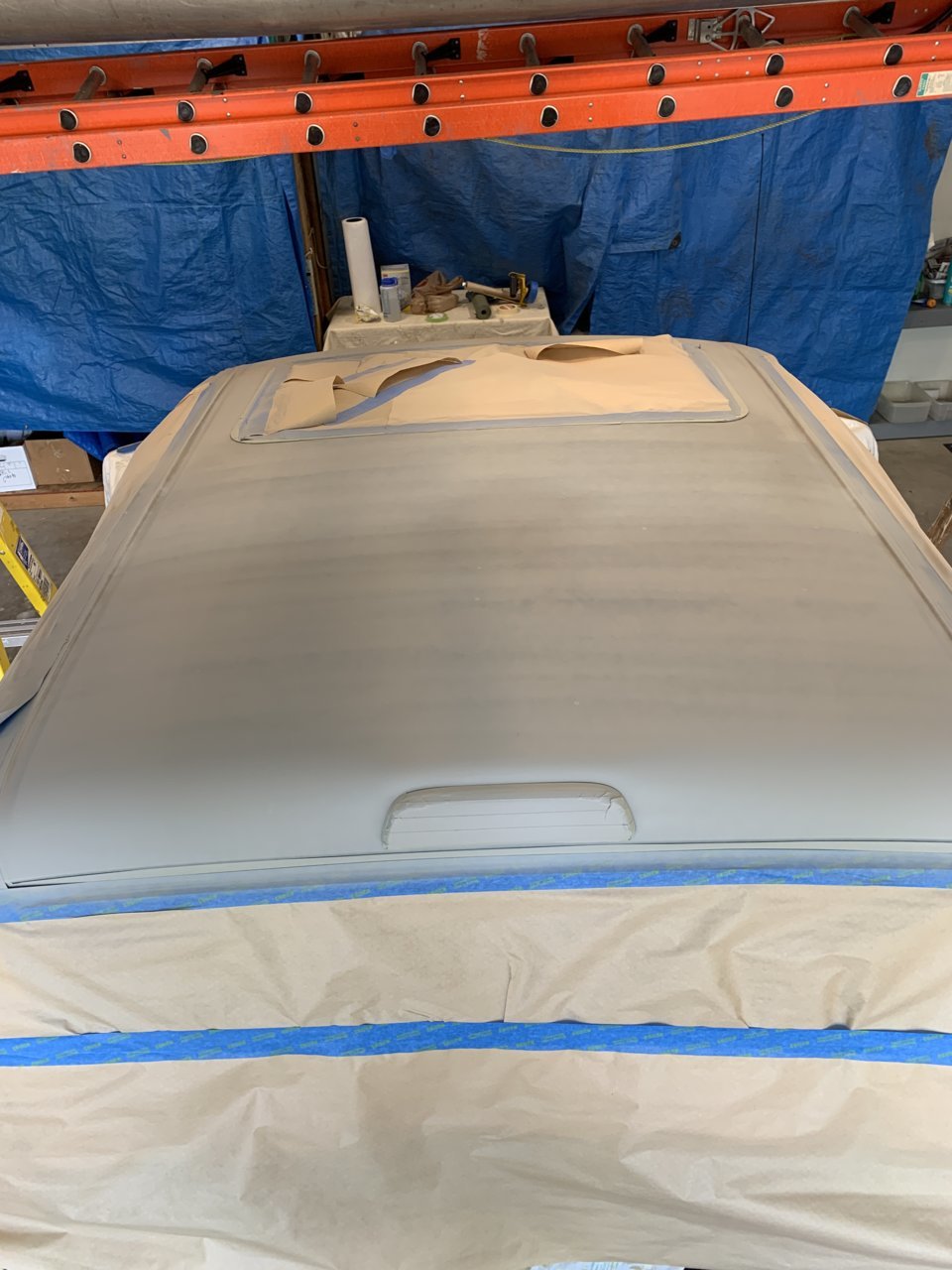

    Primer was put on the roof and hood with a total of 4 coats. Here is where the trouble started.

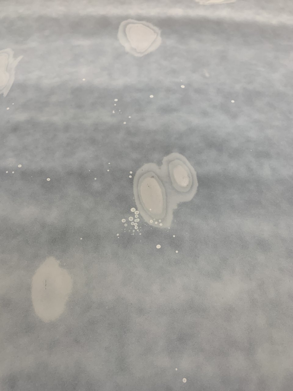

    Every can and I mean every can sprayed splatter and dropped blobs. This might happen on the very first pass. I eventually would stop every 3-4 passes and wipe the nozzles and shake the can. This still didn't help. It was random and unavoidable. There wasn't even a "good" nozzle that I could swap.
    We sanded the primer to remove the blobs and they were visible but felt smooth. Problem was in order to completely remove the blobs you basically took off all the primer and would have had to restart.

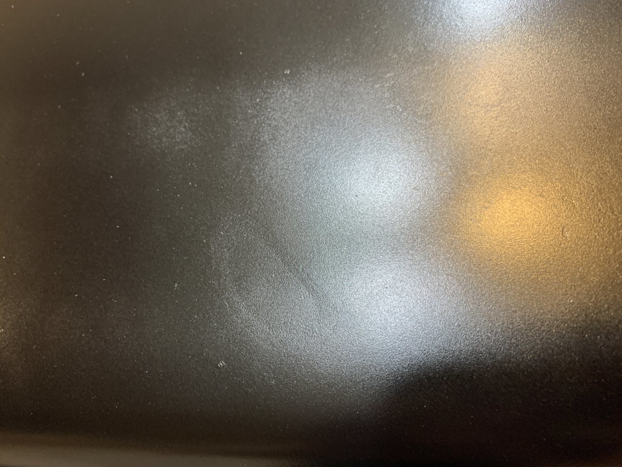

    Painting:

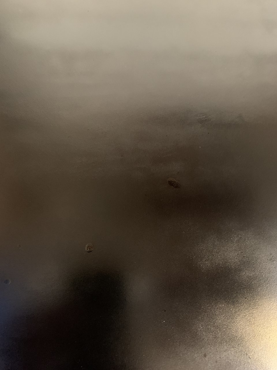

    Next day began painting. With my fingers crossed that maybe the paint wouldn't splatter since it was thinner I began painting. I kid you not the very first pass produced splatter and a huge drop on car. This continued throughout the process. Again, every can, no good nozzle.
    Now Automotive Touchup seems to know this is going to happen because they tell you to shake the can and clean the nozzle, but why would I have to clean the new nozzle, right?
    Also their instructions are in complete contradiction to each other. On the base coat can it says any imperfections may be sanded out between coats with 1000 grit or finer sandpaper. Perfect, I will just lightly sand out those splatter points. But wait, right below it in bold it says DO NOT SAND BETWEEN COATS!!. I guess I will follow that bold instructions and that we called a paint friend who said if you sand the paint before it is cured, not dried, but cured you can cause a whole bunch of problems. So no sanding.
    Additionally, and this might be inexperience in painting, but the spray seems to not be uniform in its coverage. It spray out in a vertical fan which is nice, but the end points of the fan are far heavier than the middle section. This causes a striping effect, even as you overlap. Some areas are dark, others not so much.

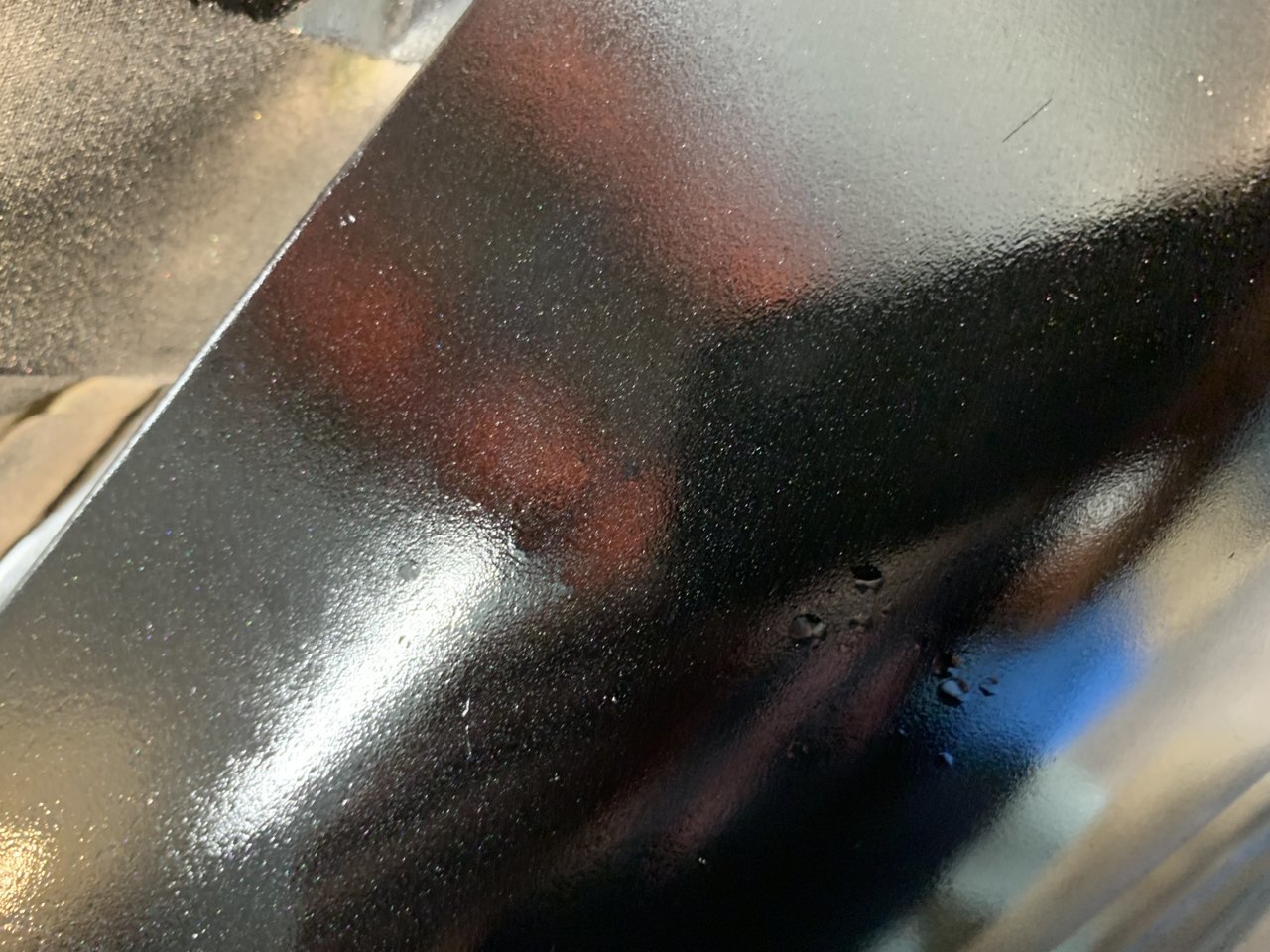

    Update: Clear coat did the same thing. Fantastic!!!

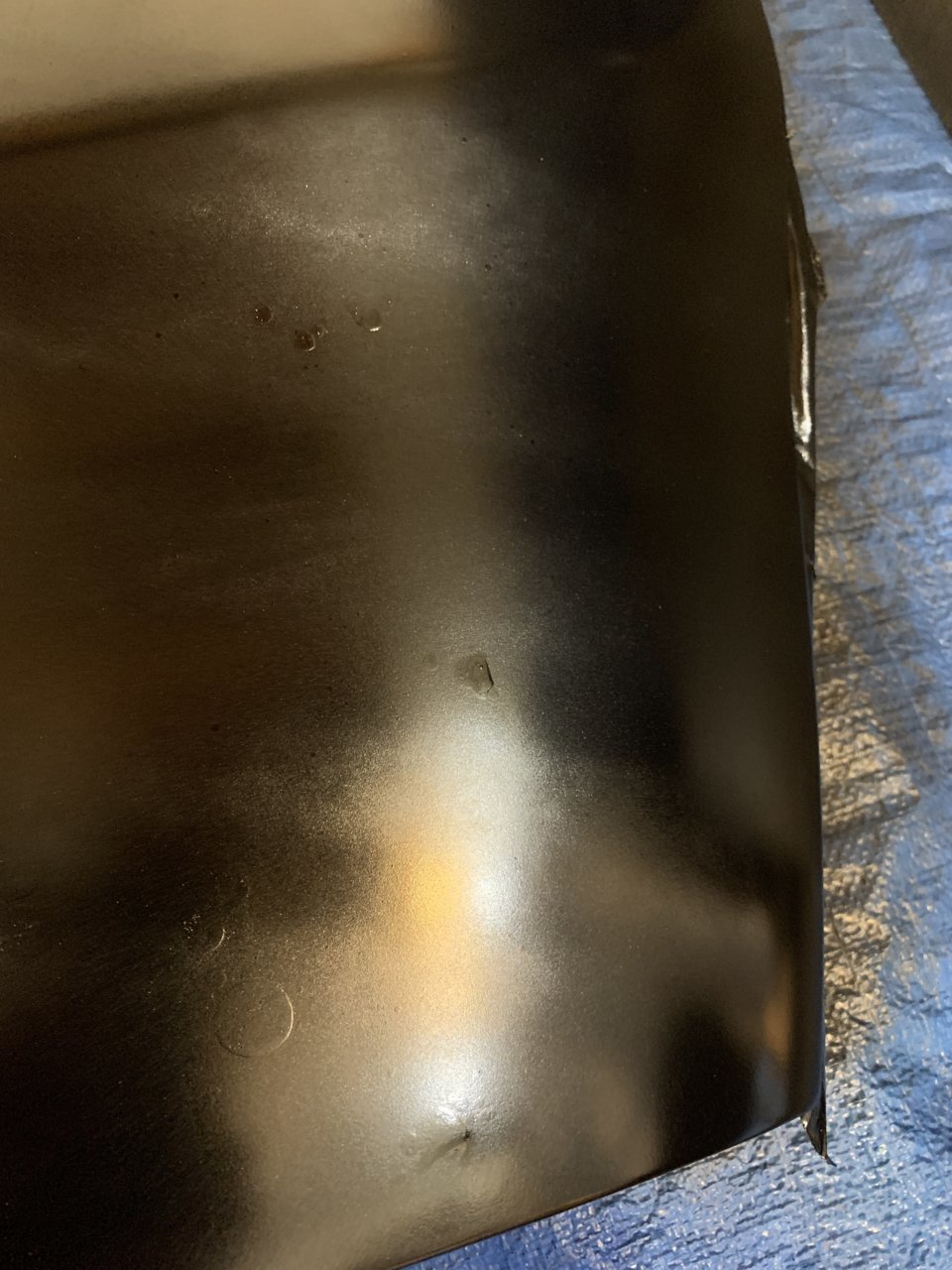

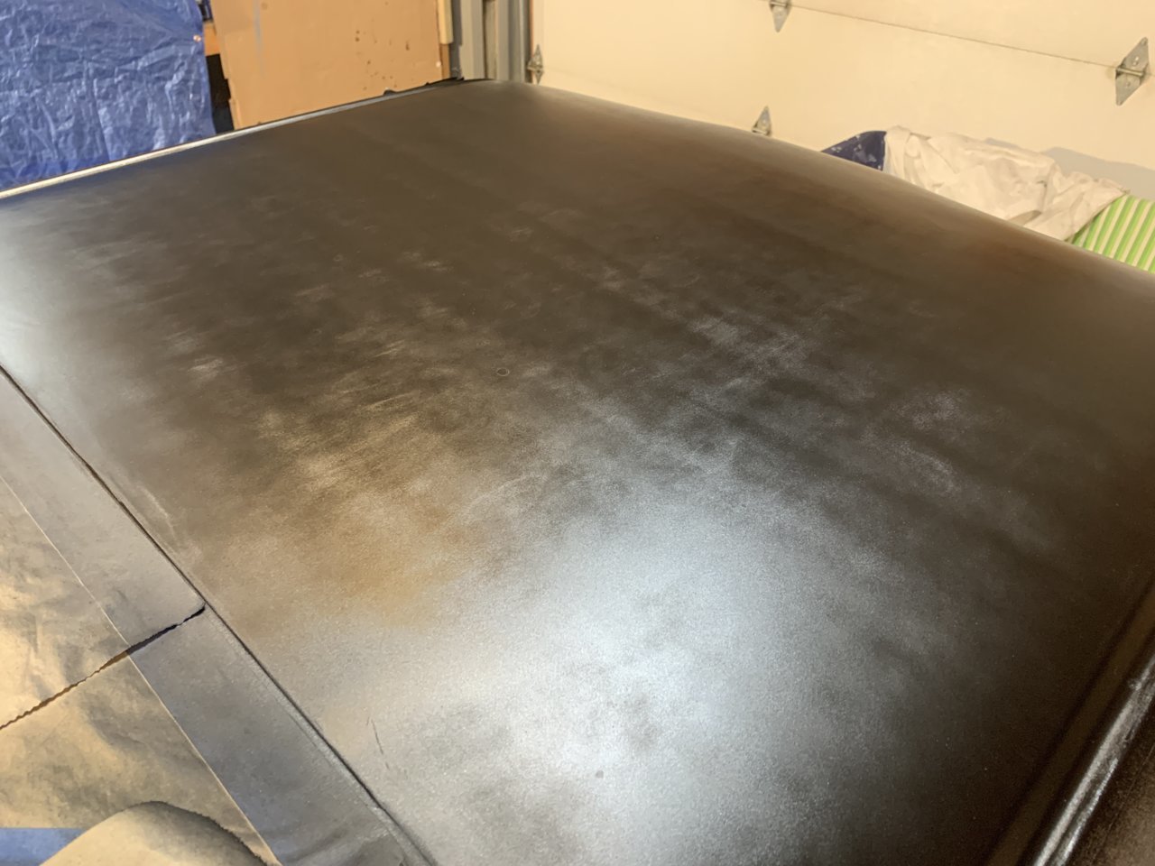

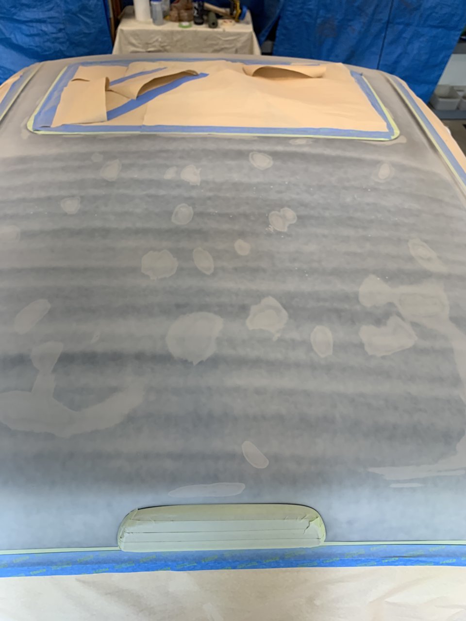

    You can see each stage's splatter with the last pic being the clear coat.
    Also notice that the primer didn't cover enough to smooth out the sanding which again was done in accordance to Automotive Touchup's instructions.
    Like I said I am sure that I suck at painting having never done it and I am sure that many mistakes were made, but the streaking and splatter/blobs were pretty much out of my control.

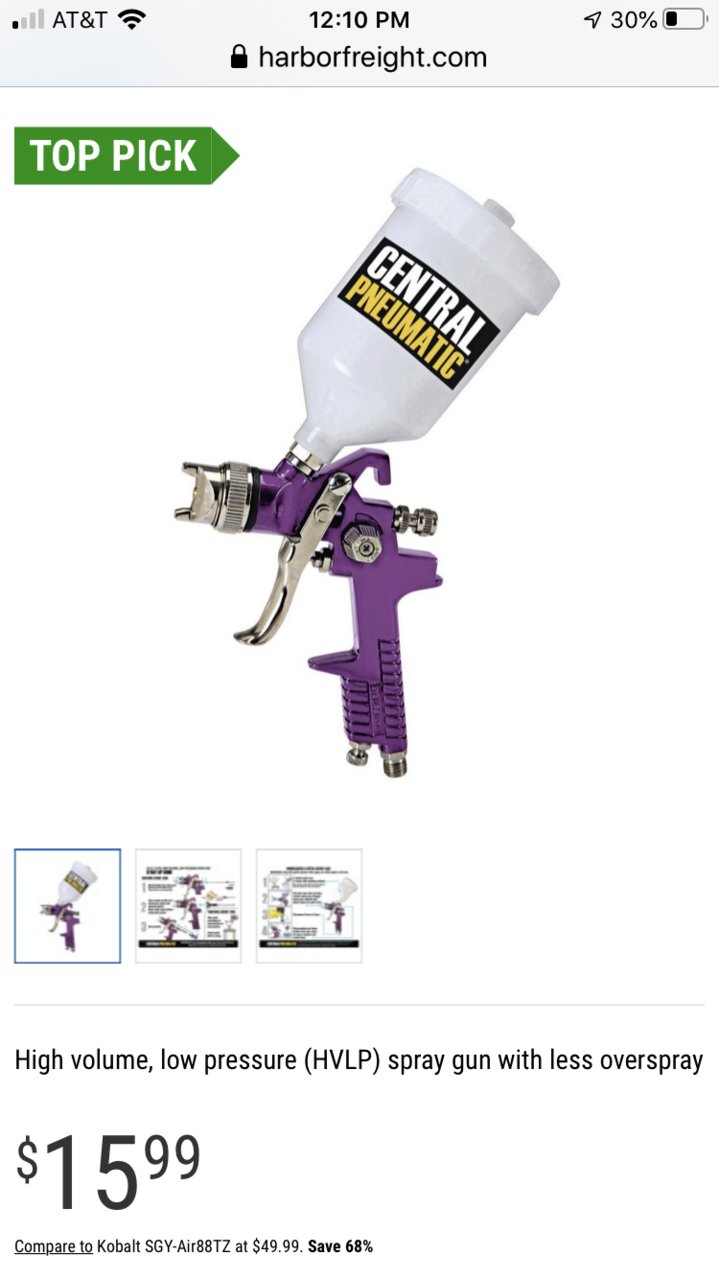

    occasionally on sale for $9.99

    I get that there are better ways to paint. Maybe I should buy an electrostatic sprayer while I am at it. I am just giving feedback on the rattle can method that supposedly has great results.
    Also I don't know how efficient a spray gun is and how much paint you need but a gallon is $375 and quarts are $100. just for the base coat.
