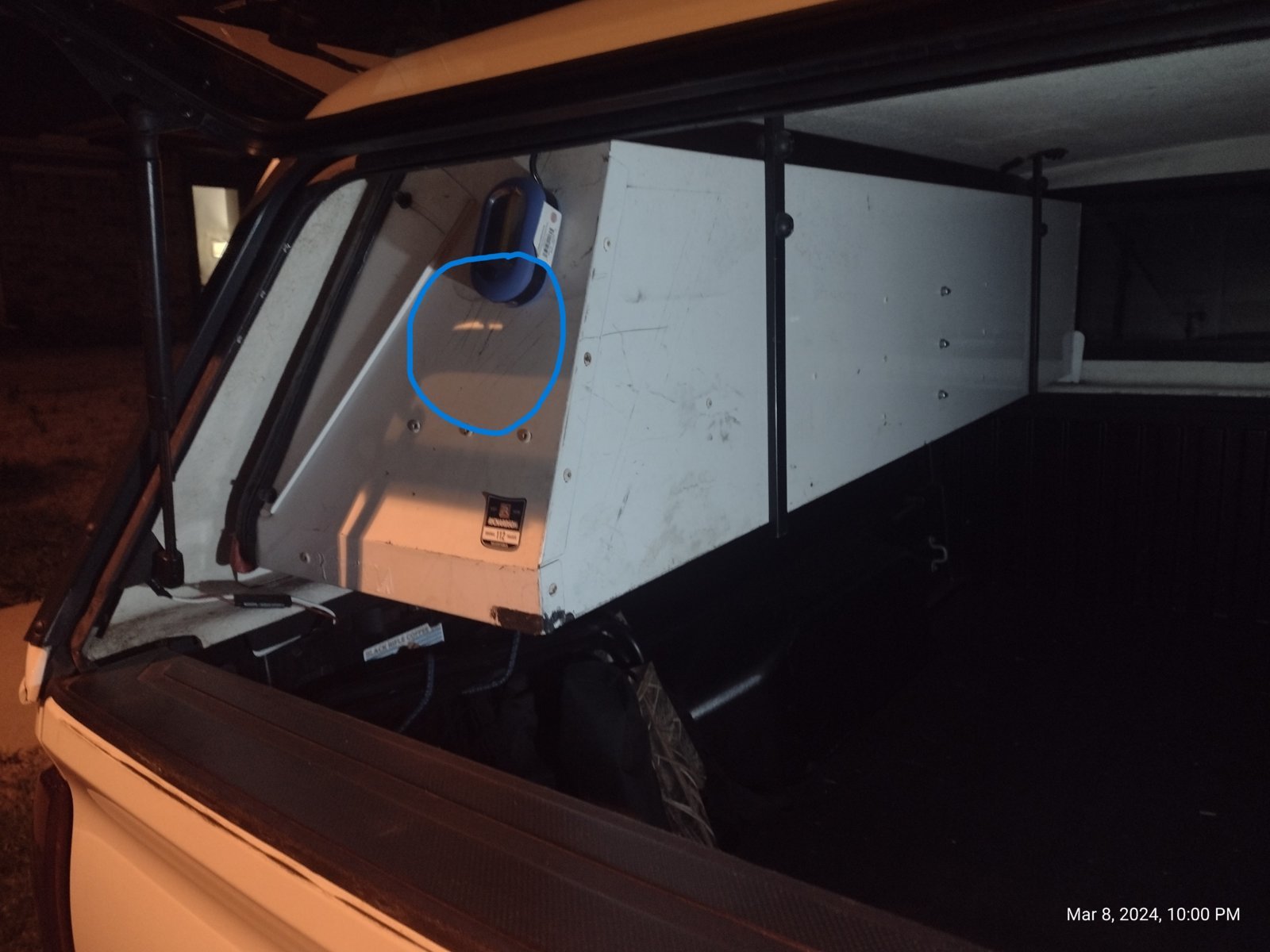

    This is where I plan to mount the auxiliary battery.

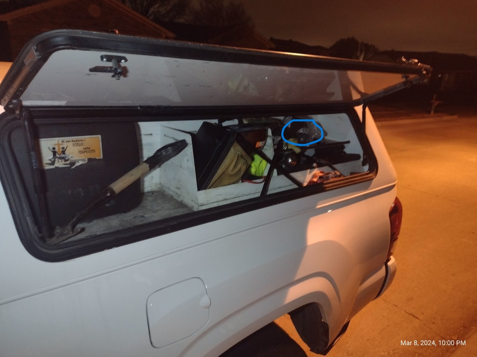

    This is where I plan to mount the switch panel.

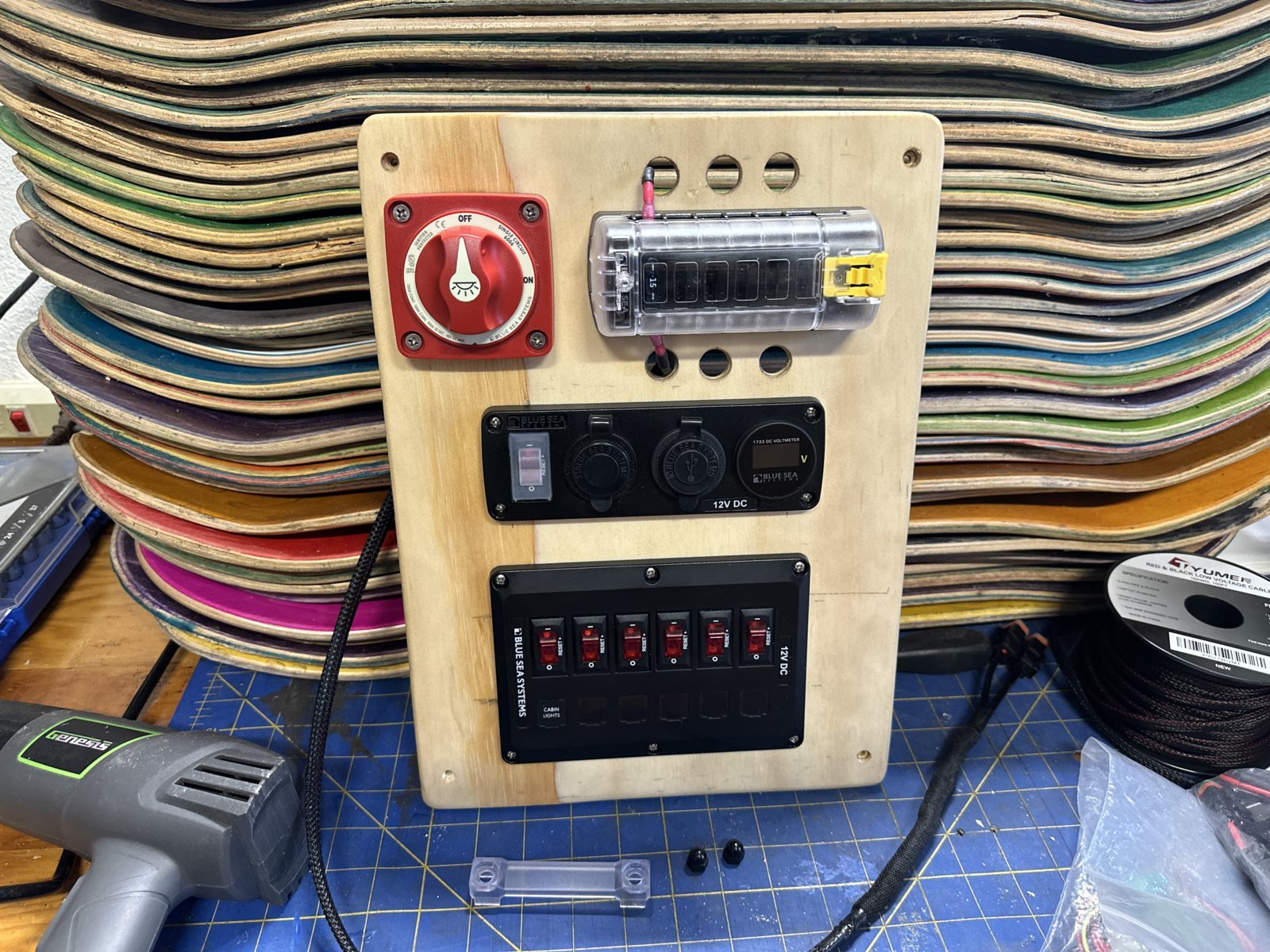

    Huh… that’s interesting . You have a 2020 access cab right ? On lower left switch panel of the steering wheel…. What do you have for switches . I have. 2020 sr5 and the switch is there . You have to pop the blank covers off in bed and there is already wires for the bed lights . It’s just covers with a little blank plug thingy.
    If you are running wires for lights and extra accessories, make sure you draw up a basic idea of what you what/need so you can plan ahead . Or at least when you build your little electrical
    Area you have ways to add in things later . try to keep everything in one location so any electrical work can be done from one spot . I just finished building a panel
    For my alucab set up.
    It’s fed from a breaker and fuse in the engine bay, and has a hard shut off for the canopy power

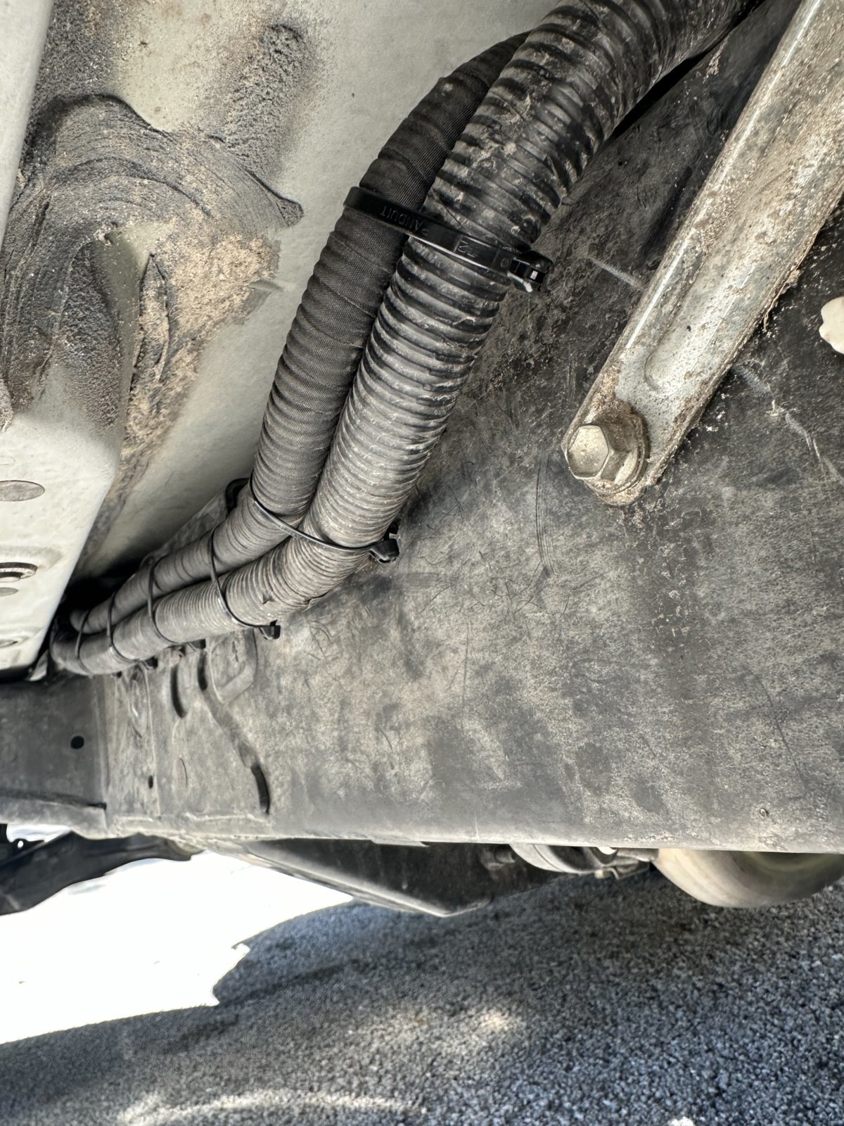

    i’d use a 30amp fuse for 10awg isolator wiring.. plus when are you going to ever use 50amps? lol that’s overkill for charging a small 40ah pack or powering some lights. Keep in mind with distance you get voltage drop and higher amperage. You measure distance of wire runs power and return, so positive and negative. I have a 2awg although overkill on the wiring I wanted to be sure i have full 30amp charging for house battery plus another 30 amps for air comp and whatever 12v accessories i may want to run off that line. If anything go overkill on wire and smaller fuses that way the wire doesn’t become the fuse.IMG_6987.jpg
