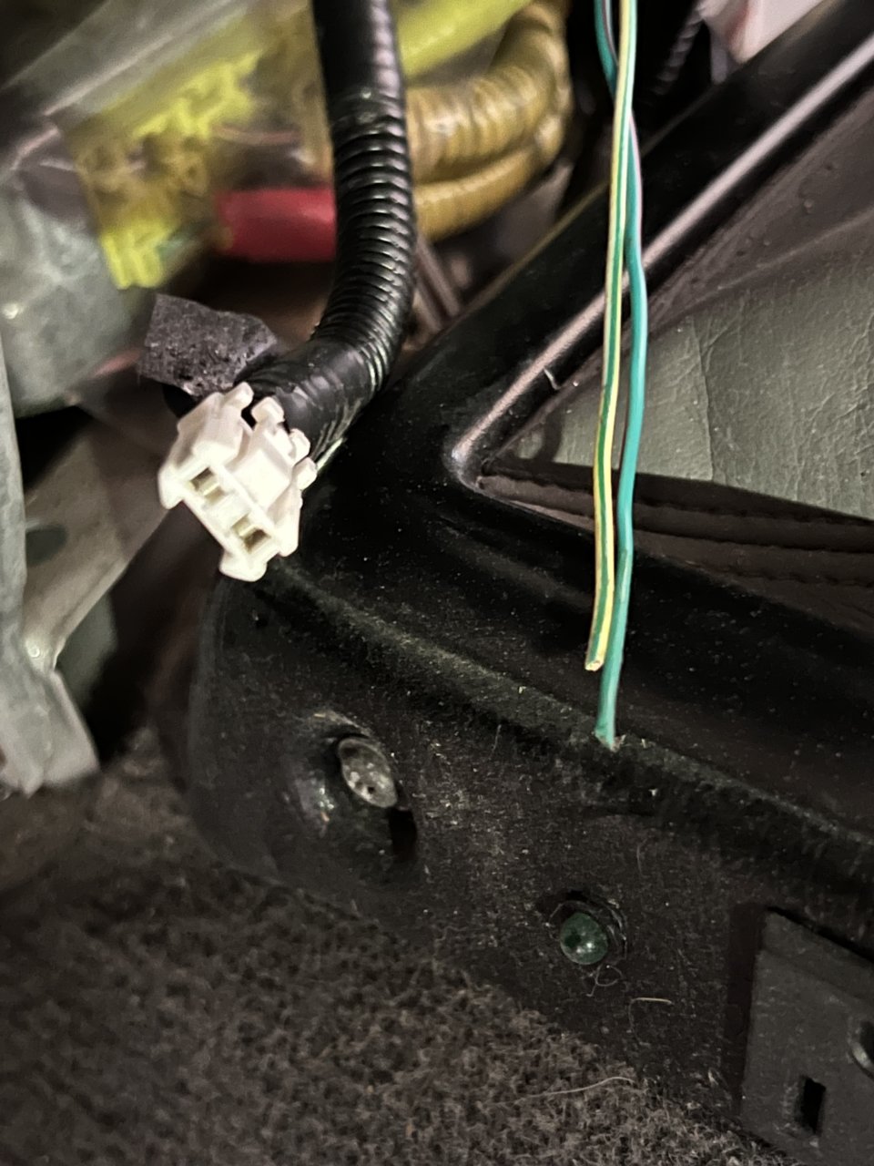

    Good evening, taco lovers! I recently purchased a 2004 Taco and noticed the owner before me jacked up the wiring to the aux. power outlets. I've scoured the Internet but haven't had any luck find the part number for the connector (or harness) that plugs into each outlet. I'm hoping someone on this forum is able to help me out. I attached a photo of the current wiring debacle. Thanks in advance for your help.

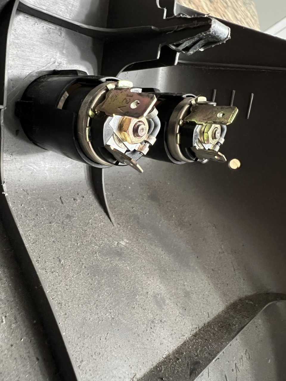

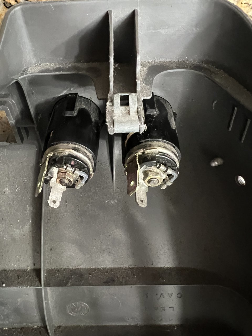

    I need to look up in my connector part # book. power outlet Toyota #90980-10760 this will be the plastic female connector you will still need the pins
    Unless someone posts the part number before.
    Make your own using female insulated spade connectors if your in a hurry.

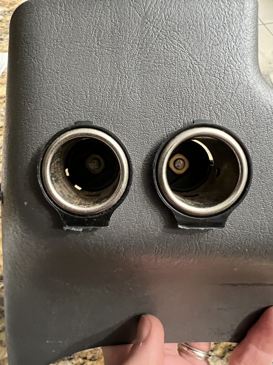

    Here are some photos of the outlets. Let me know if a different angle is helpful. Thanks again!

    Those is the Correct part # I posted.
    1/4" insulated spade terminals also will work great.
