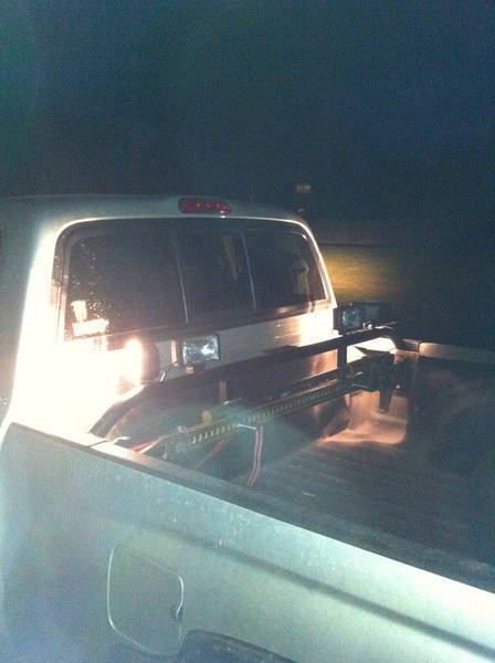

    Seems like it's OK. I wired some cheapie 55w aftermarket "burners" from walmart to my back w/o problem. Grounded them to the trailer hitch frame mount. Screwed them in onto pre=existing holes. Wired the on/off via a relay to the power in my reverse lights (popped off the taillight cover, there's just enough room to squeeze a relay and splice in to the hot wire), and ran a wire from my battery back along the frame into that taillight. Took maybe an hour.
